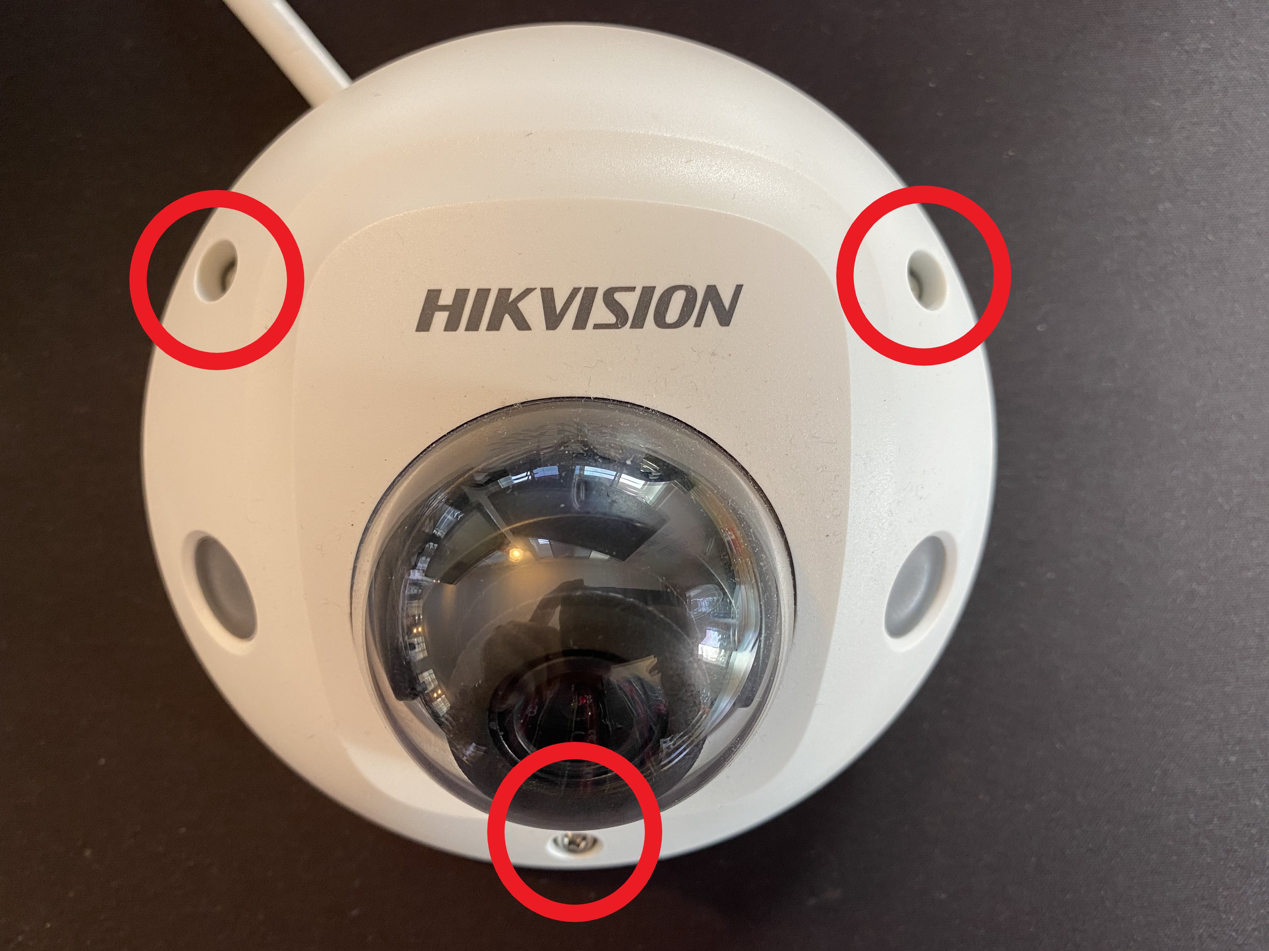

- Remove the mini dome's cover by loosening the screws surrounding the glass dome, shown in the image below:

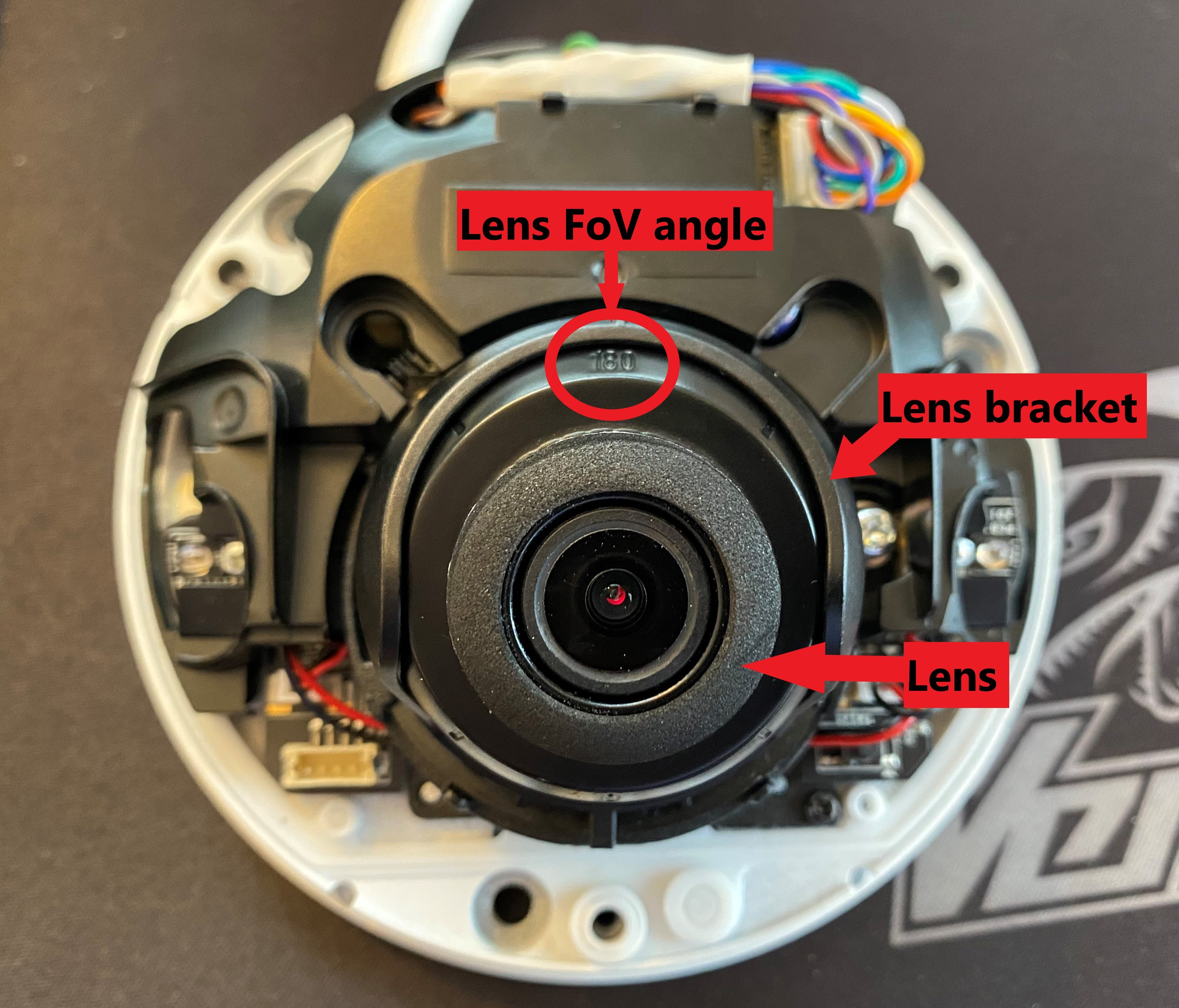

- You should now be seeing something like the image below. Loosen the locking screw to the right of the lens, and then the lens bracket which locks the orientation of the lens in place. The lens is effectively attached to the camera body via a ball and socket joint, so this can be orientated however you like.
Part 2 of this guide explains rotating the lens in more detail, as well as how to rotate the lens on the turret and bullet styles of camera - How-to: How do I set up Corridor Mode on my Hikvision Turret, Bullet or Mini Dome IP CCTV camera?
NB - This image shows a camera with the lens rotated 180°, you'll actually need this 90° marker to be in the 3 o'clock position, and the 180° marker pointing towards the bottom of the unit.

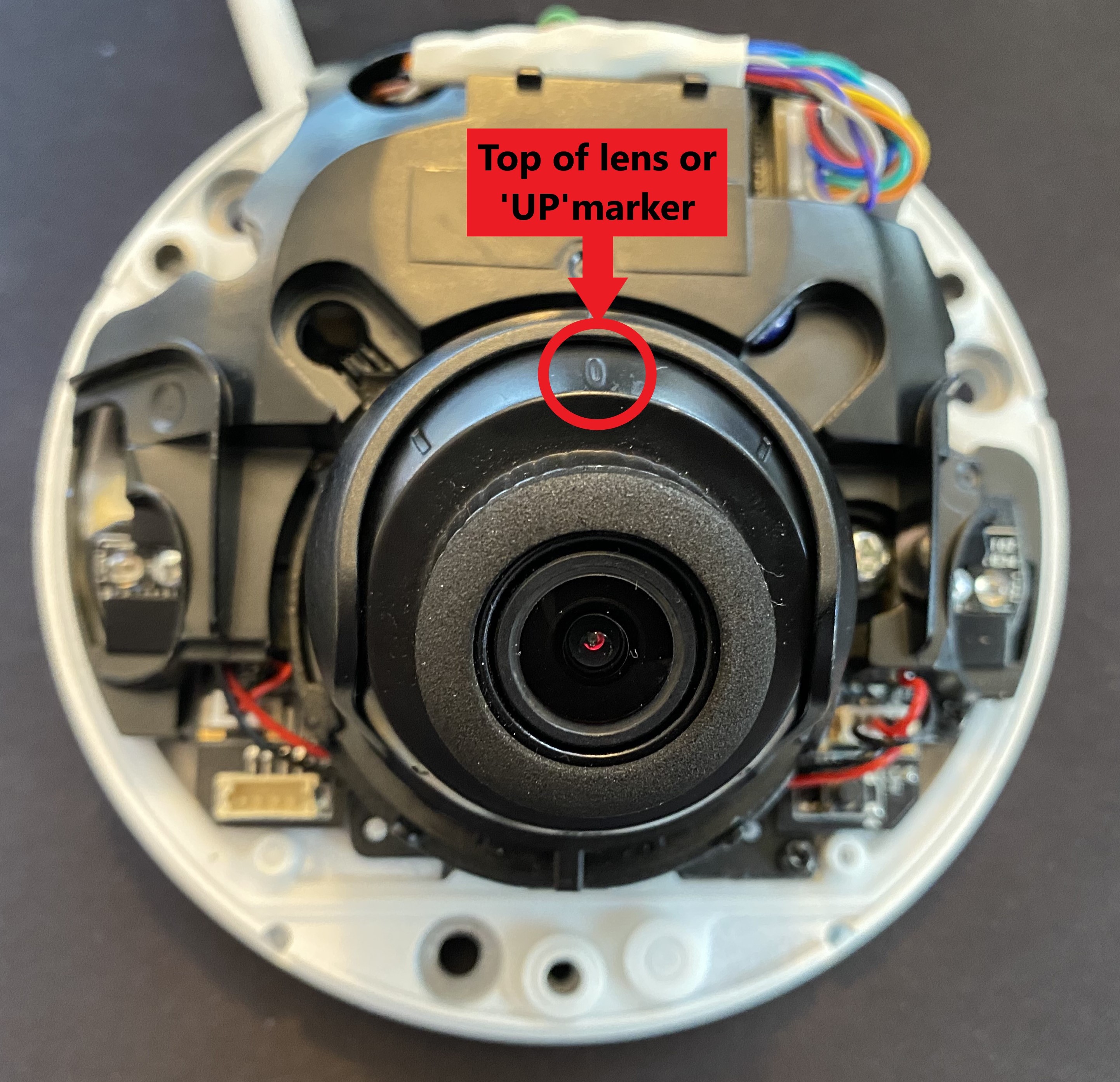

- The lens should be positioned like the one shown in the below image. The small line marker located directly parallel to the 180° marker signifies the top of the lens. So, this needs to be pointing up, towards the top of your scene. This will orientate the camera's view correctly. You should also make sure that the lens bracket is repositioned correctly so that the thicker part surrounds the top half of the lens.
- Now, tighten the locking screws and fasten the dome cover back in place, making sure the cover screws are tight to prevent water ingress into the camera. It's always worth checking your camera stream before doing this to make sure that the camera view is orientated as you like.

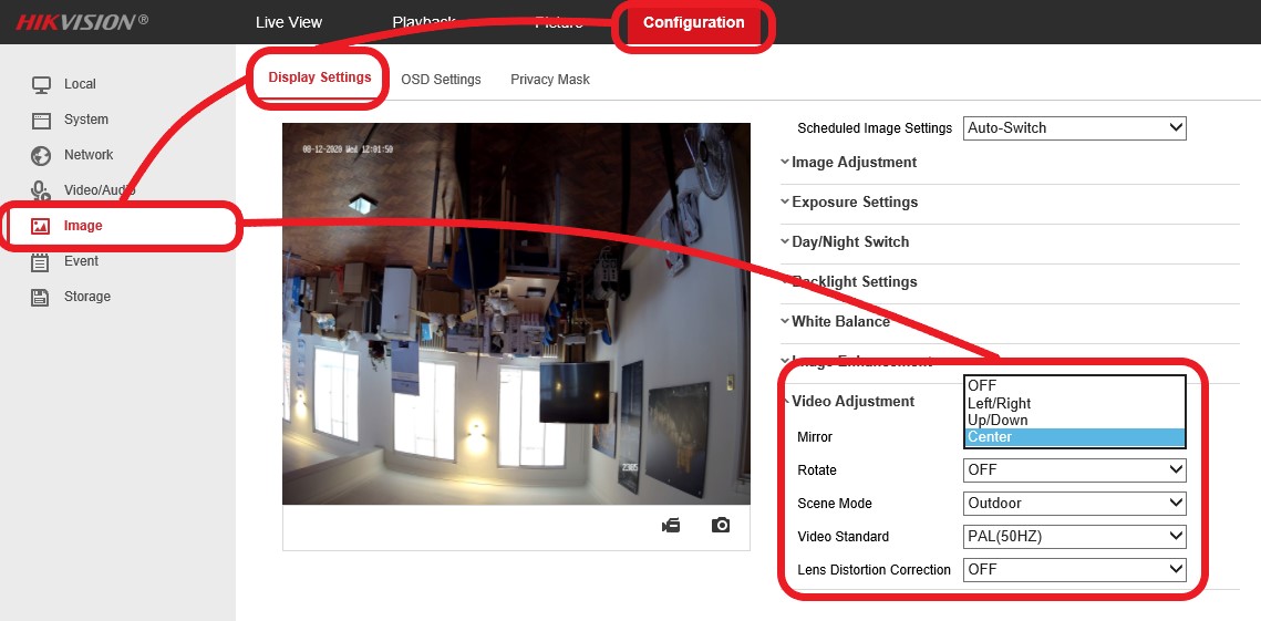

- When you have access to the cameras in a web browser, go to:
Configuration > Image > DIsplay Settings > Video Adjustment
The different options are will adjust your image as described below:
Left/Right: The image will be flipped horizontally, so it appears as a typical mirrored image.
Up/Down: The image will be flipped vertically, which will still show a mirrored image of the default view as you are not actually 'rotating' the image 180°
Center: This will be the option that you need to select to rotate the image 180°, which will show the same view as physically rotating the lens would.

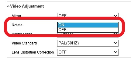

If you only need to rotate the image 90°, then setting the Rotate option to ON will do this, as shown below.
To rotate your view 270°, set the Mirror dropdown to Center, and then set Rotate to ON.
