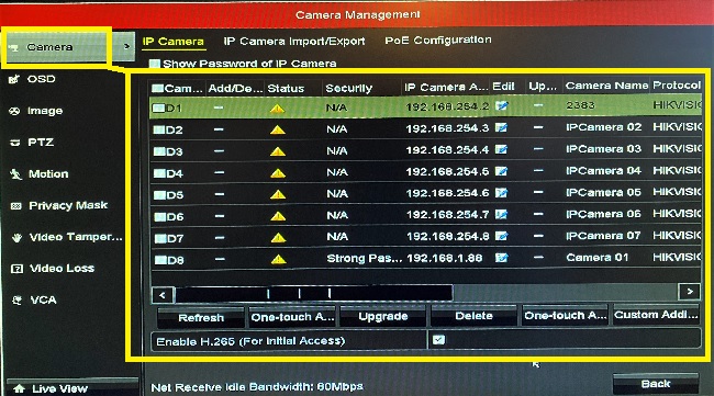

Menu > Camera
Ensure all your cameras are properly connected to the NVR and are visible on this screen. If you haven’t yet added any cameras to your NVR, this guide on adding Hikvision cameras to an NVR walks you through how to do so.

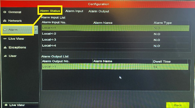

Menu > Configuration > Alarm
This should take you to the Alarm Status menu. This menu lists the status all your alarm IN/OUT ports and any alarms that have been configured/assigned to these ports.
You’ll need to use this screen to check that you’ve set the correct Alarm Type for the alarm/device that you’re connecting. The options you have are N.O (Normally open) and N.C (Normally Closed). In brief, N.O alarm types use switches/sensors that normally remain open with no current flowing through them, so closing the switch allows for the flow of current and activates the alarm. N.C alarm types, on the other hand, use switches/sensors the normally remain closed with current flowing through them, so opening the switch stops the flow of current and activates the alarm. There’s a lot to be said about N.O and N.C alarms but for now, you only need to know which category the alarm that you’re using falls under. If you want to take a journey down the N.O vs N.C rabbit-hole, I found this article on the differences between N.O vs N.C useful.

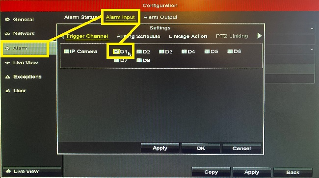

Alarm > Alarm Input > Settings (click on the small cog) > Trigger Channel
Choose the channel that you would like to trigger your alarm. In this case, we’ve selected channel 1.

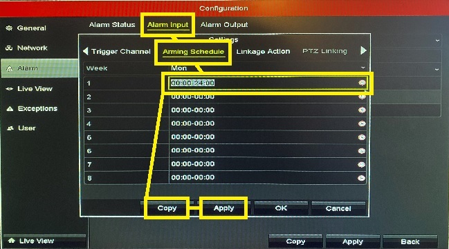

Settings > Arming Schedule
Select the hours that you would like to schedule your alarm to be turned on for. Typically, this would be 24/7, so set the schedule for Monday, Week 1 as 00:00-24:00. Now, copy this schedule to the rest of the week by clicking Copy and then checking the box for All in the popup window. If you only want your alarm scheduled for certain days, then select the specified days in this popup from the list of 1-7 (1 = Monday, 2 = Tuesday etc).Once you’ve done this, click Apply.

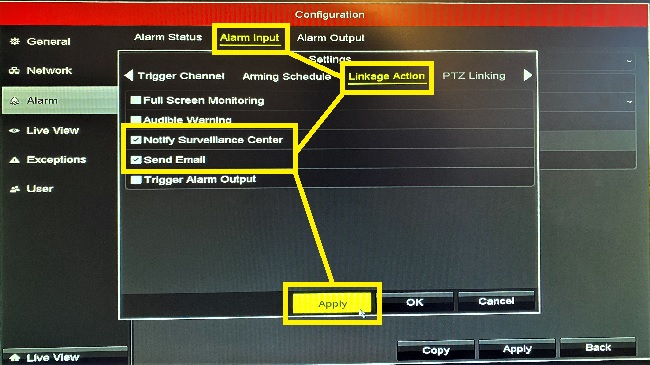

Finally, navigate to:
Settings > Linkage Action
Tick the boxes for Notify Surveillance Center and Send Email and then click Apply so that you email notifications whenever the alarm is triggered. If you have connected a separate device to be activated by the alarm in the NVR's Alarm OUT port, then ticking the box for Trigger Alarm Output will activate this device when your alarm is triggered.
That’s it for the local setup section of this tutorial! Your NVR’s alarm function should now be set correctly.

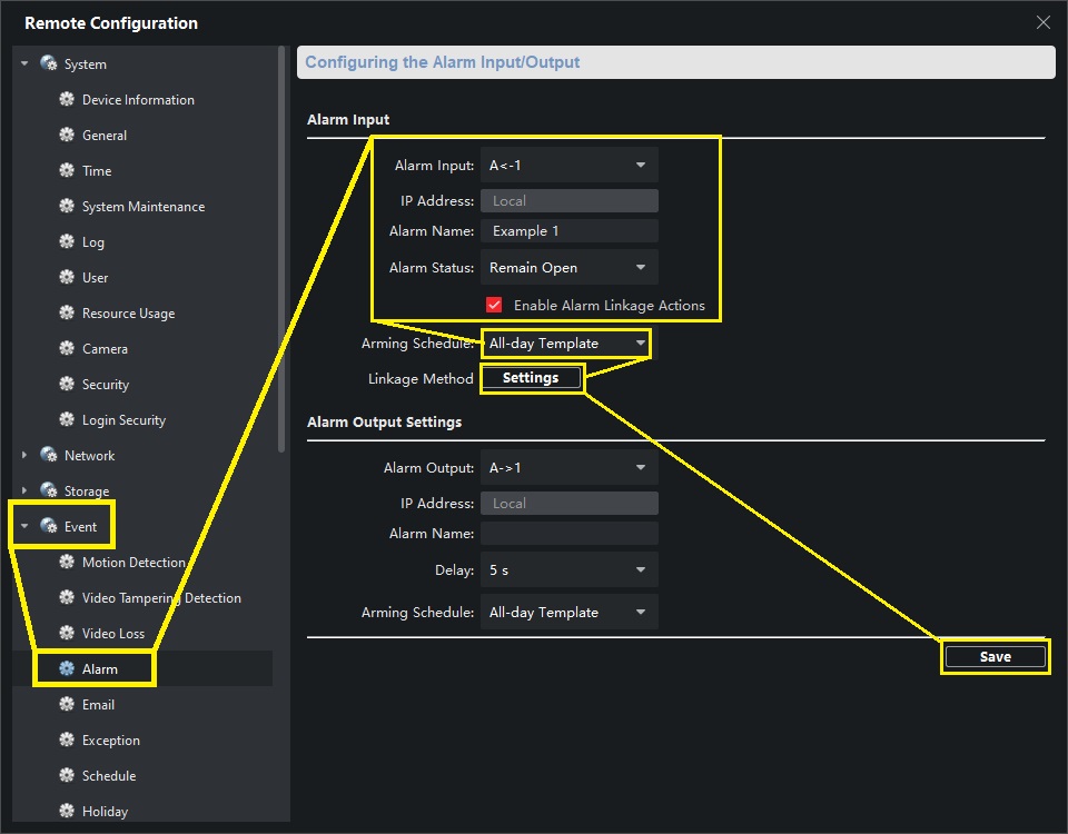

Part 3: How do I configure the alarm function settings of my NVR remotely via iVMS-4200?
The first thing you’ll need to do is ensure you have the most up to date version IVMS-4200 installed and that you’re able to view the live feed of your camera(s) through the software.

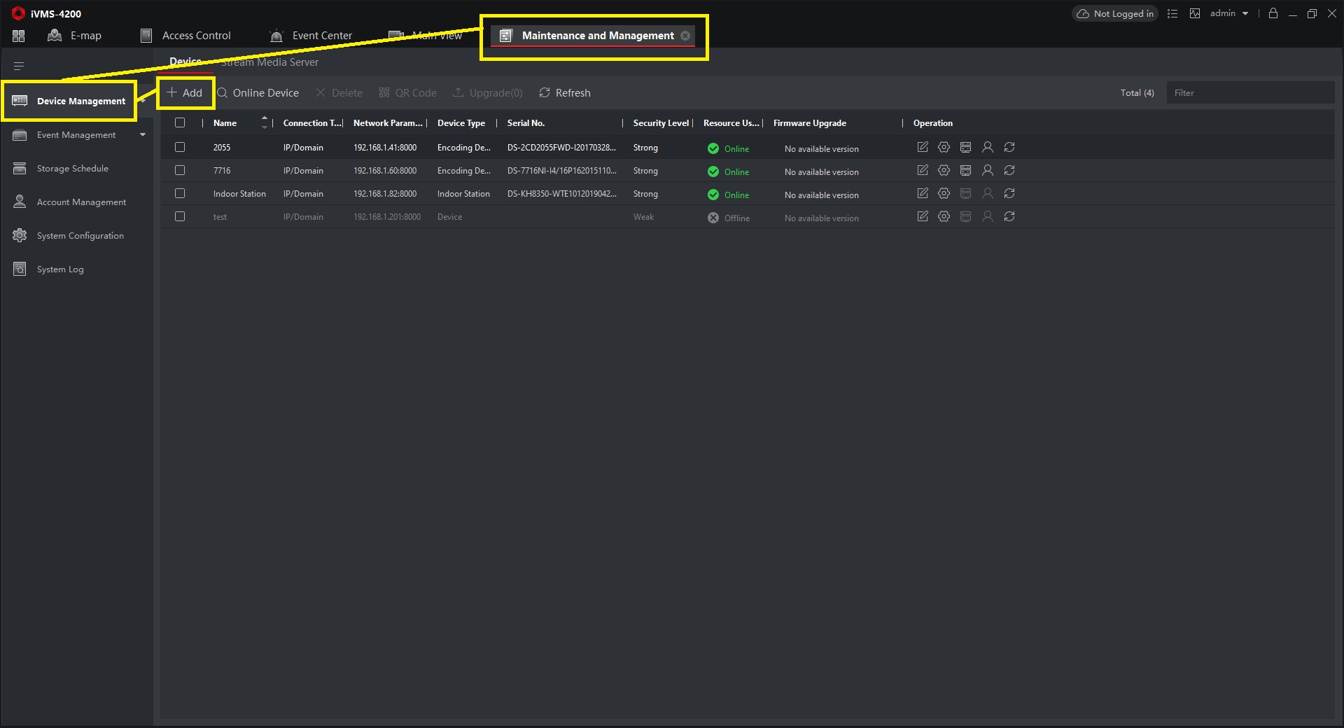

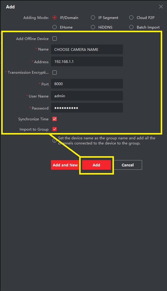

If you haven’t already added your NVR to the program, navigate to:
Maintenance and Management > Device Management > Add
Add your NVR here by filling out the fields in the popup window, ensure the boxes beside Export To Group and Synchronise Time is checked and then click Add.

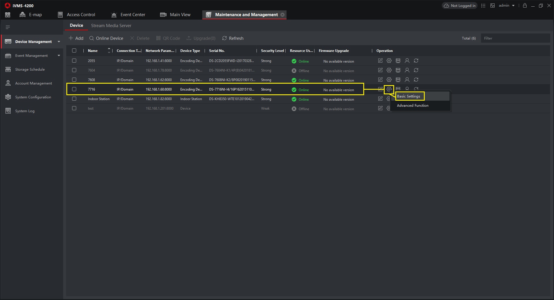

Now find the NVR on your device list and select:
Remote Configuration (the small cog listed beside your NVR) > [Basic Settings] > Event > Alarm
NB the configuration menu layout you will see henceforth will vary between two depending on the model of NVR that you have. I have included both variations for each step, so don’t worry if some of the below screenshots look unfamiliar.
Fill out the alarm parameters here, e.g. as follows:
Alarm Input: Select your NVR’s channel that you would like to trigger your alarm (e.g.: A<-1)
IP Address: Local
Alarm Name: Name your alarm as desired
Alarm Status: Normal/Remain Open or Normal/Remain Closed depending on the type of alarm, see the first half of this tutorial to understand the differences
Enable Alarm Input Handling/Enable Alarm Linkage Actions: Check this box
Arming Schedule: All-day Template

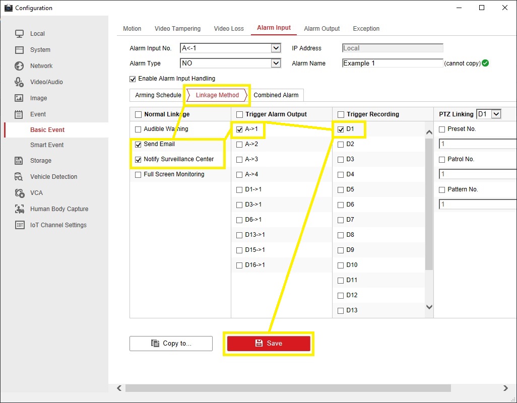

Open Arming Schedule, pick an arming template or a custom schedule of hours that you want your alarm active for.

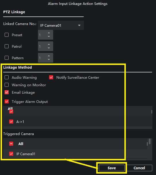

Now, Click Settings beside Linkage Method. Check the boxes for Notify Surveillance Centre, Email linkage and Trigger Alarm Output (if you’re connecting an external alarm device to an output channel), then set the desired Triggered Camera.
Click Save, and then Save again in the alarm configuration window.

Menu > Camera
IP Address: Local
