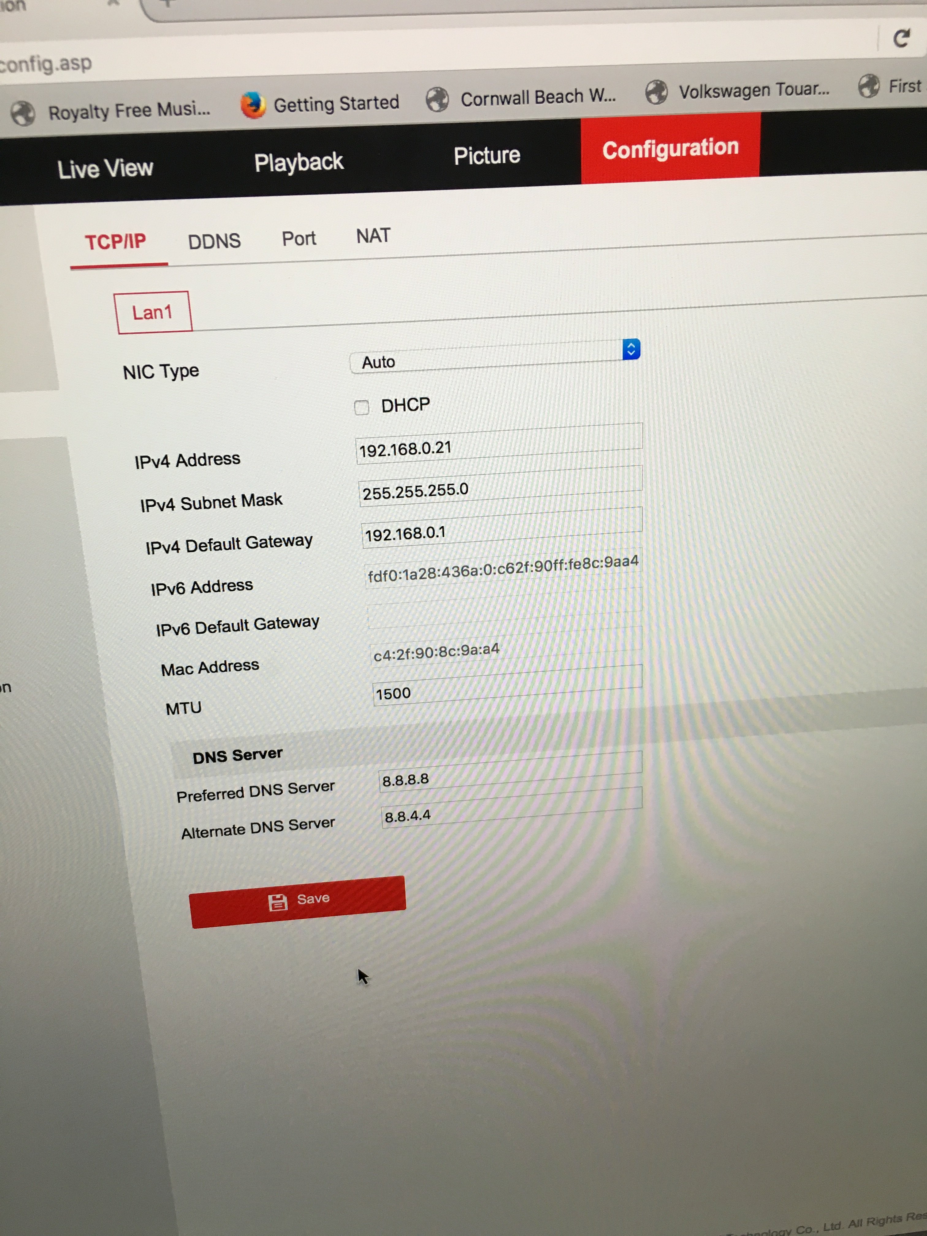

First of all, login to your Hikvision camera via a web browser using its LAN IP and navigate to Configuration > Advanced Configuration > Network > TCP/IP tab. Ensure that you have set a correct Preferred DNS Server. Failure to do so will mean that EZVIZ will not work correctly. We like to recommend Google's DNS server of 8.8.8.8
There's no harm in adding Google's secondary DNS server 8.8.4.4 in the Alternate field below, too.

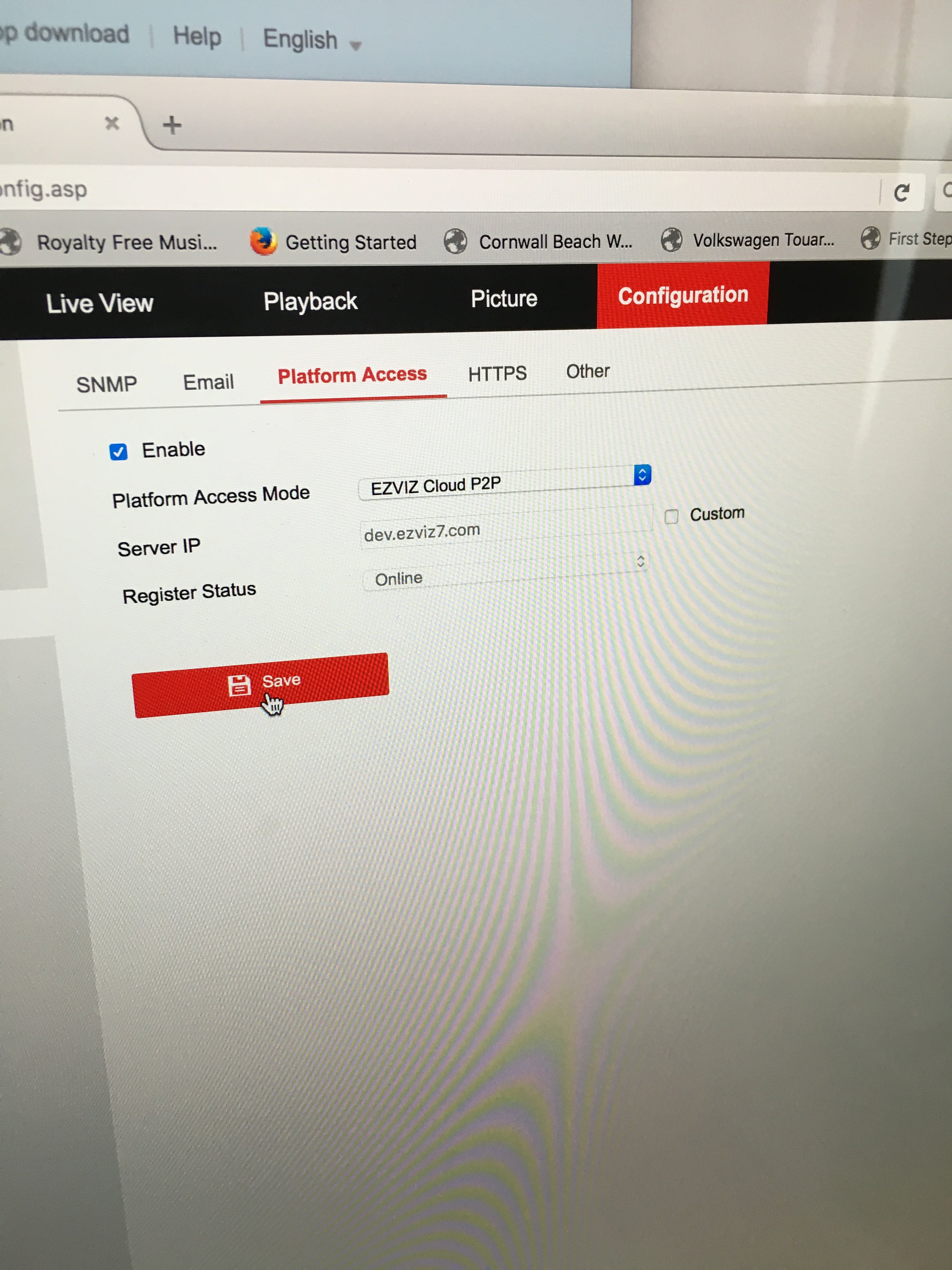

Next, navigate to the Platform Access tab. Ensure that the Enable option is ticked and that the Access Type is set as EZVIZ Cloud P2P and hit Save.
As of Q1 2016, EZVIZ Cloud P2P is being renamed to Hik Cloud P2P within Hikvision's camera / NVR / iVMS 4200 configuration options. Other than the name, nothing else has been changed regarding EZVIZ functionality.

Can you confirm that the NVR and camera both have an appropriate Default Gateway and DNS server set in their network configuration options? The Default Gateway will need to be the same IP address as your router, and the DNS server can be set to 8.8.8.8
If they both show that EZVIZ / Hik Cloud P2P status is online (Network > Advanced > Platform Access via a web browser) then it's likely to be caused by an incorrect default gateway.

Thanks kieran for the reply. I did change the preferred DNS to the Google ones however unsure how to change the gateway. I've attached a couple screenshots that might make things a little clearer.

You'd change the default gateway as you would any of the other fields - just change what's in there and hit save ;)
Are you certain that 192.168.0.1 is the LAN IP of your router?
Paulcornwall
9
My Sky router is connected to my AirPort Extreme as the supplied router by sky is appalling. 192.168.0.1 takes me to my sky router homepage while 192.168.0.16 is my AirPort Extreme hub.

In that case you've got the right default gateway set.
Just to check, are you trying to add a camera to EZVIZ or an NVR? Is the camera connected directly to the POE ports on the back of the NVR?

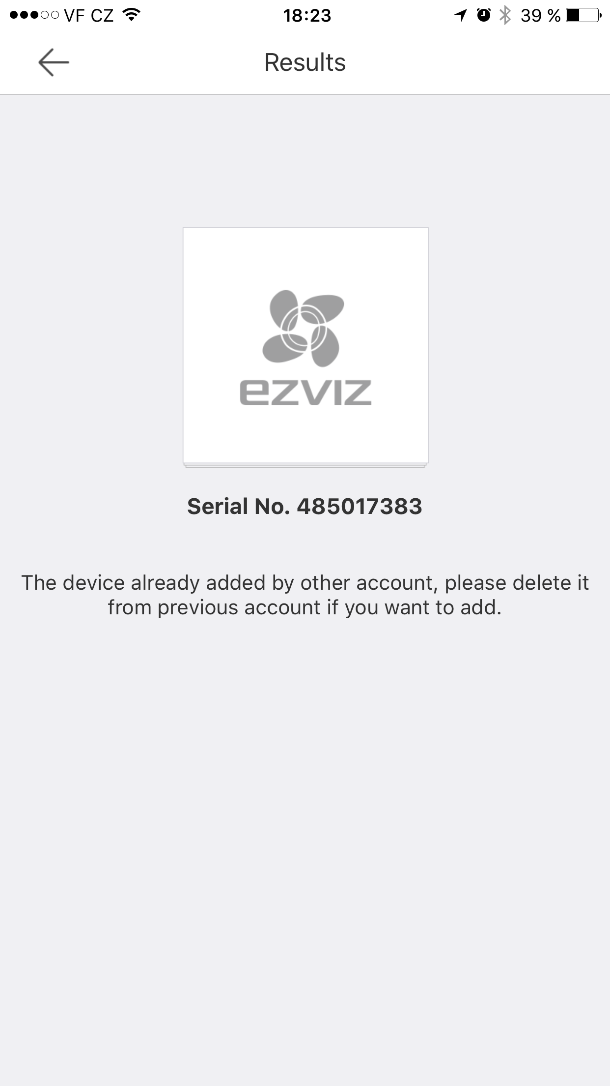

Hi! Help me please!
I can't add my camera. What's problem!?

If you've previously added that camera to another EZVIZ account, you will need to remove it first before being able to add it to a new account.
Otherwise, if you haven't added this camera yourself, then you will need to get in contact with Hikvision and request that they remove it from the other account first. It might also be wise to not publicly display your camera's serial number to stop this happening again.

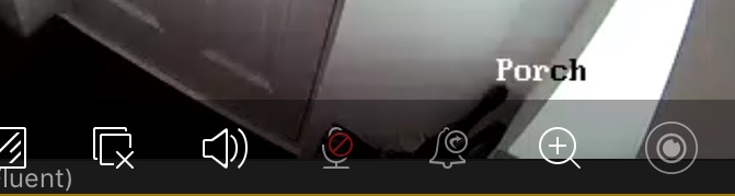

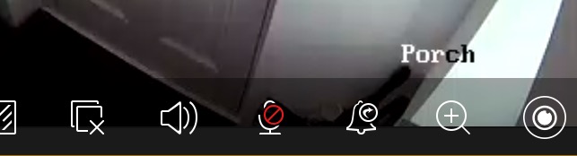

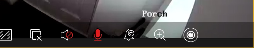

I've attached some screenshots to show what I mean. All are from iVMS 4500 on my iPhone.
This image is when I view the camera on the LAN.
This image is when I view the camera on the LAN. I have to select the microphone icon to hear the audio from the camera. That icon is greyed out on the EZVIZ feed.
This image is when I view the camera from the EZVIZ service.
