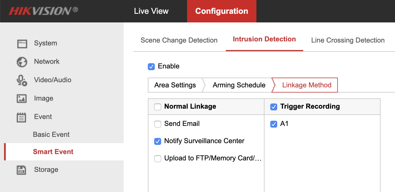

In regards to the app notifications, do you have "notify surveillance center" ticked in the linkage action section of the particular smart event you are using? (see screenshot below)
