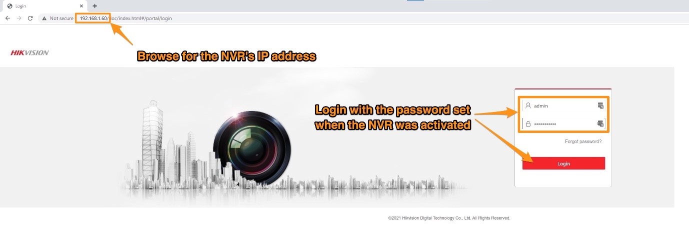

Step 1:
Connect to your NVR in a web browser by using its IP address and logging in.​

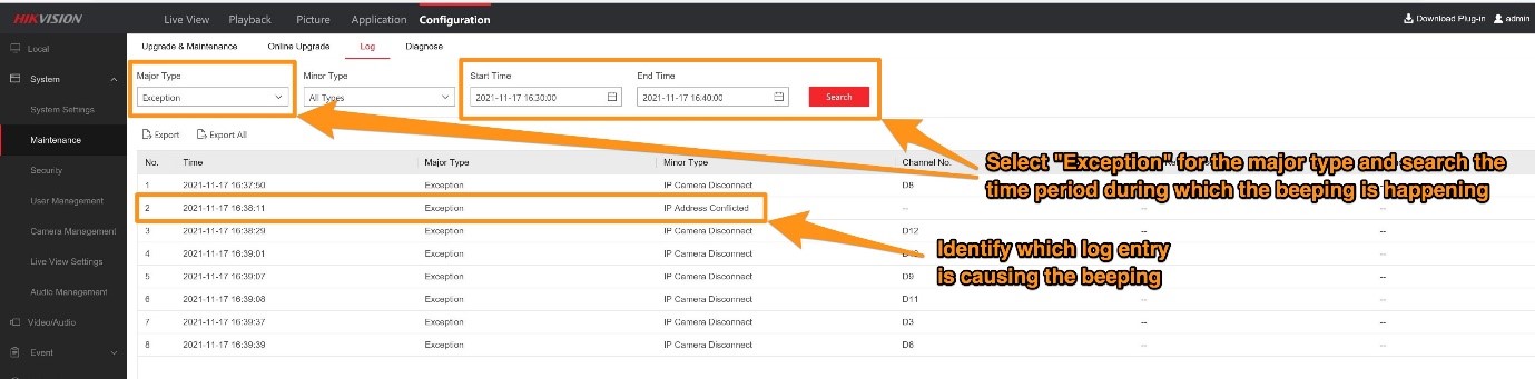

Step 2:
Check what the exception that is causing the beeping is in the NVR's logs. To find these, go to:​
Configuration → System → Maintenance → Log
Set the log search so that the "Major Type" is "Exception", with the start and end time covering a period when the beeping has occurred.​
For example, you can see that it is an IP address conflict causing it in this case.​
Note - Camera disconnections will not cause the NVR to beep.

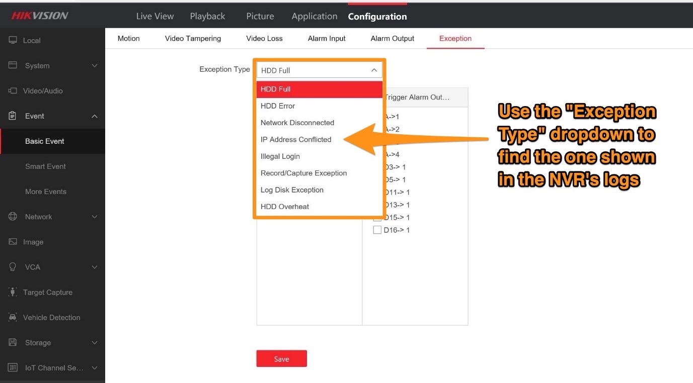

Step 3:
Go to:​
Configuration → Event → Basic Event → Exception
Find the "exception type" identified in step 2 in the dropdown on this page.​

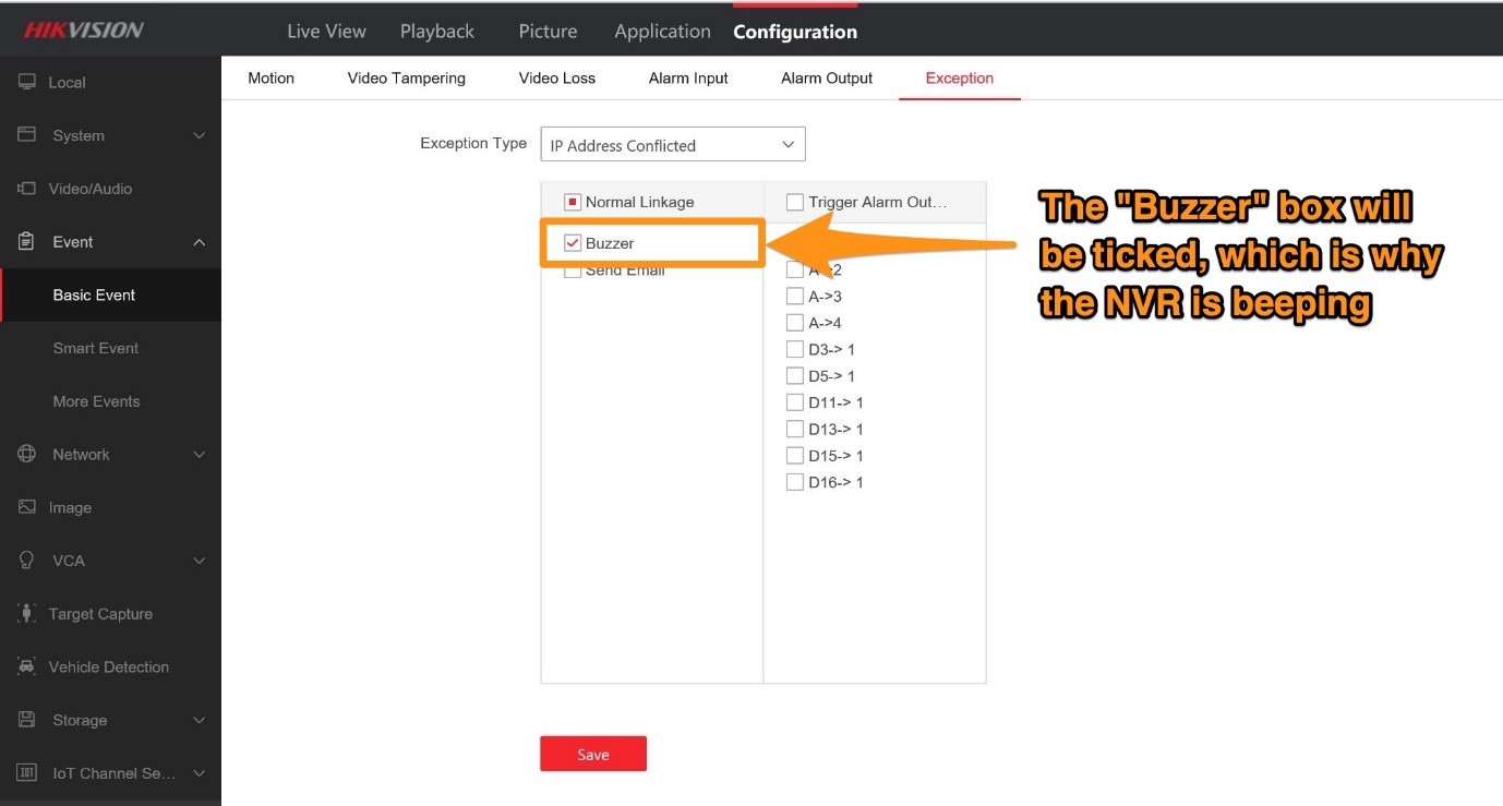

Step 4:
Select the exception shown in your logs from the dropdown.​
You will see that "Buzzer" is ticked as a "Normal Linkage" action, which is what is causing the NVR to beep.​

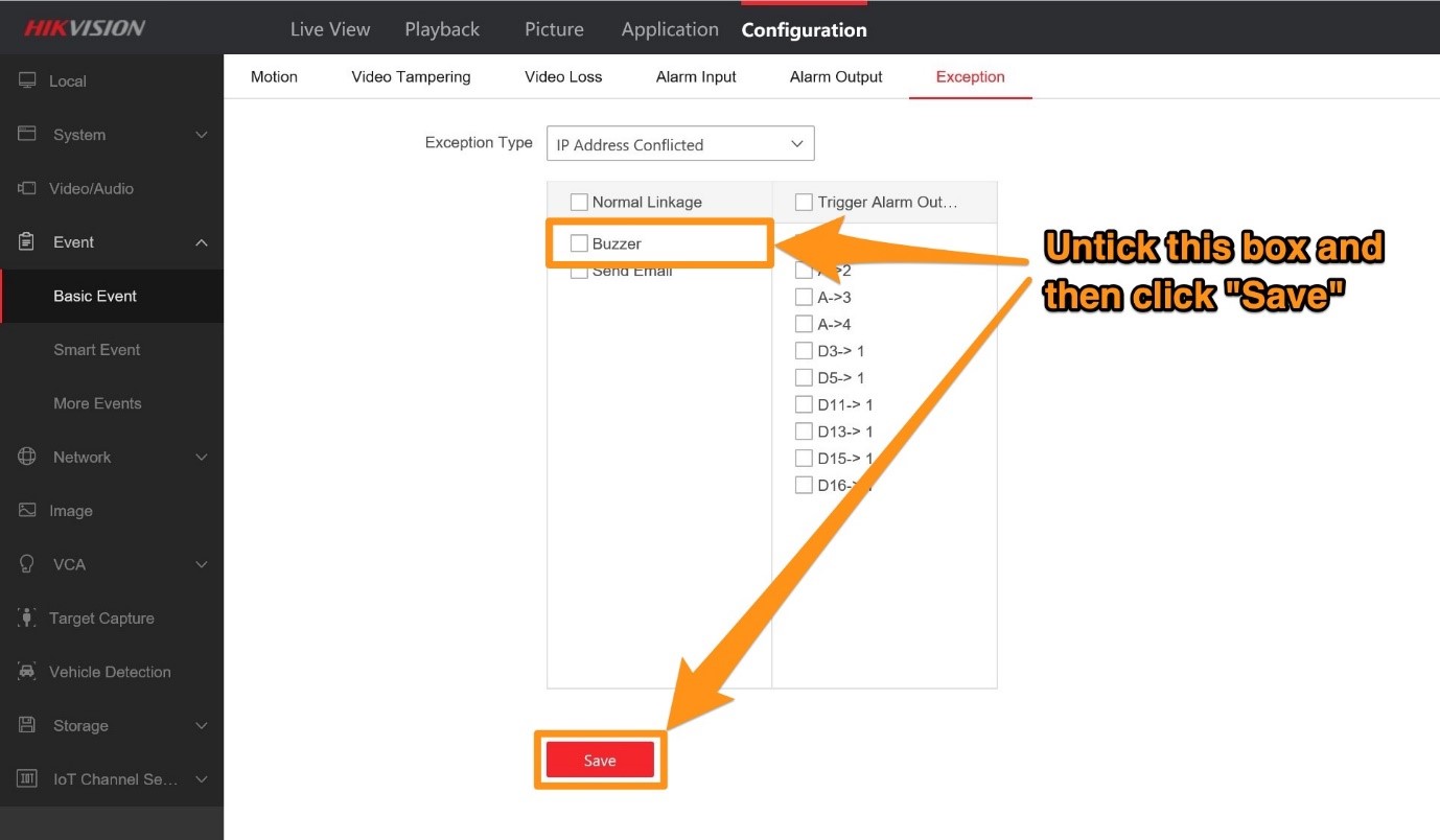

Step 5:
Untick this, click "Save", and the beeping should stop.​
