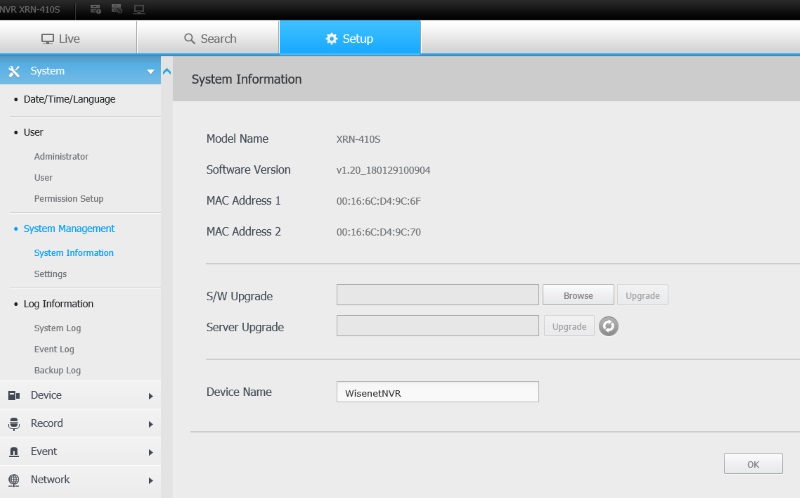

You need the .img file to update your software. Extract/copy this file to an easily accessible location on your desktop or onto a USB, then open up the NVR in WebViewer.
Select the 'Setup' tab from the options on the top bar and select 'System Management ---> System Information'.

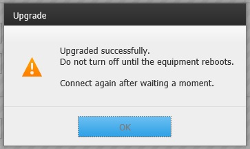

Click on the browse button at the end of the S/W Upgrade box which will then allow you to search for the .img file you just saved. Select the file and click 'Upgrade'. Your software update will then begin and a pop up will appear with a spinning blue circle. Once complete another pop up will appear as below:
Close the browser. Your NVR should reset itself and beep a few times. The lights on the front may go off as it refreshes itself but they should return to normal once it has completed the update. When the lights are back to their previous state (the REC light should be on), search for the NVR again using Wisenet Device Manager. Your NVR should now be up-to-date.

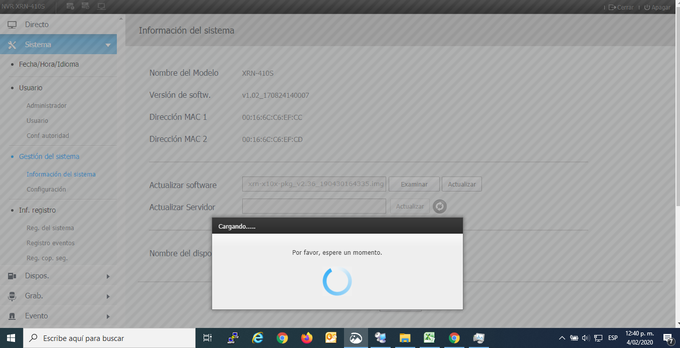

Hola buenas tardes
Estoy actualizando remotamente un NVR WISENET XRN410S, el cual tien la versión 1.2_170824140007. Le he cargado el archivo y le di actualizar, pero es bastante demorado llevo más de 15 minutos esperando, ¿es esto normal?
Adjunto evidencia

Falla ocasionada por denegacion de firewall
It sounds like you need to add permissions to your firewall to allow full access to the NVR, you may have access to the NVR via P2P/port forwarding but what you are doing when updating firmware remotely is loading an unknown file from outside your network and trying to pass it to you NVR on your local network, this is why the firewall may be causing problems. The simplest solution is to only update firmware from your local network, if you very rarely have access to the local network then you will need to look at your firewall and network security settings so that you can have permission for full remote access to this specific IP device.
