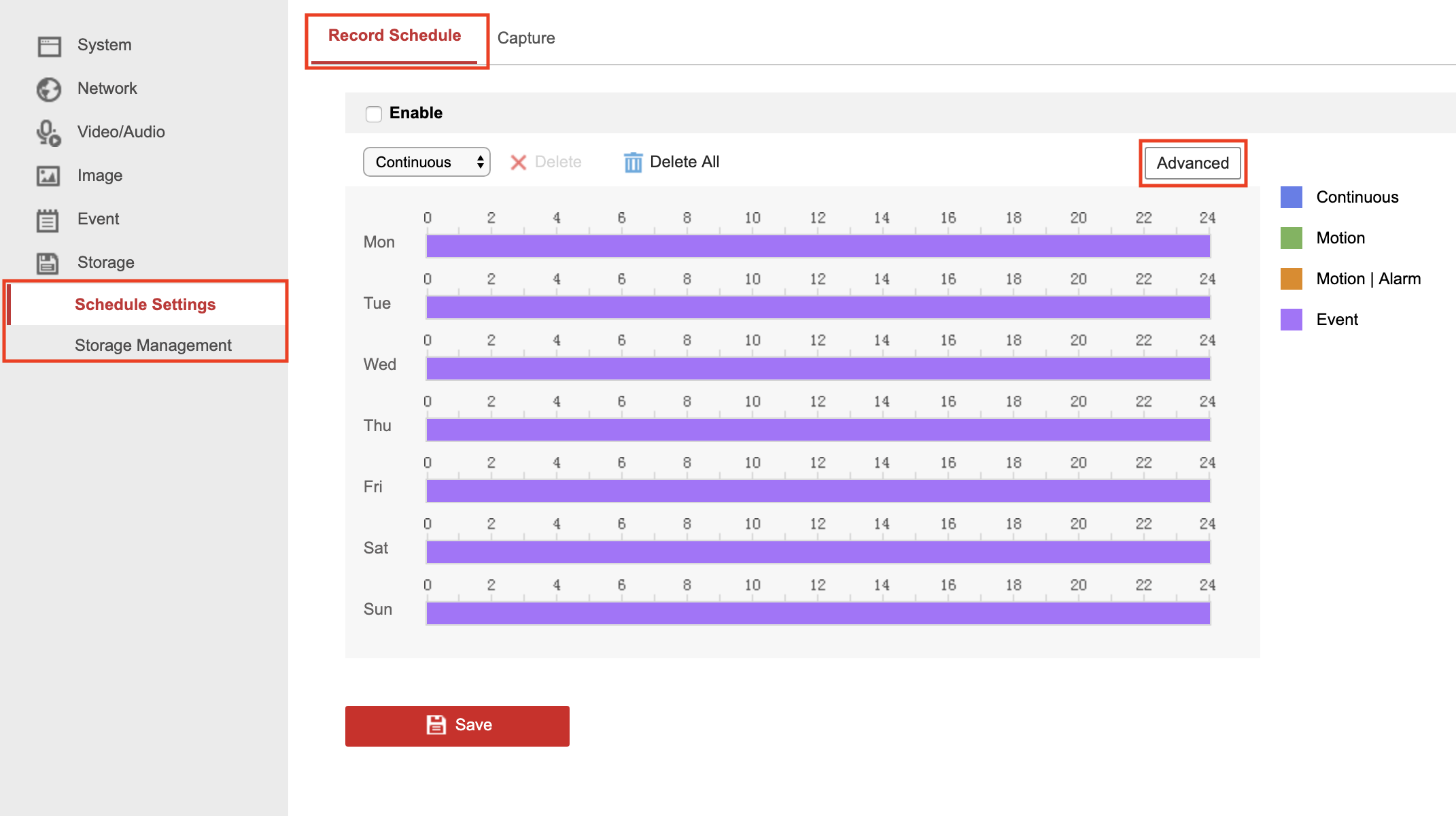

2) Go to Configuration > Storage > Schedule Setting > Record Schedule
3) Click the 'Advanced' button at the top right of the record schedule

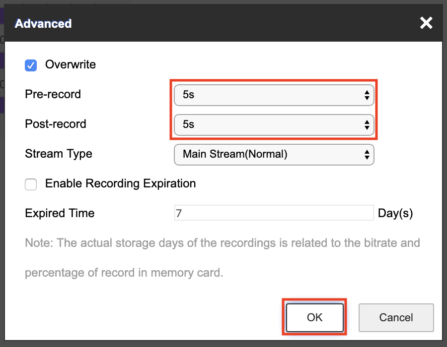

4) Select the duration you want from the pre/post record dropdowns and click OK

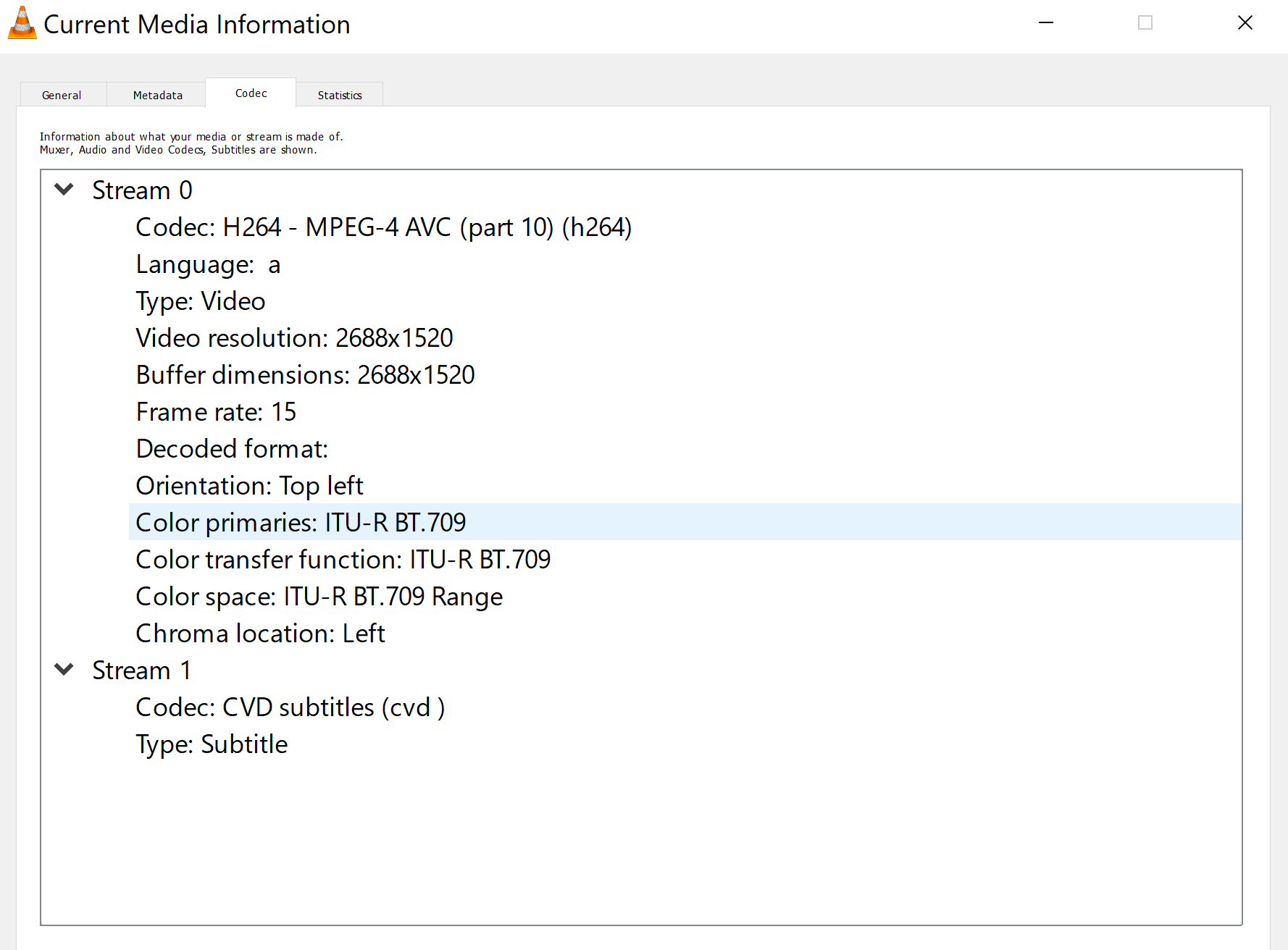

Using VLC player you can get some frame data, but not sure if this is for the current playback position or not.
I will keep trying, but look forward for any comments from any experts.
