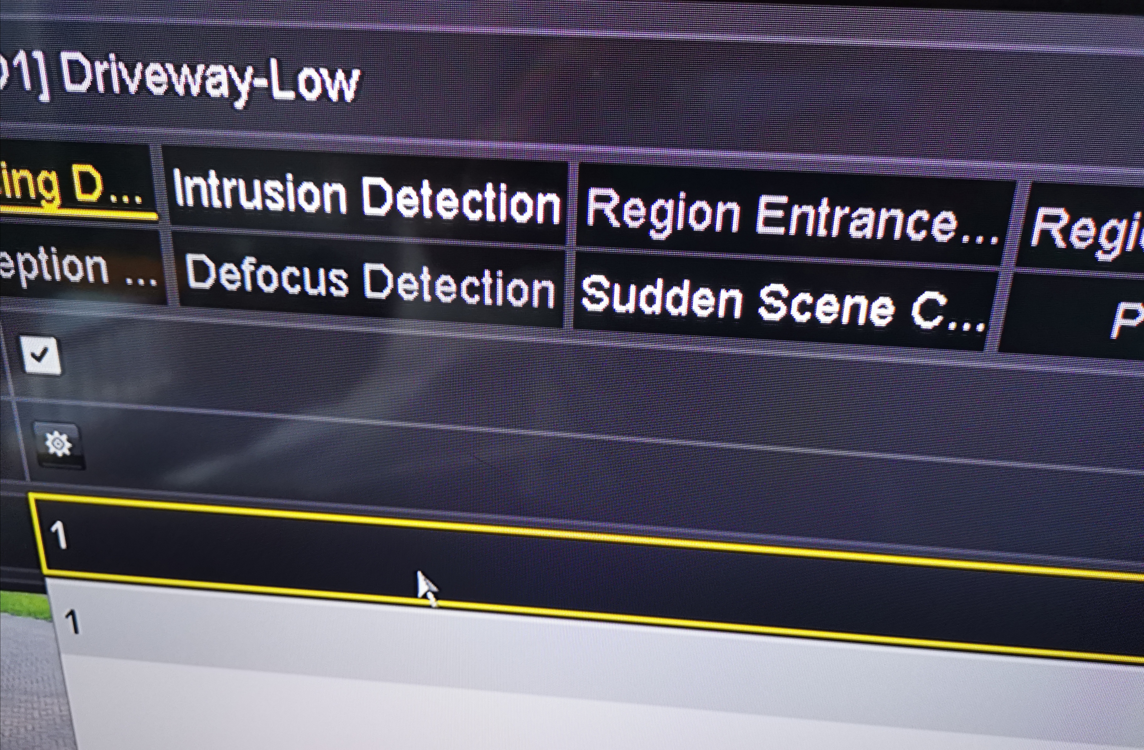

Interested as well I have just set up 7604 nvr and new IP 2347 colourvu cameras and can only have 1 line, the sectik were 2/3/4 is doesn't appear and can only apply to one line n rule etc ‍

Are you using h.265+?
When you enable that the camera will warn that some other features are lost / cannot be supported because of the CPU power required to use h.265+

Hi Phil I was using that, I have put back to H.265 and it still only allowing 1 line crossing
