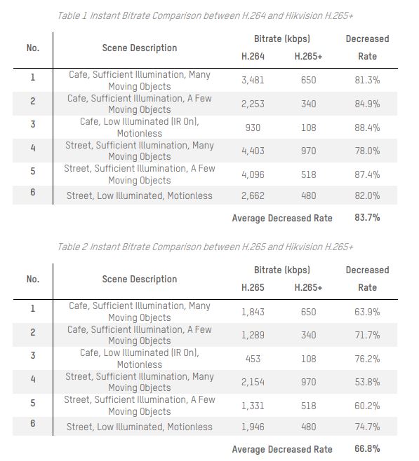

Below is some information from Hikvision's literature to show exactly the difference between H.264, H.265 and H.265+.
Bandwidth Savings
The above tables show us that H.265+ offers an average bandwidth saving of 83.7% over H.264 and 66.8% over H.265, this is a huge reduction! Let's look at how this is important in real world installs.

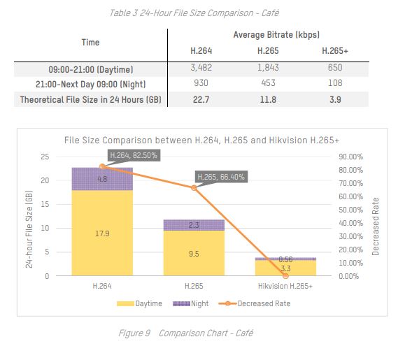

Storage Savings
The above graph shows that there are also huge differences when looking at savings in storage between the different codecs. H.265+ offers a 82.5% saving on H.264 and a 66.4% saving on H.265.
I use this CCTV calculator when advising customers on how much storage they'll need for their system. Once again, H.265+ isn't yet an option for online calculators but you'll be able to use H.265 and calculate an answer based off the knowledge that with H.265+ you'll need 66.4% less storage.
