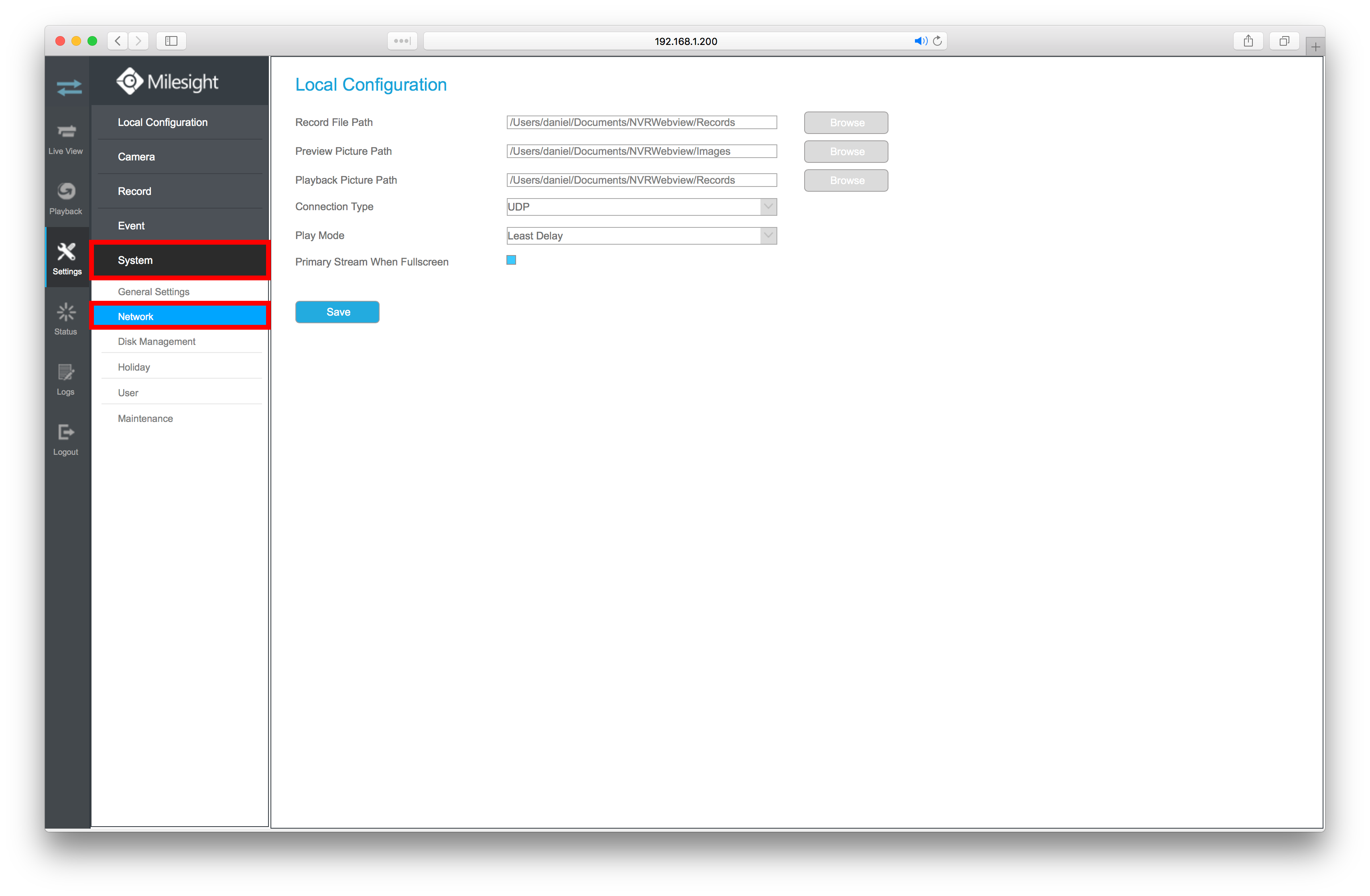

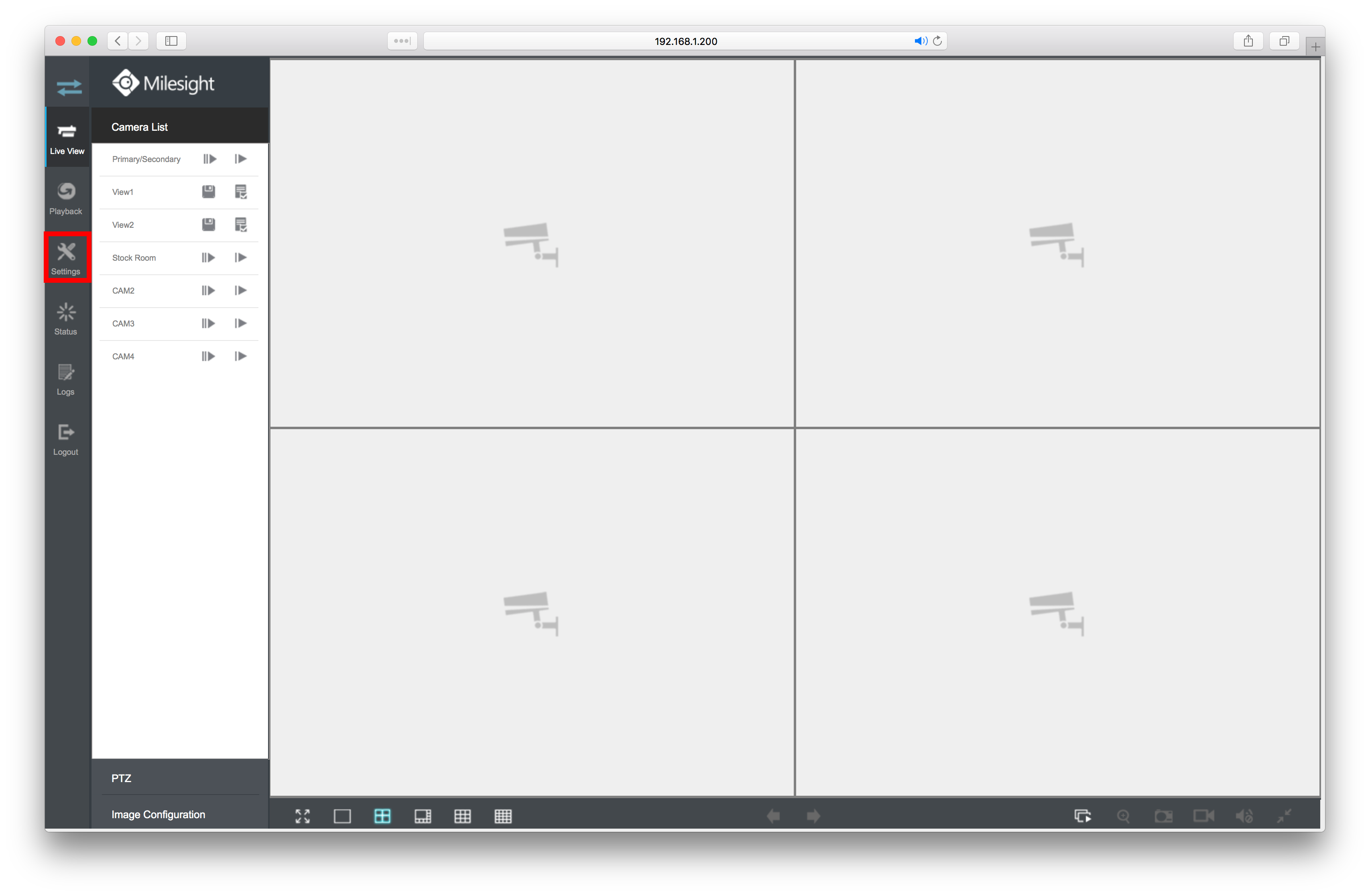

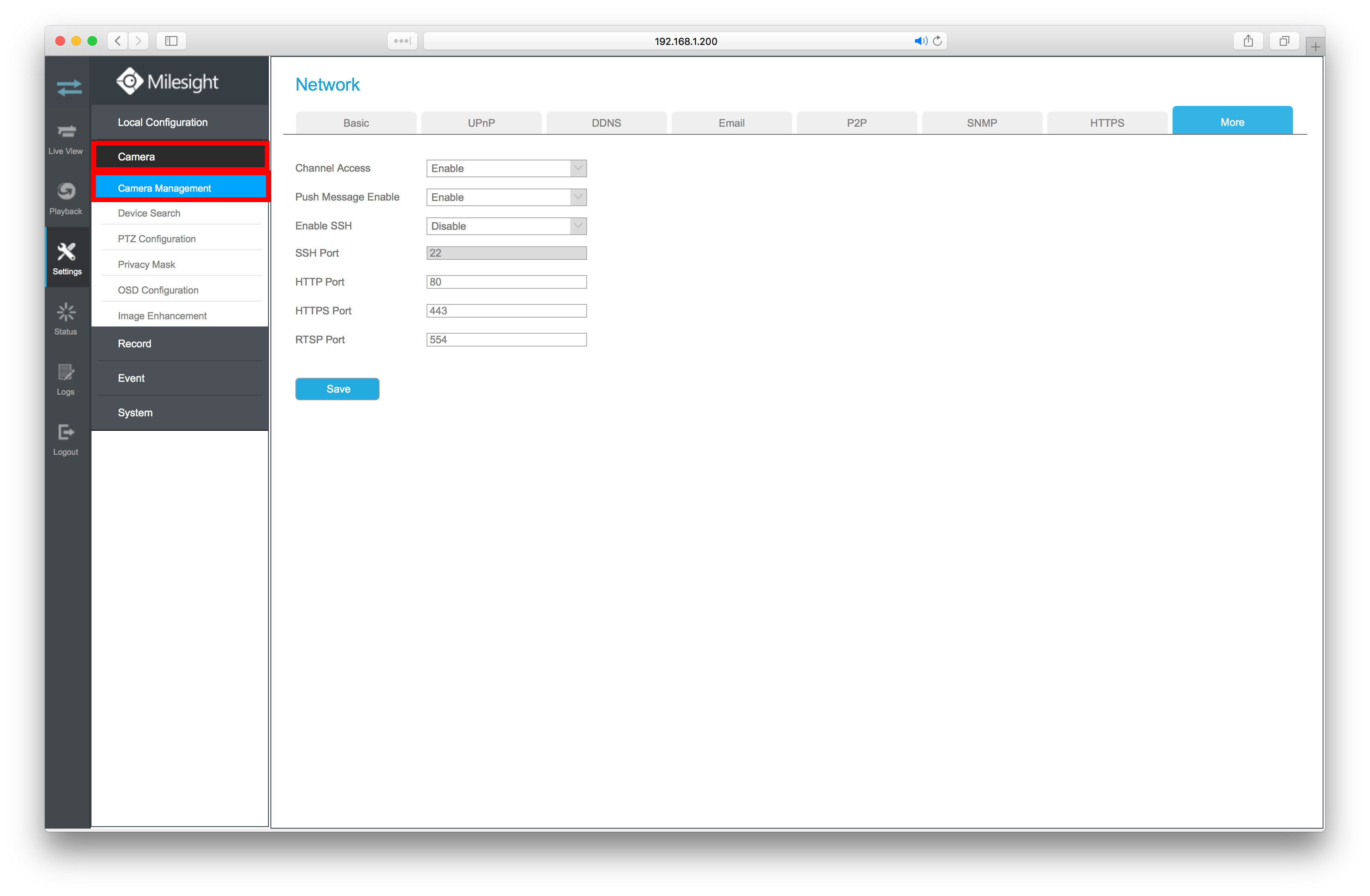

Step 1: Open Internet Explorer/Safari and log in to your NVR, once logged in click on Settings from the left menu bar
Step 2: Click System and then click the Network menu from the drop-down

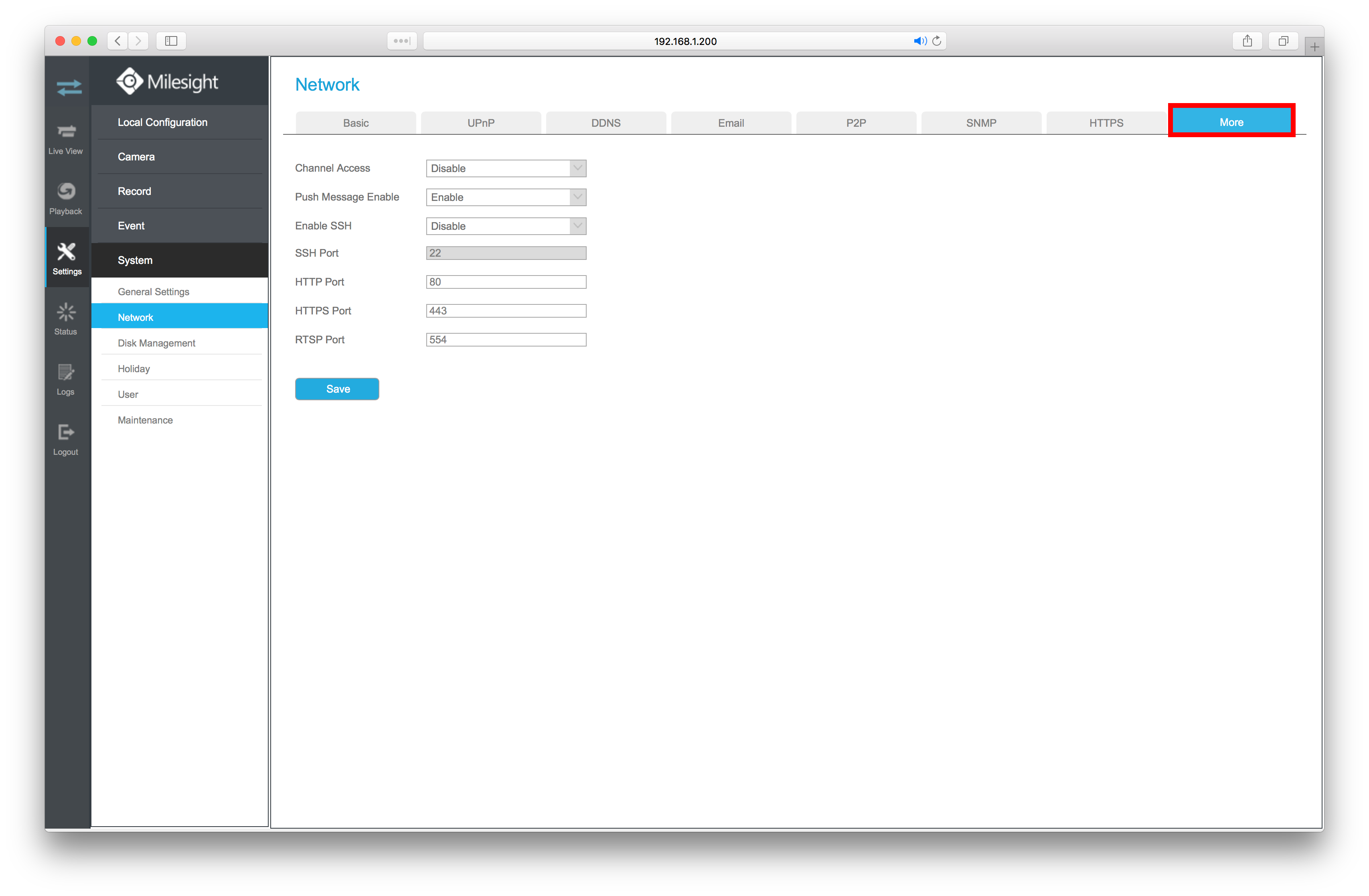

Step 3: Click the More tab

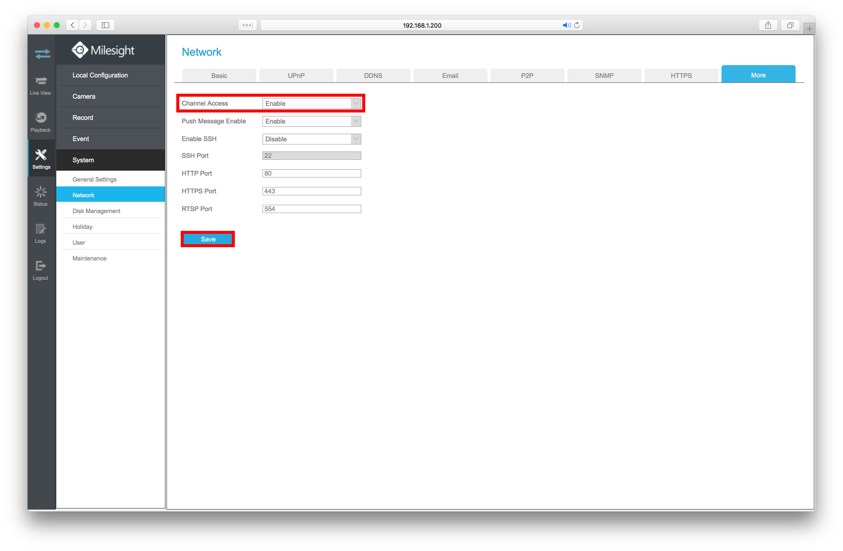

Step 4: Click the drop-down labeled Channel Access and change it from Disable to Enable, then click Save
Step 5: Click the Camera menu and then click Camera Management from the drop-down
Step 6: Click the IE icon next to the camera you want to access

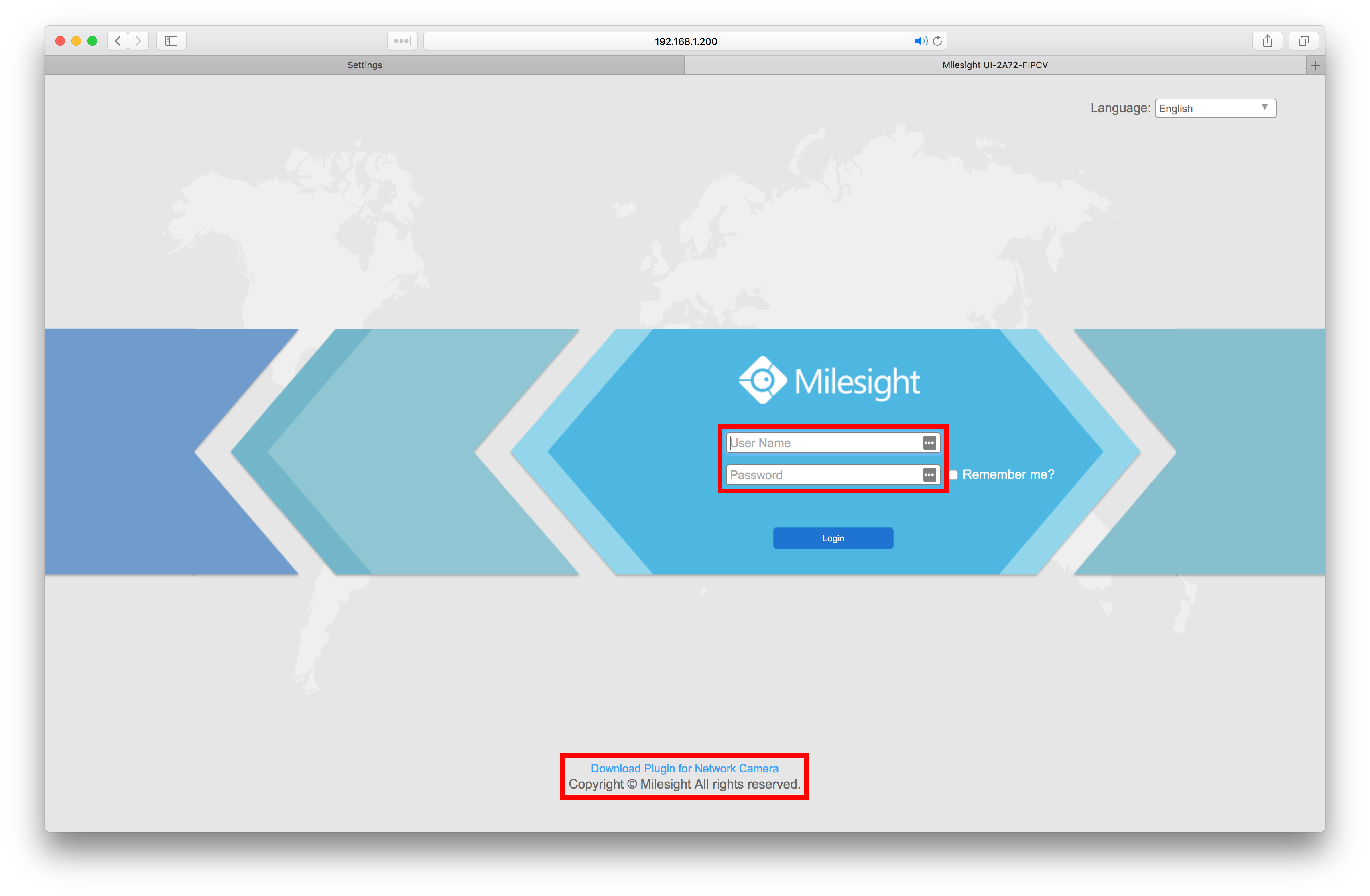

Step 7: Login to the chosen camera

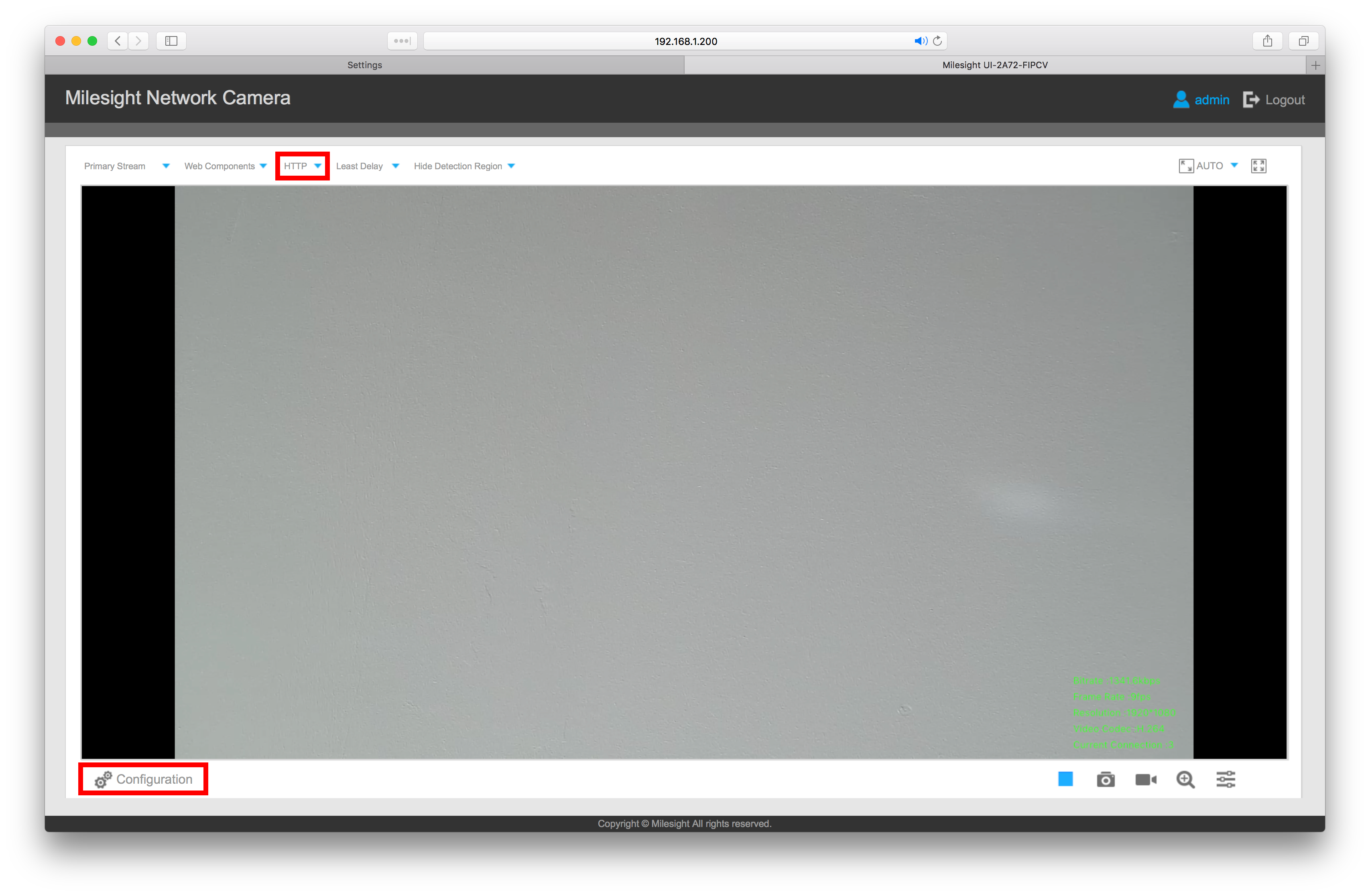

And there you are, you can now access any Milesight camera connected directly to the PoE ports of a Milesight NVR, once you have access you can click Configuration and edit any camera setting you want as well as update the cameras firmware.

1. Check that you have the latest web plugin downloaded (link to download the plugin file can be found on the login page - see above)
2. Check that the camera is streaming with HTTP and not UDP (see above)
