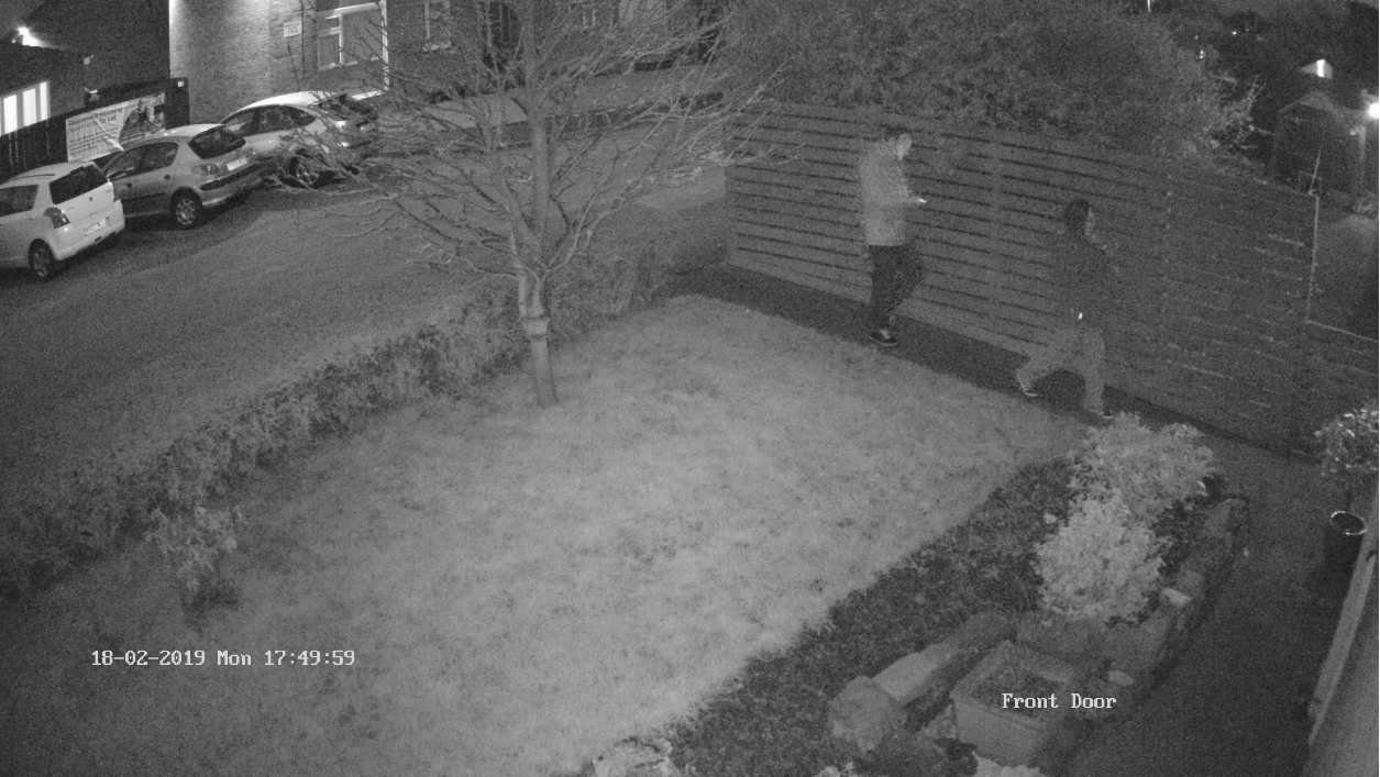

It is and this was from last night..
I have played about with the settings, but I cannot get it usable
Hi Mark,
Can you confirm that you have updated it to the V5.5.82 firmware please?
There doesn't seem to be a lot of IR in that image.
Can you please reset it to defaults and share the start image before tweaking.
Is it a 2.8mm model?
People/faces are small in the scene.

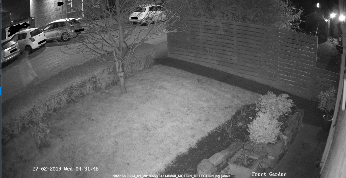

Hi Phil, busy old time but here is one from last night. Any idea what I need to do to make it sharper/better please?
you can see the person is a bit of a blur.. Ambient light isn't too bad..
As you have ambient light, have you checked the image quality with IR turned off? I would prefer a colour image over IR unless the scene is in complete darkness and you could add white light to further improve the image quality.
Sometimes its best to have a 8MP camera for daytime image clarity and a Lower resolution, low light camera with something like Lightfinder for better performance at night.
