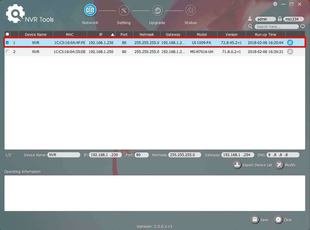

Step 4: Find the newly connected device in the NVR list (if the NVR doesn't appear it may be that it hasn't booted up yet, wait a few minutes and then click the refresh button at the top right of the window)
Step 5: Select the NVR from the list by clicking on it (make sure the little square on the far left is highlighted blue before continuing to the next step)

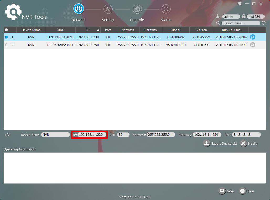

Step 6: Click the IP address box just below the NVR list and type a unique IP address into this box (this is where you will need to know your router & PC IP addresses)

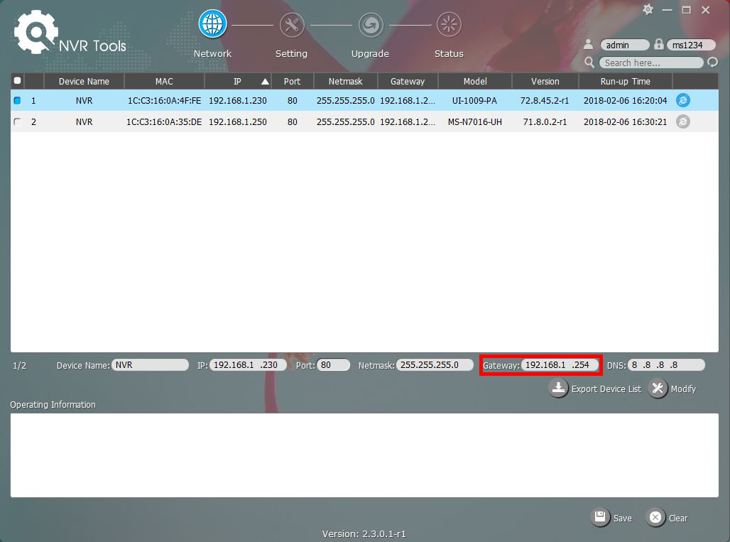

Step 7: Click the gateway box just to the right of the IP address box and type the IP address of your router

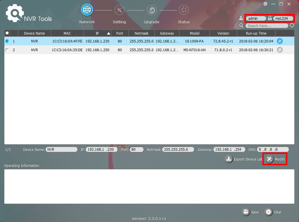

Step 8: Check that the username and password for the NVR are entered correctly in the top right of the Smart Tools window and then click the modify button (if it is a new NVR the default is username: admin --- Password: ms1234)
If the changes are successful you should get a confirmation message at the bottom of the window, you can then open a browser (Internet Explorer) and enter the IP address you just gave the NVR into the address bar and hit enter on your keyboard, a log in page should then appear and you can use the log in details you just used to change the IP address and log in to the NVR.
