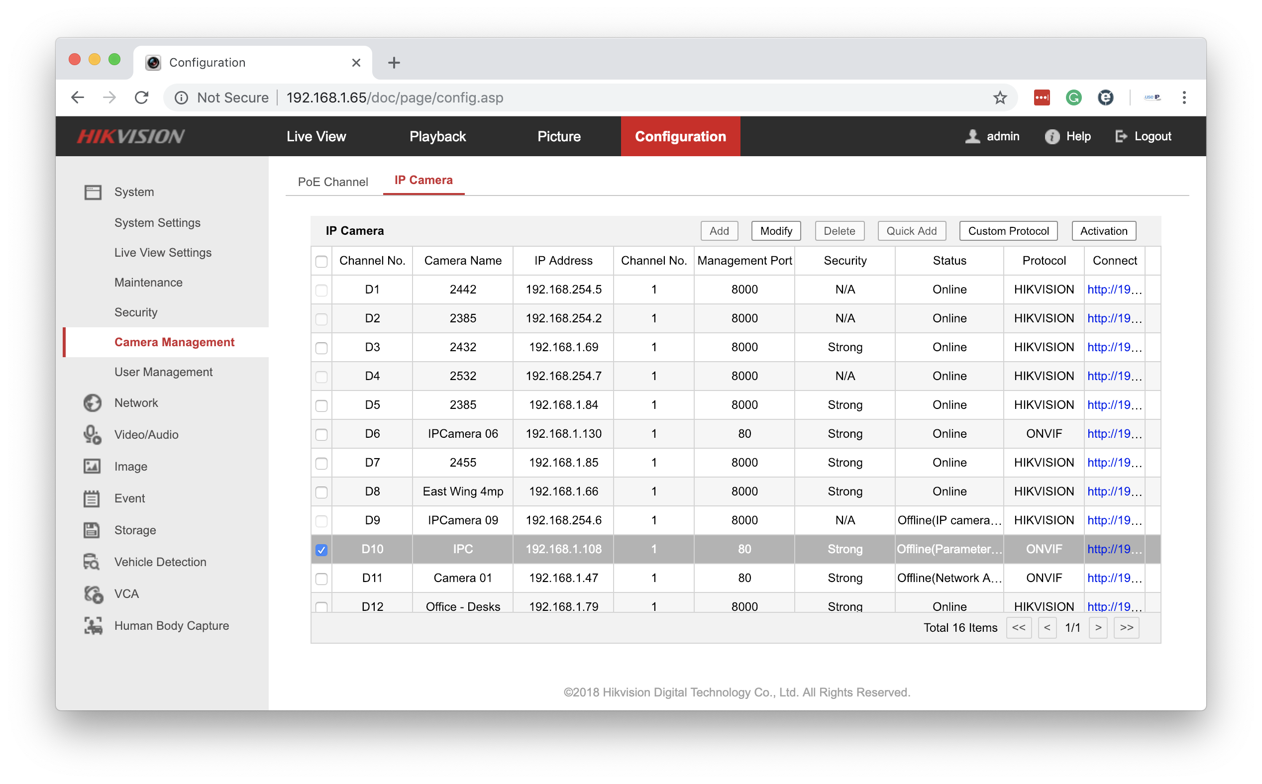

Step 1. Login to the Hikvision NVR and go to Configuration > System > Camera Management > IP Camera

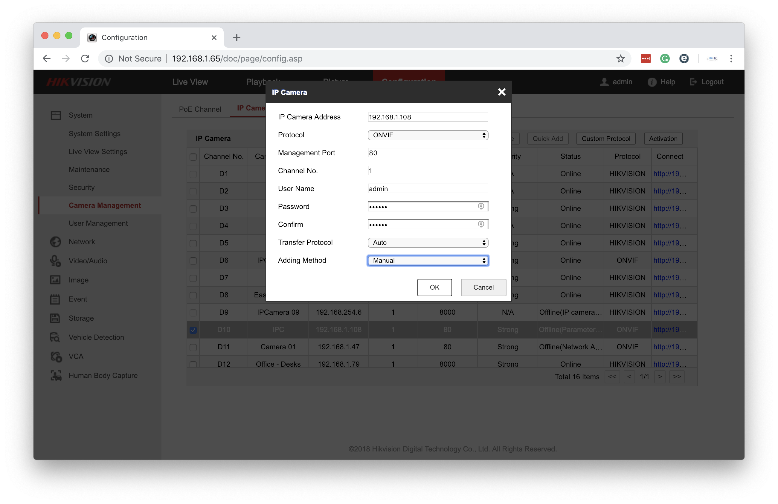

Step 2. Select an empty channel and click Modify and a popup will appear with the channel details
Step 3. Enter the IP address, the username, and password of the Optio camera and set the protocol to ONVIF then click ok
You will then be returned to the camera management list and it is likely the channel you have just added the camera to will still display as offline but if you click back to the Live View page the cameras live view should appear.

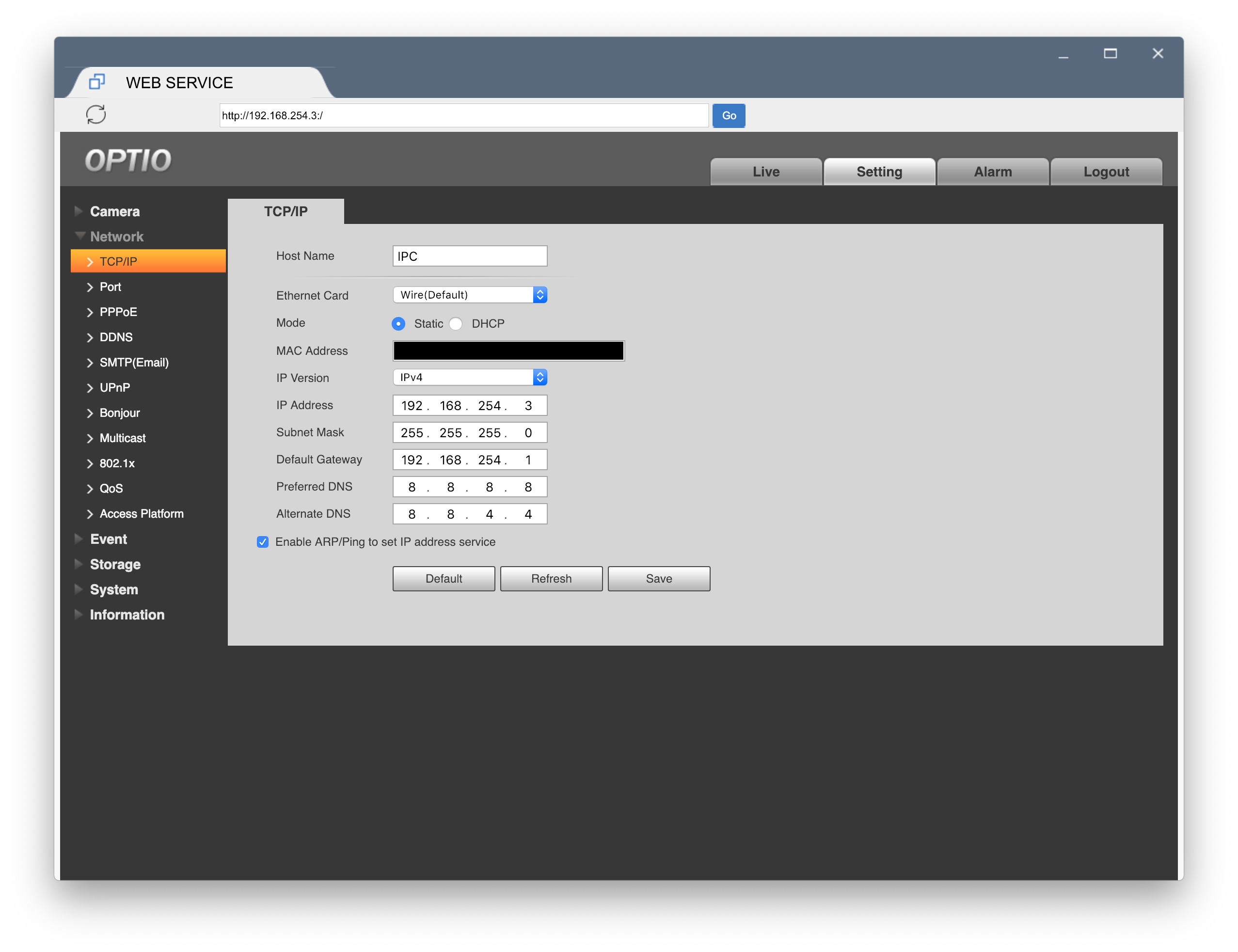

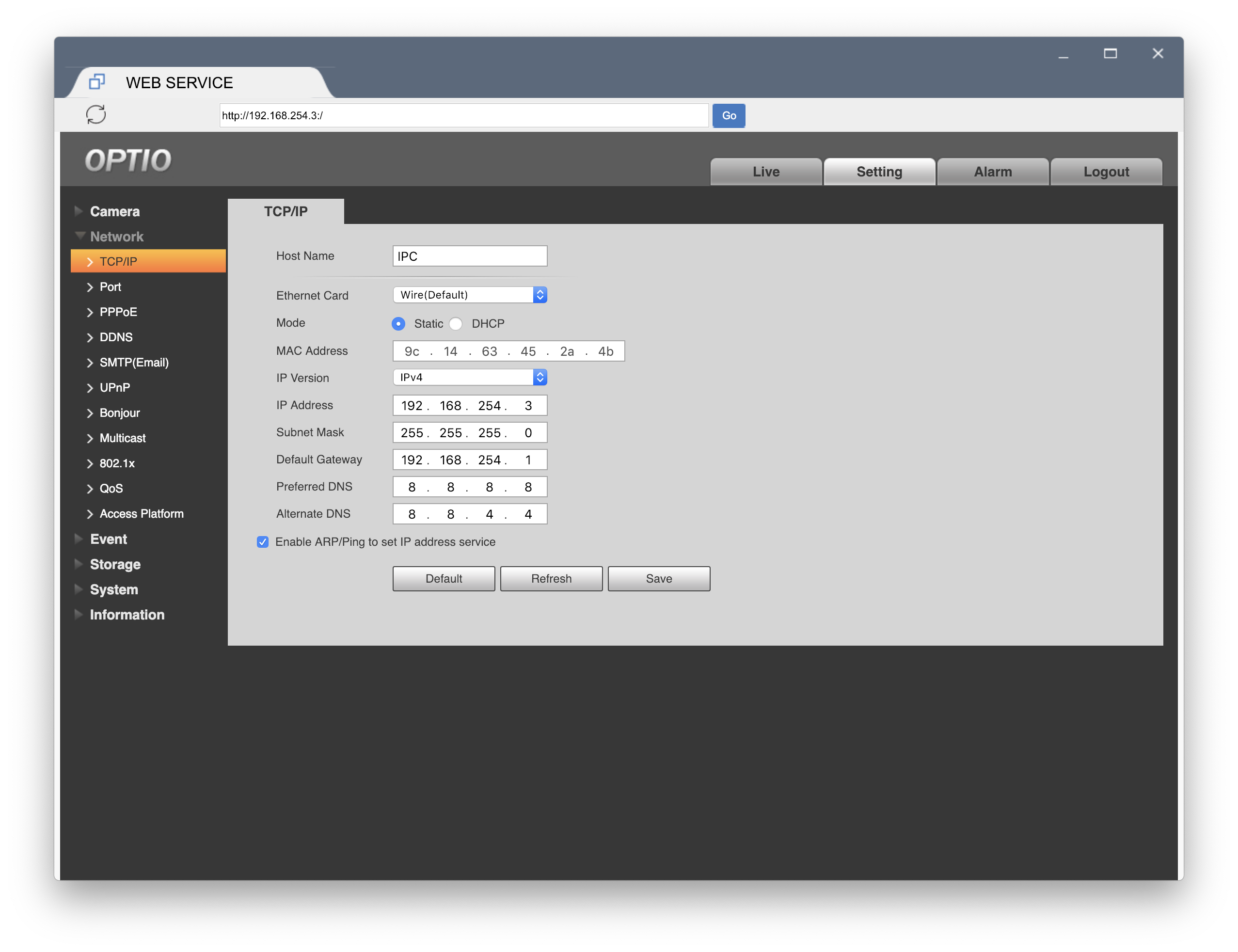

Step 1. Login to the Optio Camera using EasyViewer and go to Settings > Network > TCP/IP
Step 2. Change the IP address and Gateway of the camera to match the Subnet range of the Hikvision NVR and click Save (IP address - 192.168.254.xxx - make sure you set this as an address that doesn’t clash with any other cameras already attached to the NVR / Gateway - 192.168.254.1)
