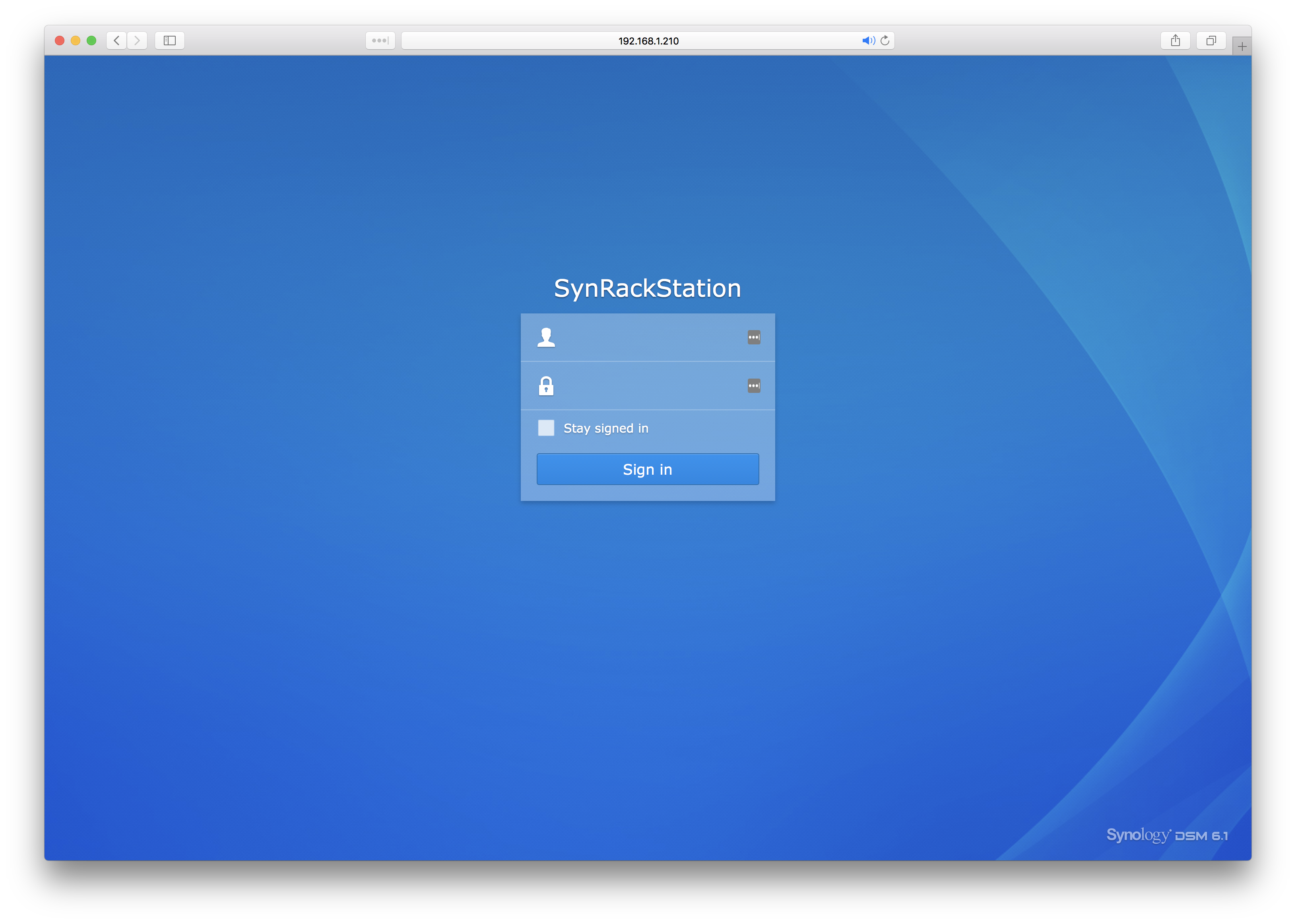

Step 1: Login to your Synology NAS​

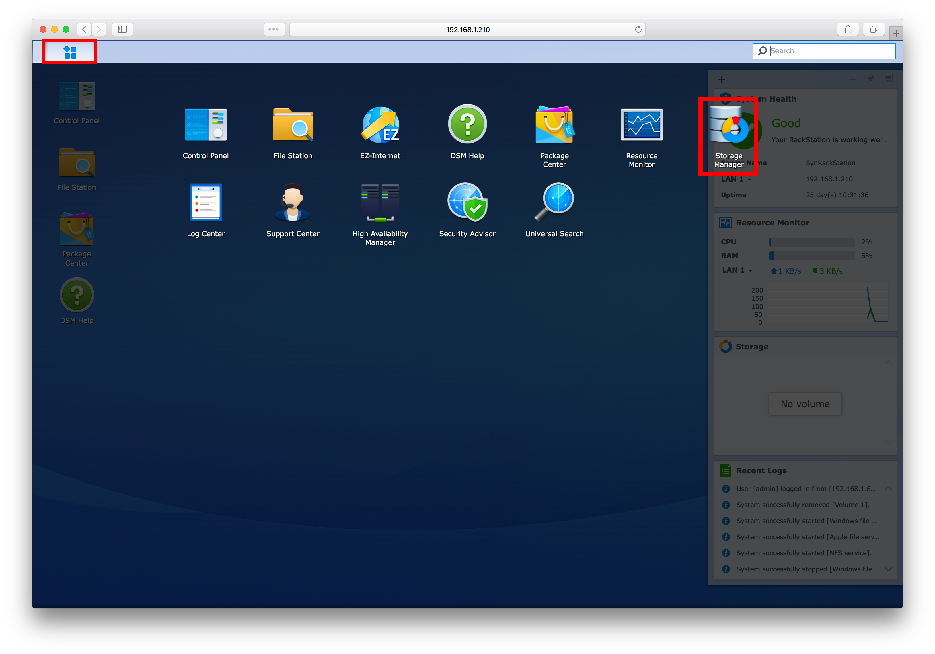

Step 2: Click the main menu and then open the Storage Manager window​

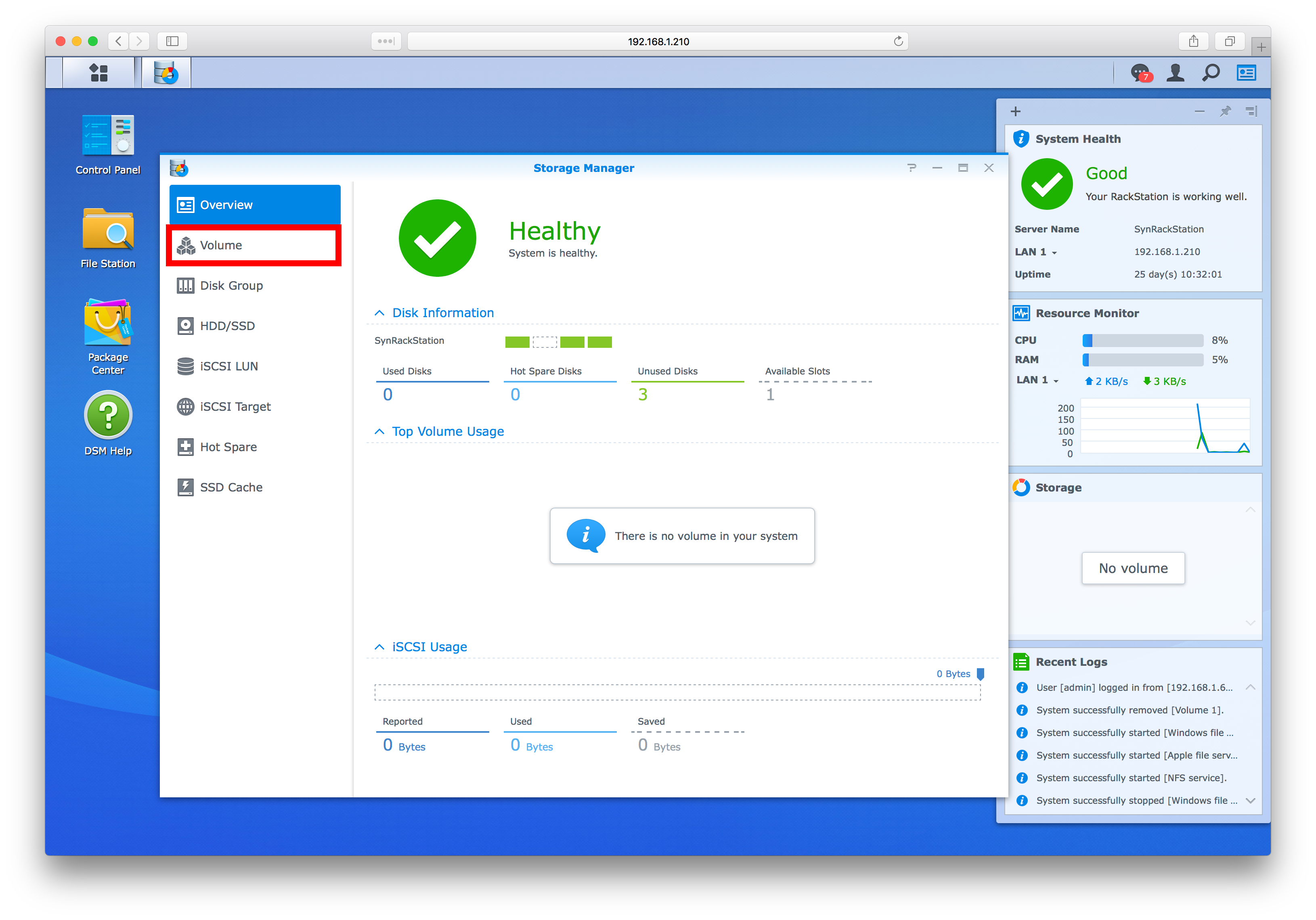

Step 3: Click the Volume tab from the menu on the left of the storage manager window​

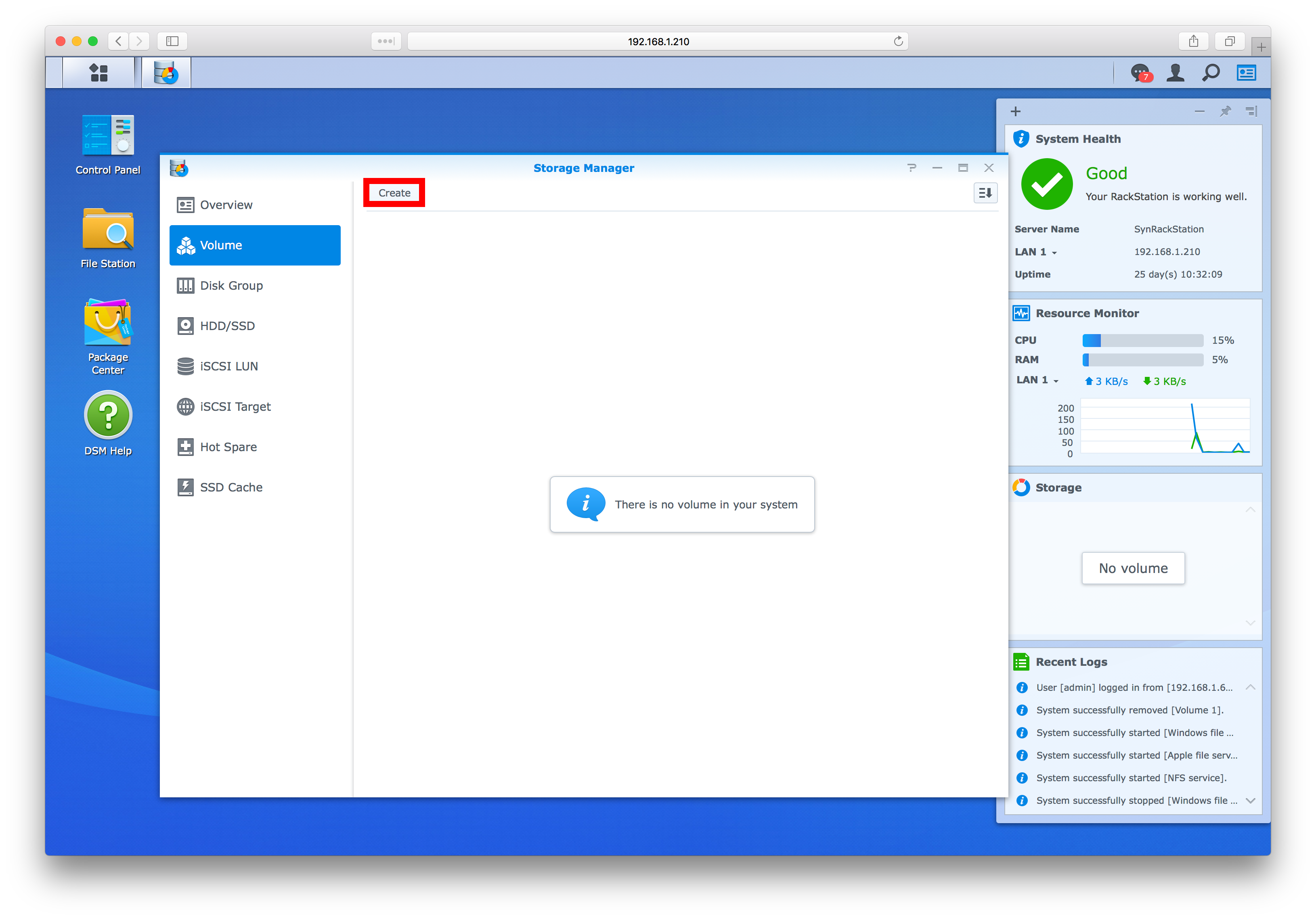

Step 4: Click the Create button at the top left of the volume window​

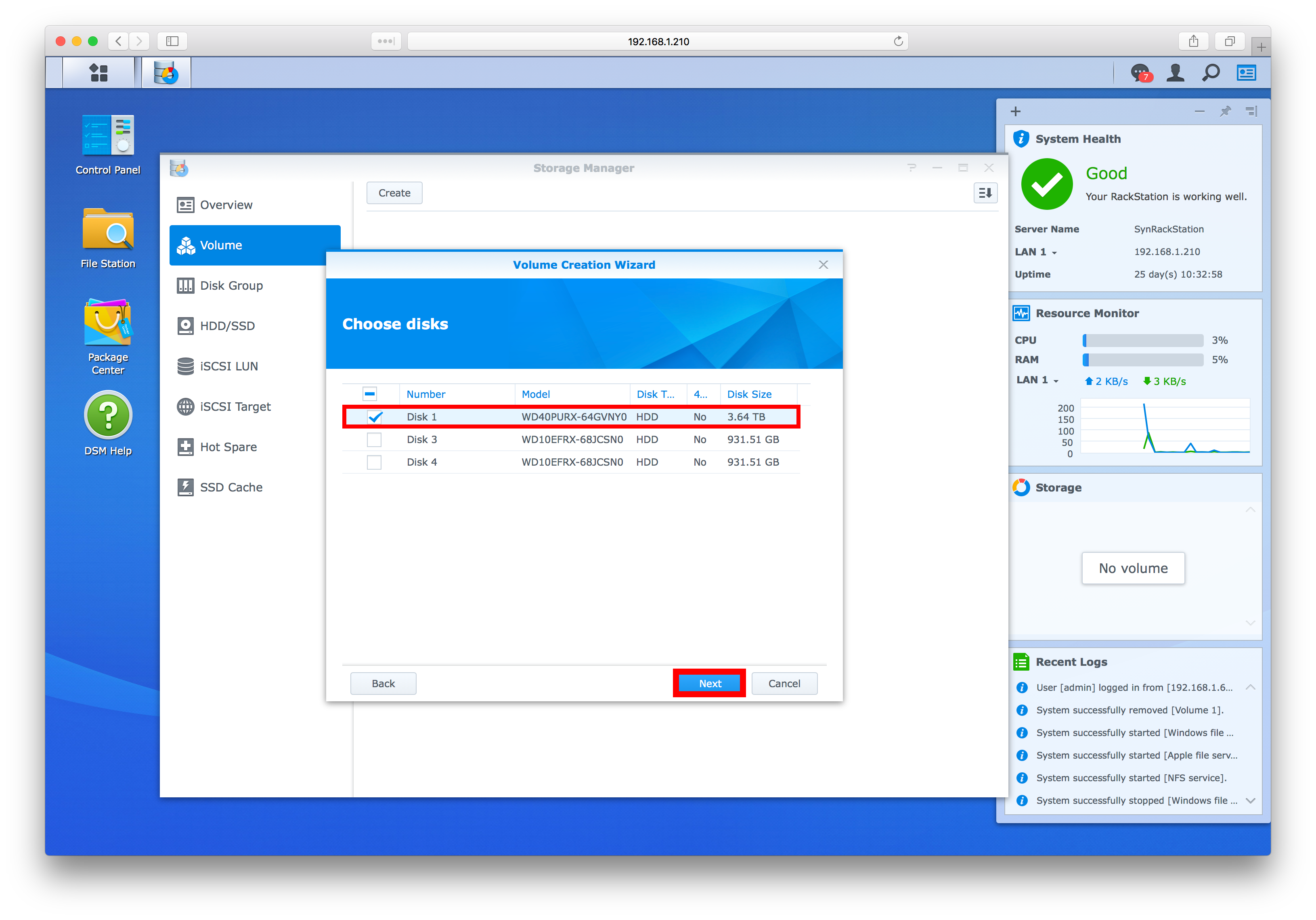

Step 6: Select the Hard Drive Disks that you want to include in this volume and then click next (we chose just 1, but if your NAS is larger or you are recording more cameras you can use as many as you like - but be aware that once created volumes can't be changed without deleting them, so give yourself enough space)​

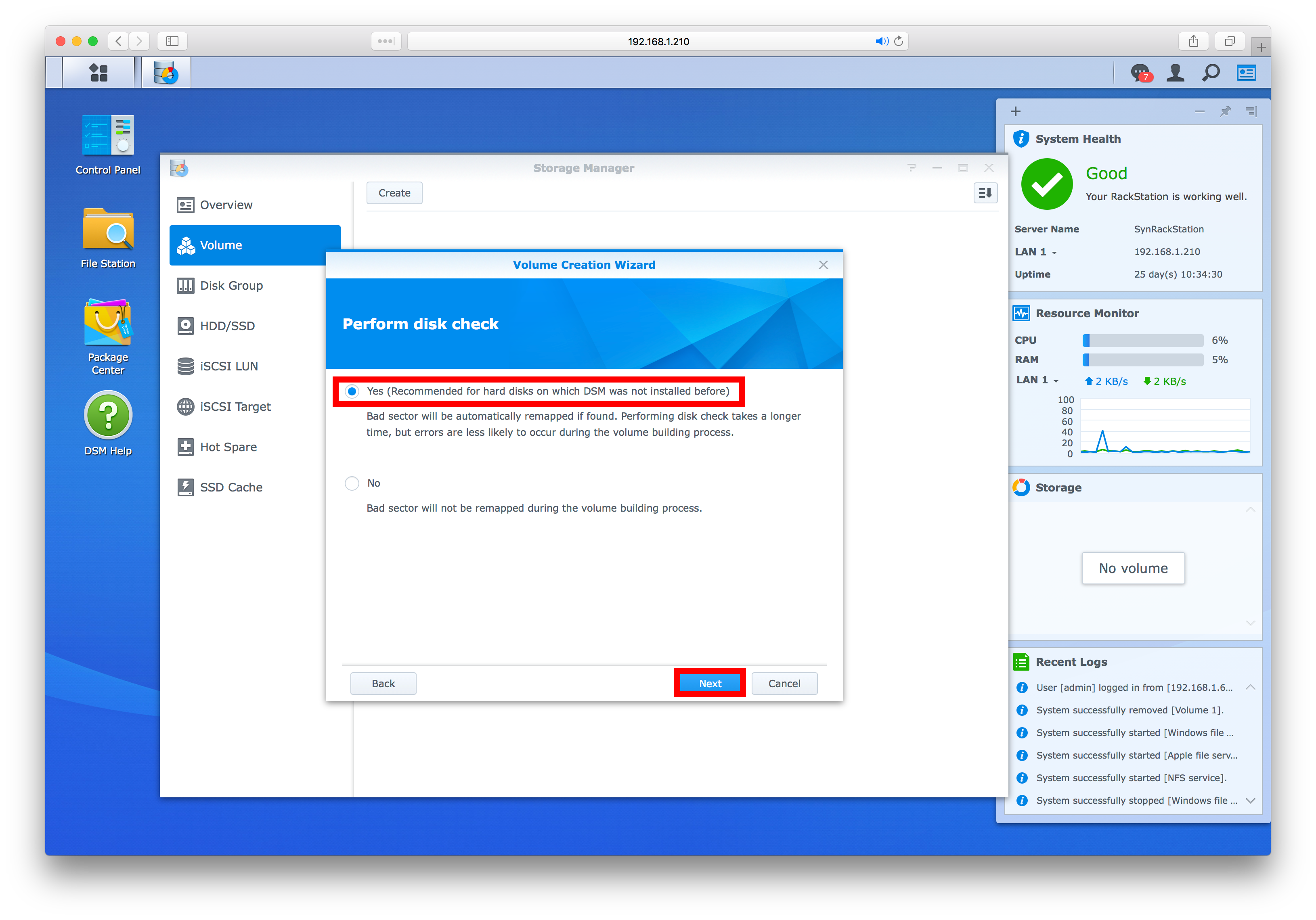

Step 7: Select Yes to do a disk check of the selected hard drives and then click next (we recommend doing this all the time, but especially if the HDD is new or has been repurposed from another storage device)​

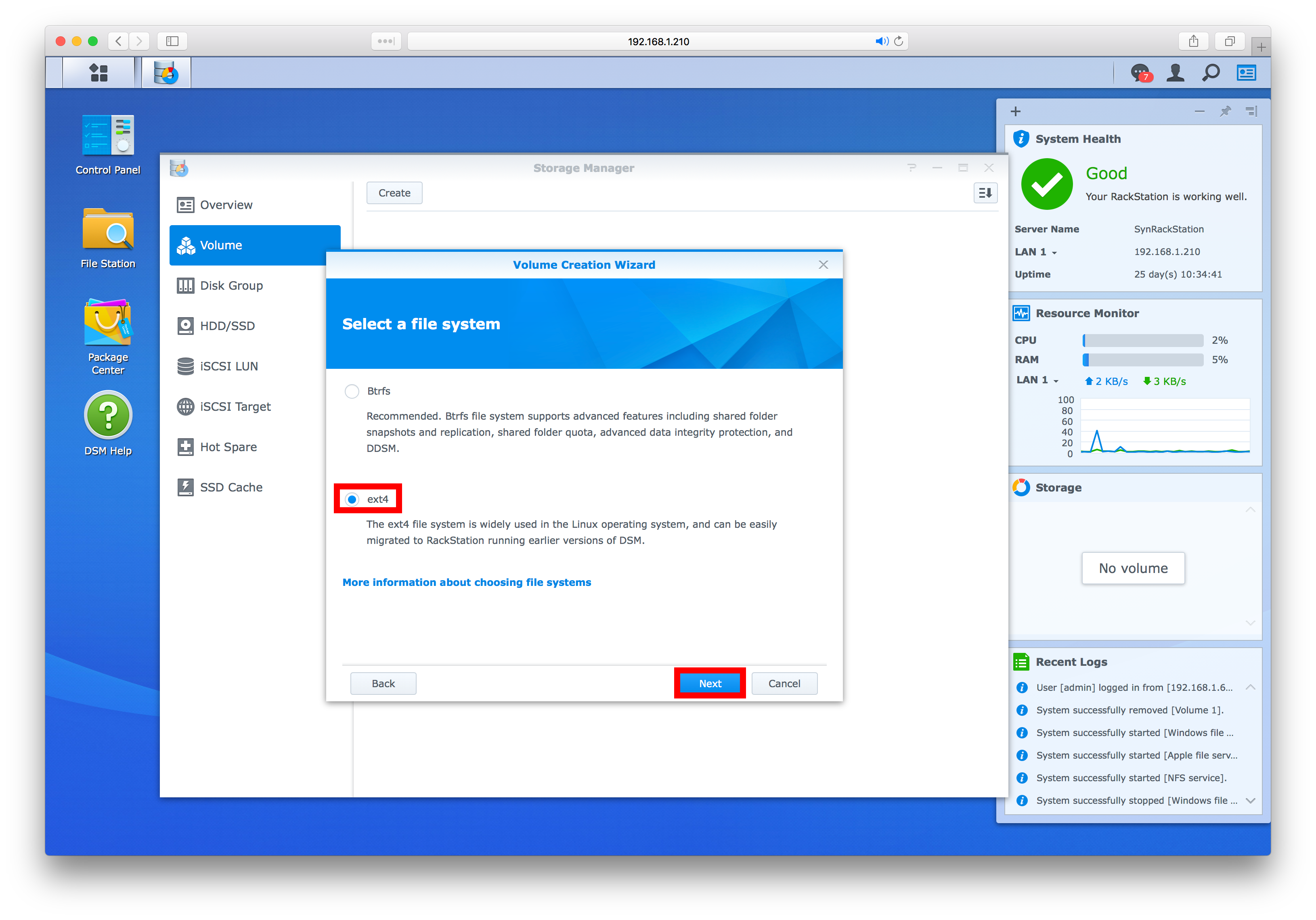

Step 8: Select the file system you want to save your files with, ext4 or Btrfs, and then click next (we recommend ext4 as it is the established standard)​

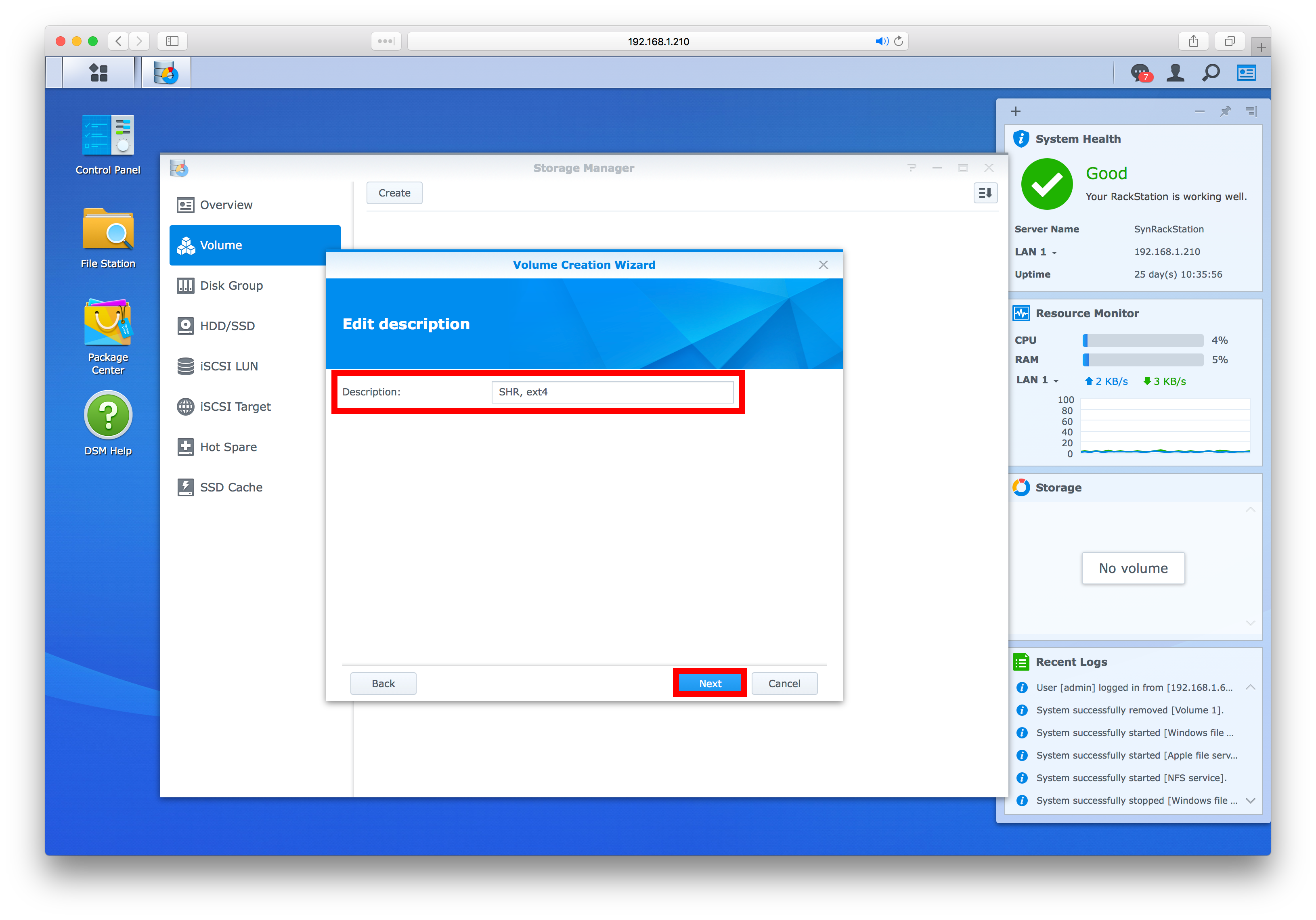

Step 9: Edit the description of the volume by giving it a name that relates to what you are going to use it for or just leave it as the default, then click next

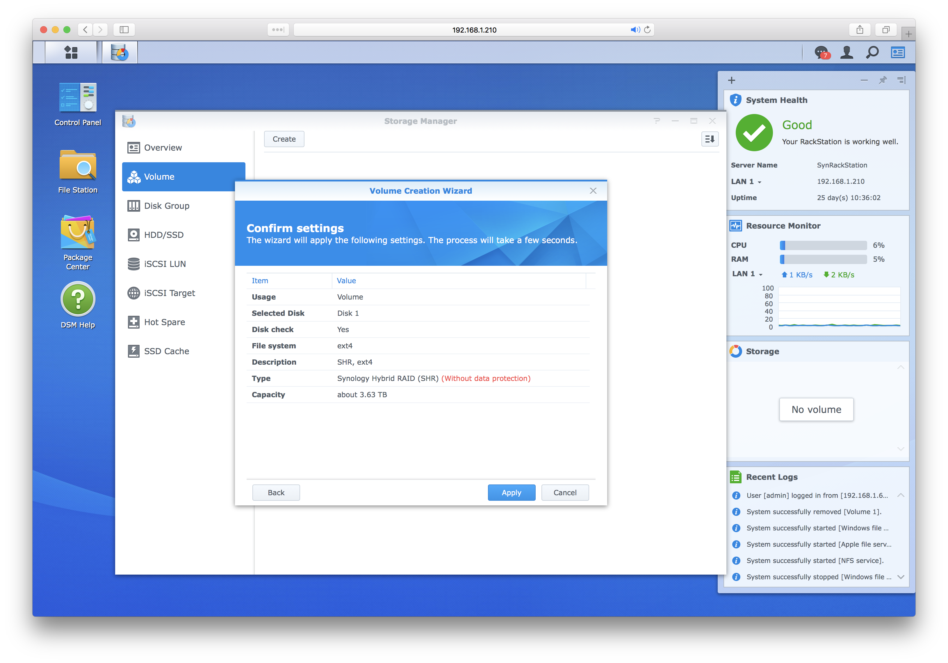

Step 10: Double check the settings you have chosen and then click apply

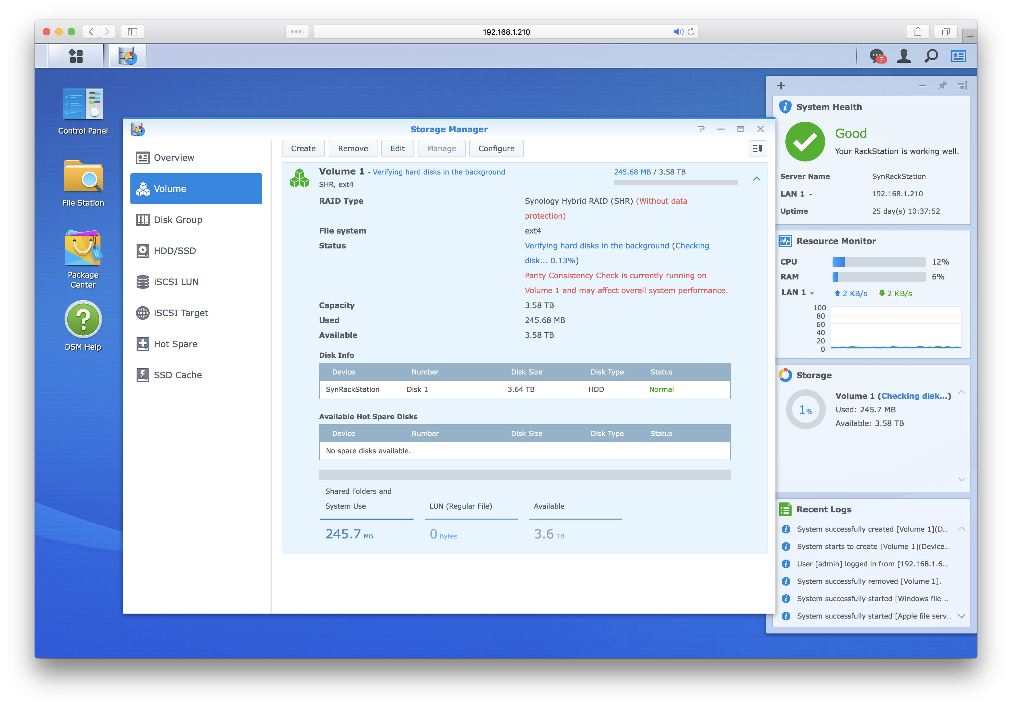

After a few seconds, you will be taken back to the volume page and the newly created volume be created and ready to be used for whatever storage you want
Be Aware that after creating a volume the NAS device will want to do a Parity Consistency Check which can take a while and can affect the devices overall performance while it completes the check
