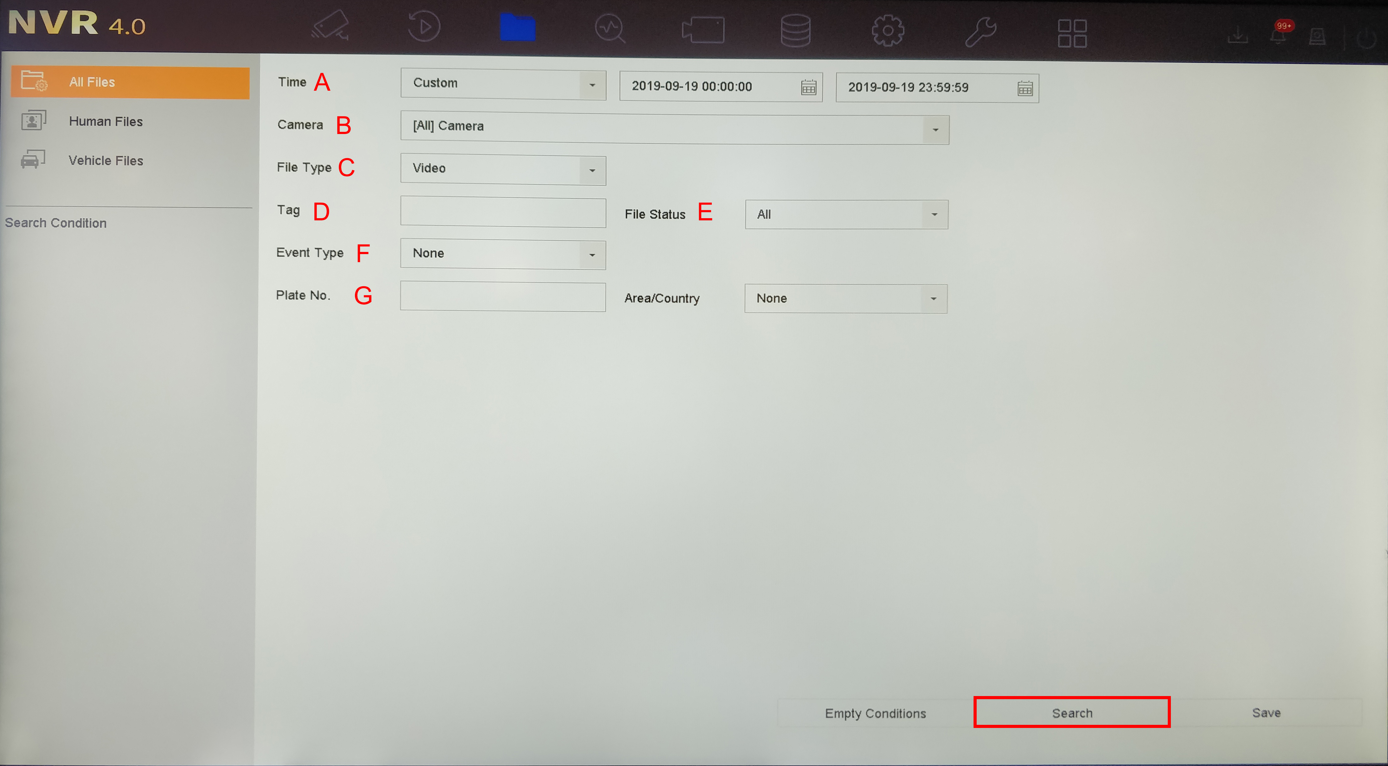

Step 1: Go to File Management and you should see a page similar to the one shown below
Step 2: Set your search parameters
Step 3: Click Search

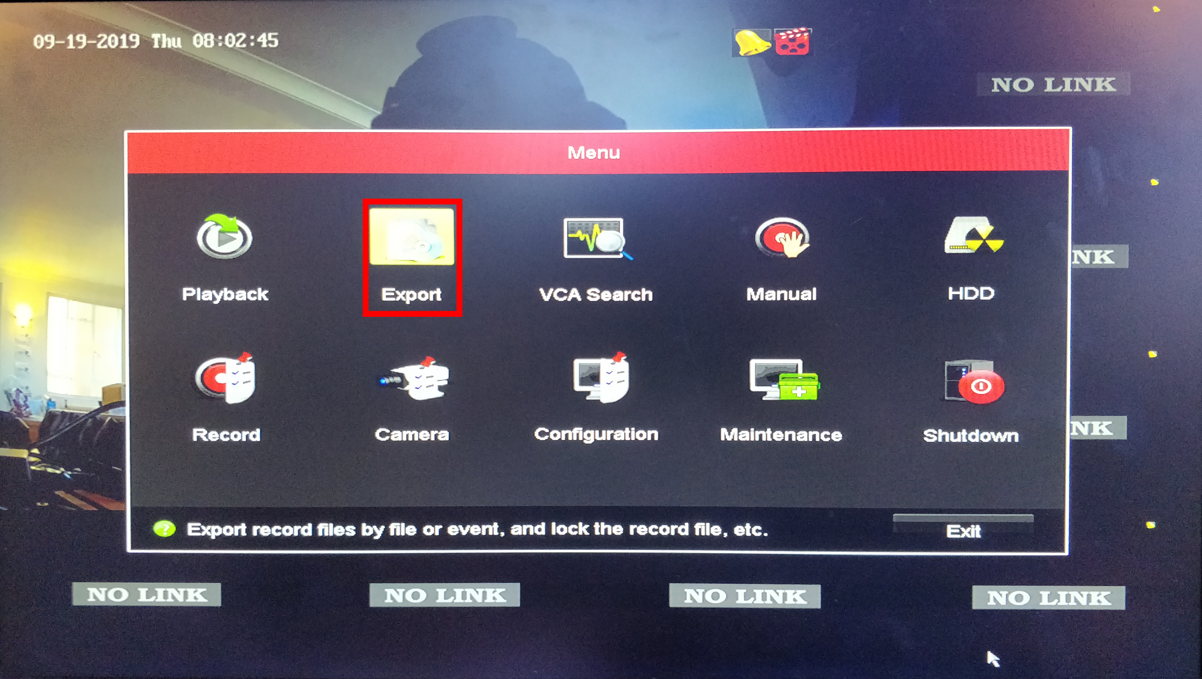

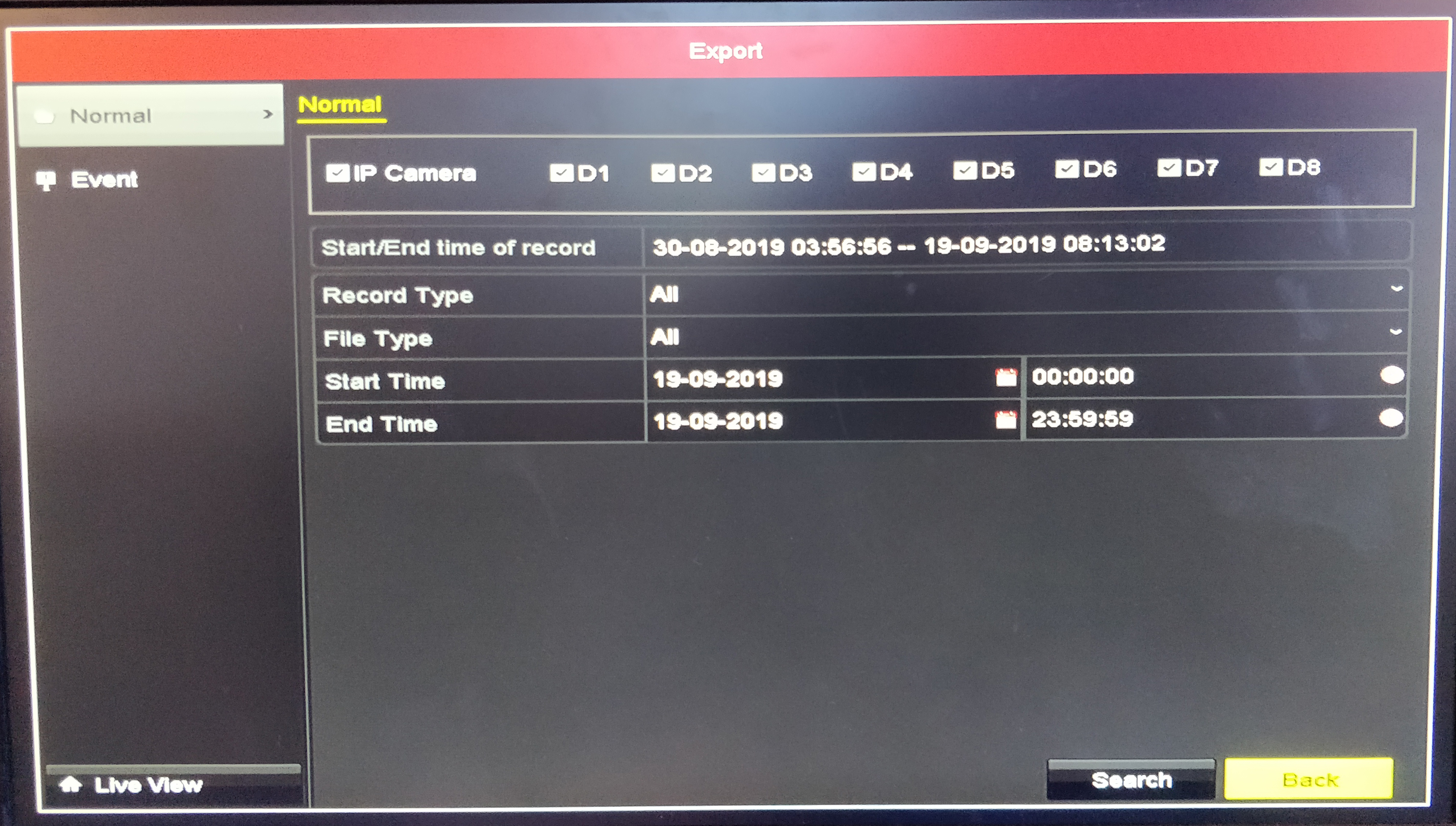

For the K-series NVR the process is similar but the menus are laid out slightly different, so instead of file management you will see a dedicated Export menu (see below) which will take you to a similar search page but on the K-series the search is split into 2 pages - Normal and Event.
Normal Export will let you search by how you had your recording schedule set, so if you had it set to continuous from 09:00 to 17:00 then you can select continuous as the record type and just be shown files from when you had continuous recording set within your chosen search window. (e.g. last 7 days) If you select All as the record type you will be shown all the recorded files within your search window, whether they be continuous, motion, event, or one of the other options.

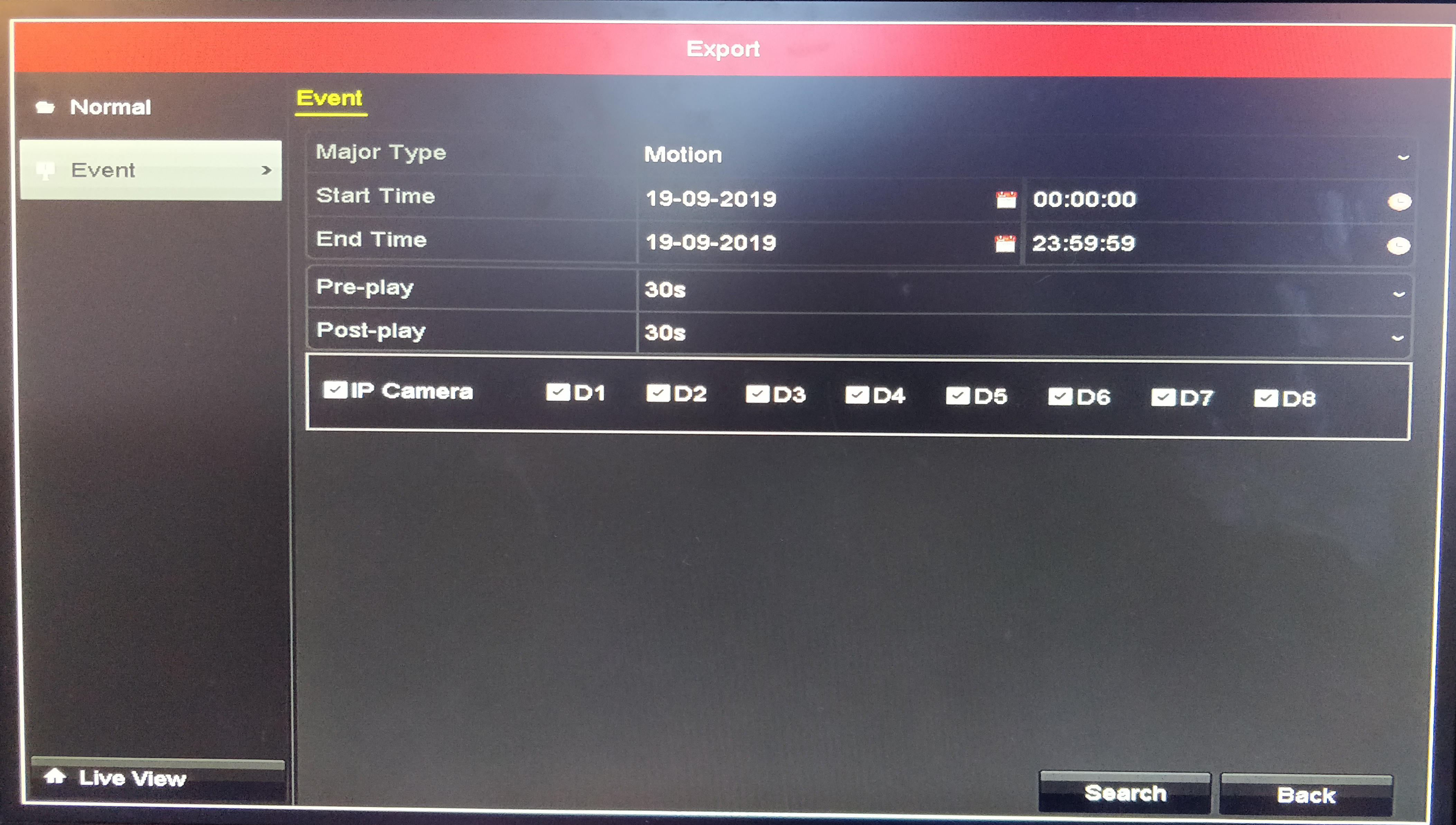

Event Export is like the Event Type drop-down on the I-series NVR and lets you search for Event triggers of any Smart Event that you have enabled on your cameras.
a) Time - this can be set as a custom time period or you can select a preset time period from the drop-down (e.g. last 24hrs, last 7 days, etc...)
b) Camera - by default all your cameras will be selected, if you don't want to export footage from all the cameras then open the drop-down, deselect 'all cameras' and the just select cameras you do want to export footage from.
c) File Type - here you select whether you want to search for videos or pictures
d) Tag - if you have tagged any files in the playback with a code, date or phrase you can enter that here to bring up all files tagged with that information
e) File Status - lets you select if you search for locked files, unlocked files, or all files
f) Event Type - if you want to only search for specific event clips then you can select that from the drop-down (the event you choose must have been previously enabled on the cameras you are searching), if you just want continuous files then leave this as 'none'
g) Plate No. & Area/Country - these are only functional if you are searching the recordings of an ANPR camera
