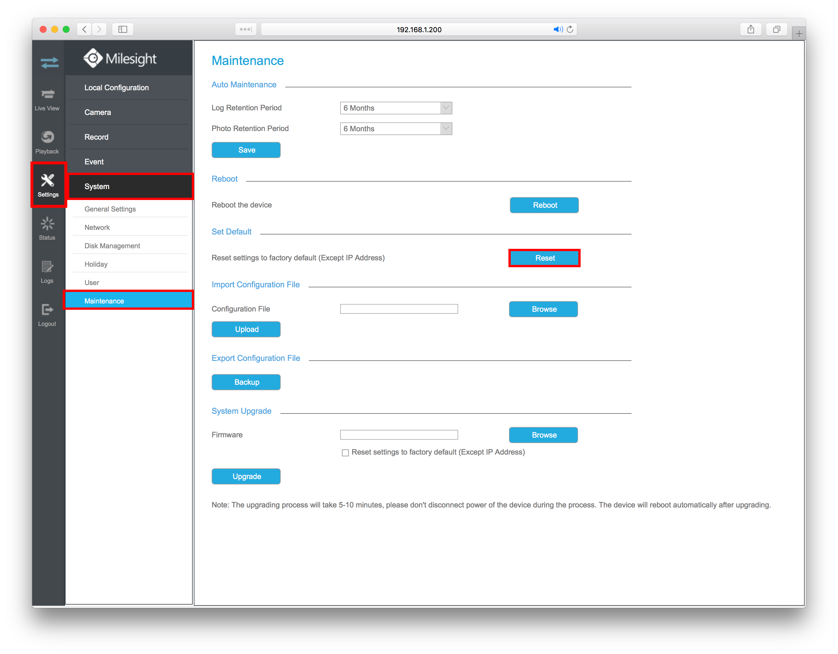

Factory Reset using a Browser
If you are having problems with your NVR but are still able to login to the NVR then you can reset or factory reset the NVR from its settings using a browser.
All you have to do is log in to the camera and click Settings from the main menu, then click the System tab to open the drop-down, finally click Maintenance from the drop-down and you will be taken to a page like the one below
You will see several sections each with their own header, look for the section labeled Set Default and click the button labeled Reset to start the reset process (this will involve the NVR rebooting and will take around 5-10 minutes). In the Set Default section, you will see that clicking reset will factory reset everything except the IP address settings, the IP address can only be reset when you do a physical reset using the reset button.

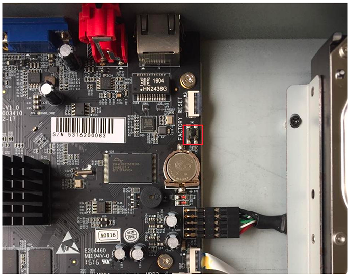

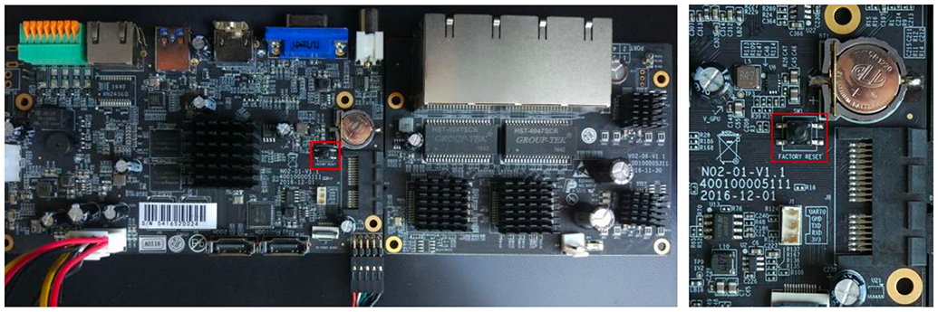

Physical Reset
If your camera needs to be reset but you can't login to it or it is connected to an NVR, then you will have to do a physical reset using the reset button on the body of the camera.
The steps for doing a physical reset are as follows:
Step 1: Turn the NVR off
Step 2: Find the physical reset button on your NVR (the position of the reset button varies between models, see the pictures below for where you can find the reset button on each model)
Step 3: Hold down the reset button and then, while holding the button down, turn the NVR back on (keep holding the reset button until the NVR stops beeping and starts making a continuous noise)
Step 4: Release the reset button and the NVR will begin to reset and reboot (it will take about 1-3 minutes for this process to be completed)
Step 5: Open Smart Tools and go to the NVR list, you should now see the NVR you just reset on the list but with the Milesight default IP address (192.168.5.200) - If this hasn't worked then try repeating the steps

Where to find the reset button
UI-1009-NA
UI-1009-PA
UI-50xx-B
UI-5016-PB
UI-70xx-B
UI-7032-PB
UI-80xx-B
