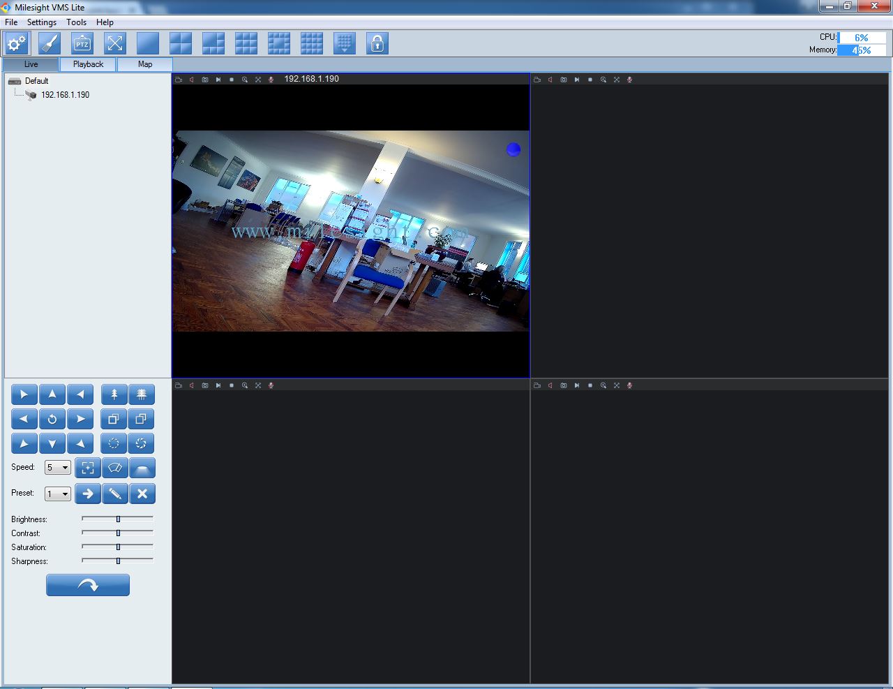

So let's start with VMS Lite, VMS Lite works in a very similar way to PC NVR software, so if you install it to your PC and plan to use the VMS to record your cameras, those recording will be saved to the hard drives of the PC you have the software installed on. So make sure to check, before you commit to using VMS Lite to record, that the PC you are using has enough storage. (we recommend having at least ONE dedicated HDD installed that is only used for recording your cameras)

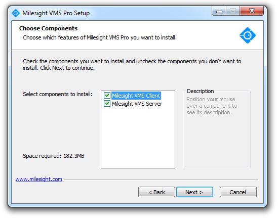

That brings us nicely on to VMS Pro, VMS Pro has a very similar structure to Lite, the main difference being that Pro comes in 2 parts, server software and client software, and you will be prompted during the installation process as to whether or not you want to install both the client & server or just one of them. If this is the beginning of your VMS Pro system you will want to install both (see below)
The Server/Client structure of VMS Pro allows you to create a much larger IP camera network as you can install the server software on multiple servers/rack PCs/NAS devices and have groups of cameras storing their footage to different servers, and the Client software can then be used multiple PCs to access all the storage devices with the server software installed, thus allowing you access to a much larger network of cameras (up to 256 cameras) than is possible with VMS Lite which can only store footage locally to the PC you have it installed on.

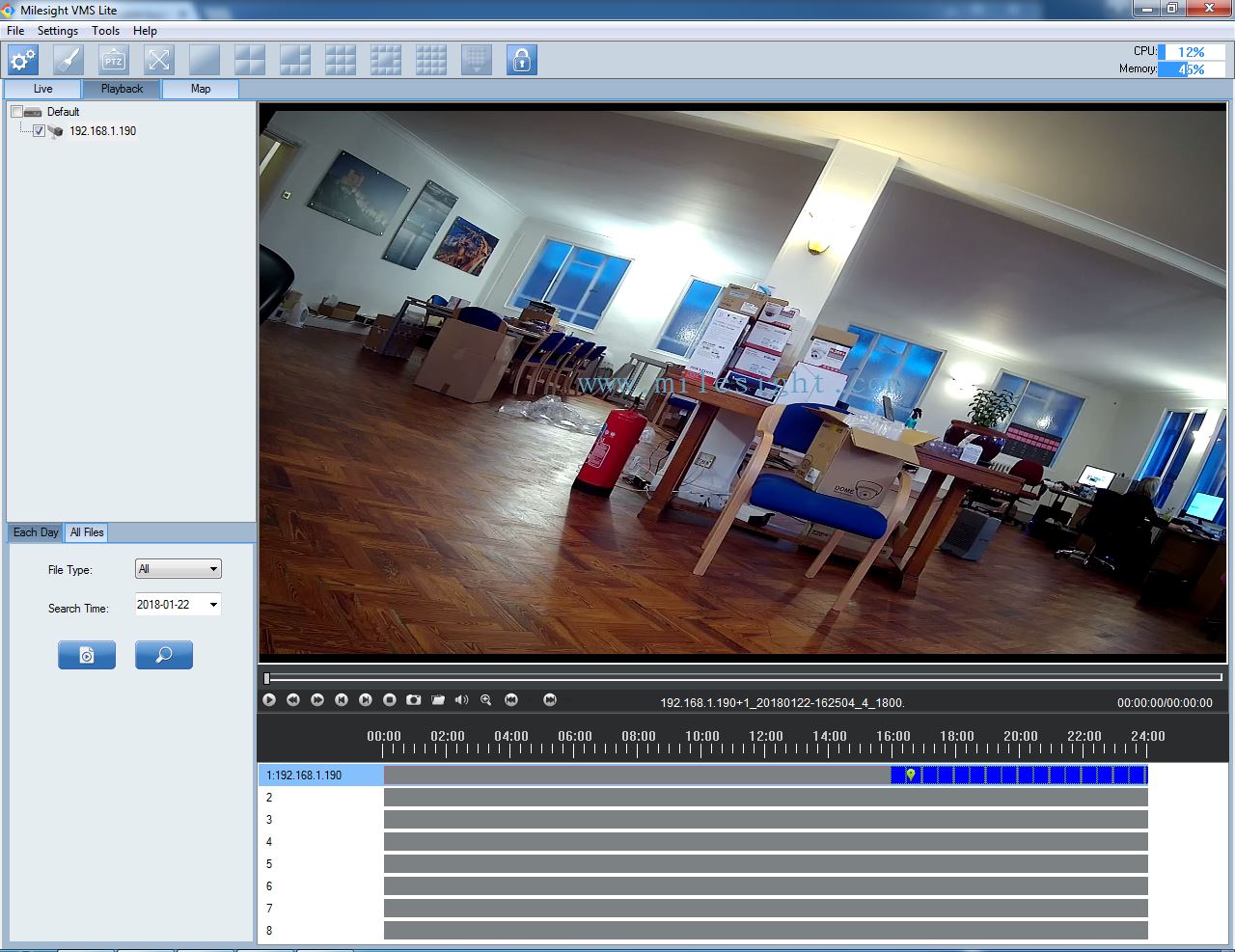

And finally, a feature of both VMS Lite and VMS Pro that you should be aware of is that although both versions of the software are free you will still need to activate the software with an activation code (which you can get from use-IP - see bottom of this post for more information on how to do this), if you don't activate the software the live view and recorded files created by the software will be stamped with a Milesight watermark. (see below)
