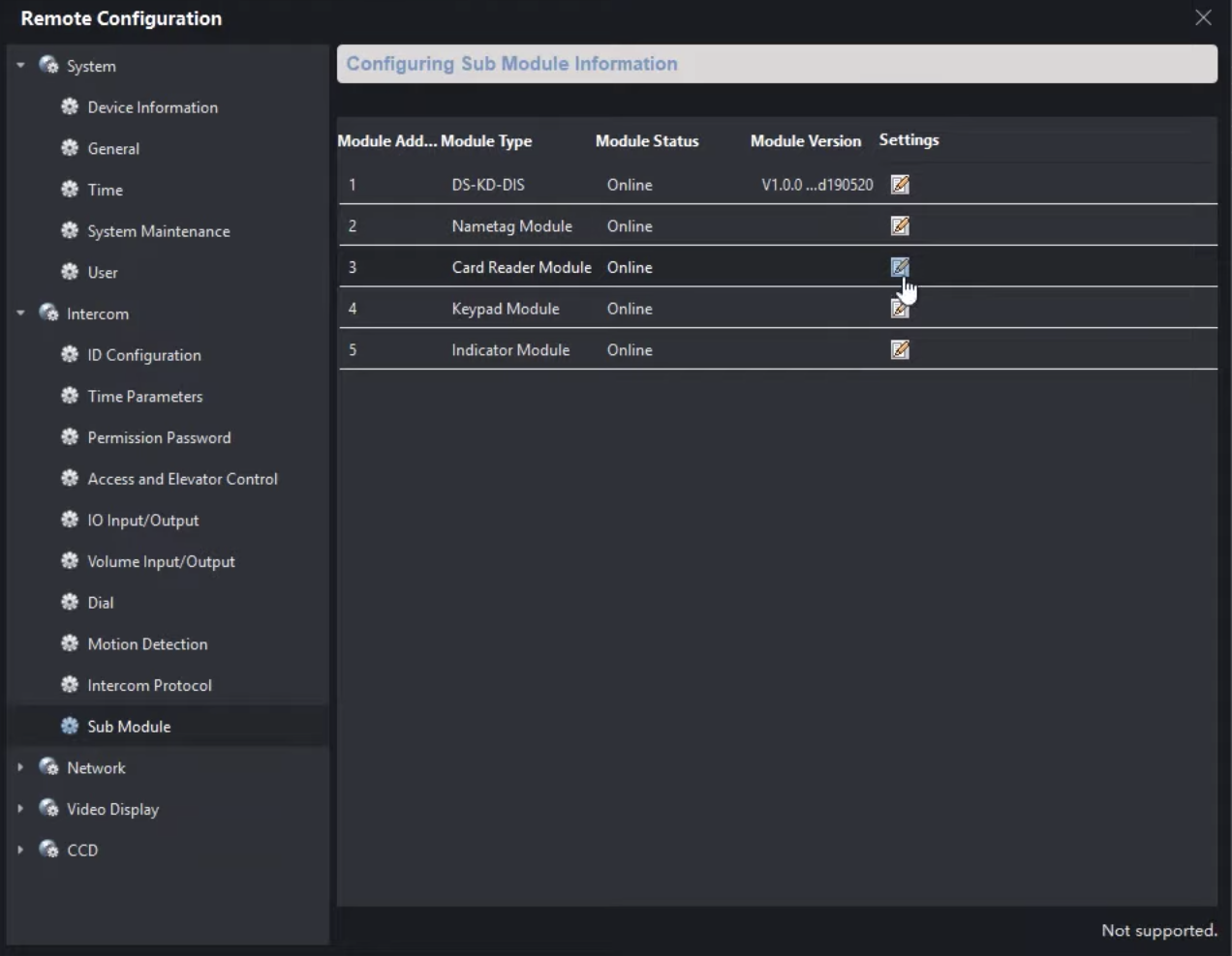

I have Hikvision DS-KD8003-IME1 with keypad DS-KD-KP. I have configured the system using iVMS-4200 but there is one thing which I haven't been able to solve. The keypad tone is somewhat annoying and I would like to disable it i.e. I would like to make the keypad silent. Any ideas how to do this?
Unfortunately, there are no settings for the keypad module, as you will see from the below screenshot you can access the settings of the sub modules using iVMS-4200 but only the display module (DS-KD-DIS / not currently available in the UK) and nametag modules have settings which can be controlled. The Card Reader, Keypad, Indicator modules have no settings which you can control, and when you do try and click settings on these modules you will see the message "Not supported" flash up at the bottom right of the window.
Not at the moment, it may be something they introduce as a setting in future firmware
