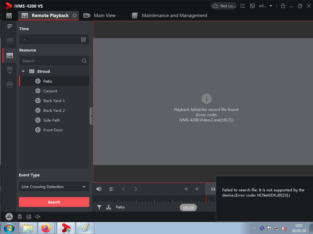

I've set up an All-Day Template in the Storage Schedule section of Maintenance and Management (iVMS-4200 VS) for my Patio cameras (for a test). This saves continuous video to the Storage Server, but I cannot see the events in the timeline when in the Remote Playback window. The continual video shows up as a light blue colour in the timeline , but I cannot see the events superimposed on top of this.
I can't seem to search for events in the Event Playback section of Remote Playback for some reason.
For instance, I select today's date (28/5), choose Line Crossing Detection in the VCA Detection drop down, press Search and I get an error message (see attached). I KNOW there are Line Crossing events (and Intrusion Detection events) from the Patio camera today, but I cannot seem to search for them. It doesn't matter what camera I select, it comes up with the same error.
How do others manage to search for events when using continual recording?

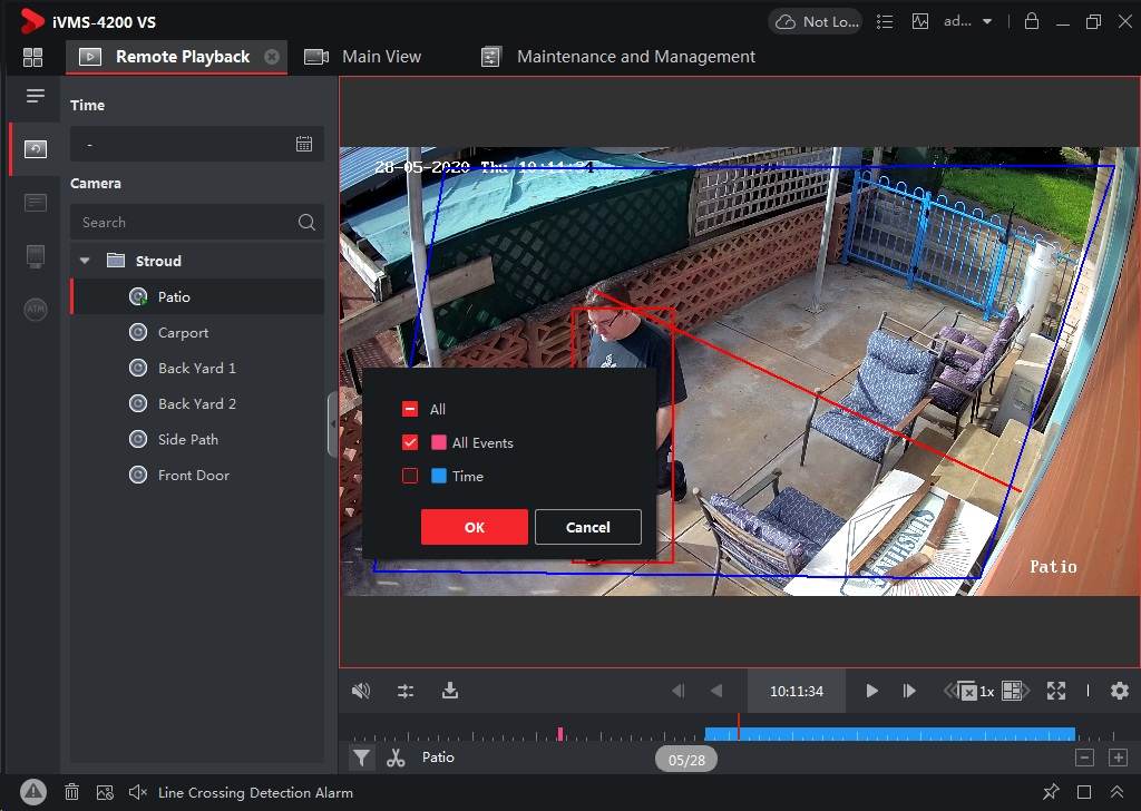

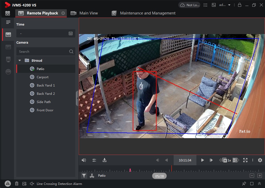

I have attached three screen captures of what I am seeing. The first is during a time I was using an All-Day Template in Storage Server for a test (the light blue in the time line). You can see me creating a Line Crossing Event. I then deselect Time the Filter Tool... but in the same part of the timeline, the Line Crossing event is not there!
During the time of the All-Day Template testing was being used on the 28th, I must have created dozens of Line Crossing and Motion Detection events, none of which seem to have been recorded/saved on the Storage Server. Having days and days of recorded video and not being able to see the events in not good at all.

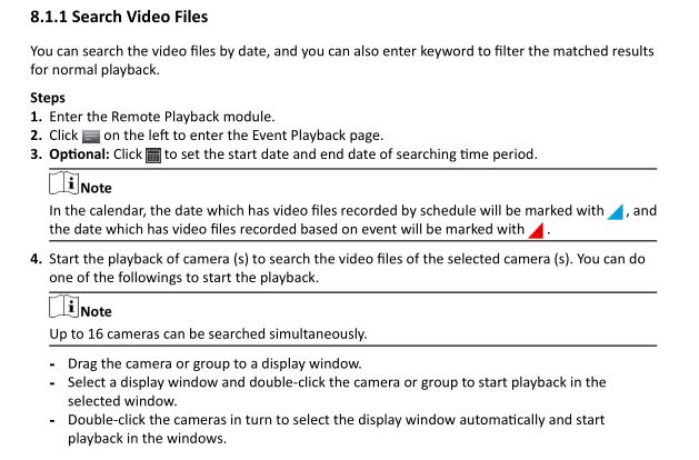

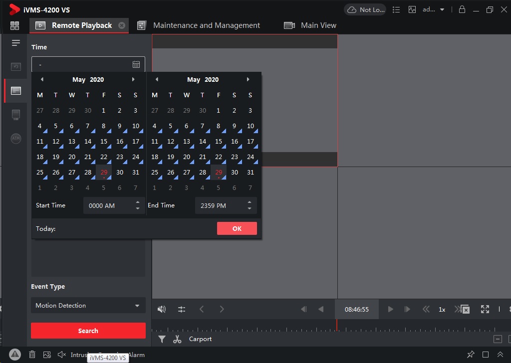

The other strange thing I don't quite understand is that when I go to search for events (as above in Remote Playback Module/Event Playback Page) and click on the calendar to select the dates... the days have light blue triangles in them.
The iVMS-4200 VS manuals states that dates which has video files recorded by schedule will be marked with a light blue triangle, dates with video files recorded based on events will be marked with a red triangle. No mention is made of what you see if a day has video files with both Schedule based and Event based files in it.
Apart from the short testing I did a few days ago, ALL of my video files have been recorded based on Event Detection (Basic and Smart). Why don't I see any red triangles? Why are the detected events on my cameras not recorded as events?
Could it be that Schedule recording and Event recording are mutually exclusive? When I play back video in Remote Playback/Camera Playback, the timeline is littered with red Event recordings (not blue as you get with Continuous recording), but the calendar once again only shows blue triangles. Confusing indeed!
