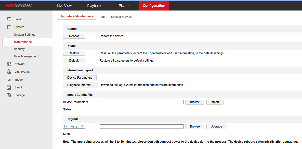

We would recommend that you also check for and update to the latest available firmware for your camera model:
DOWNLOAD PORTAL
See also:
How to reset a Hikvision camera to factory default settings via your browser
