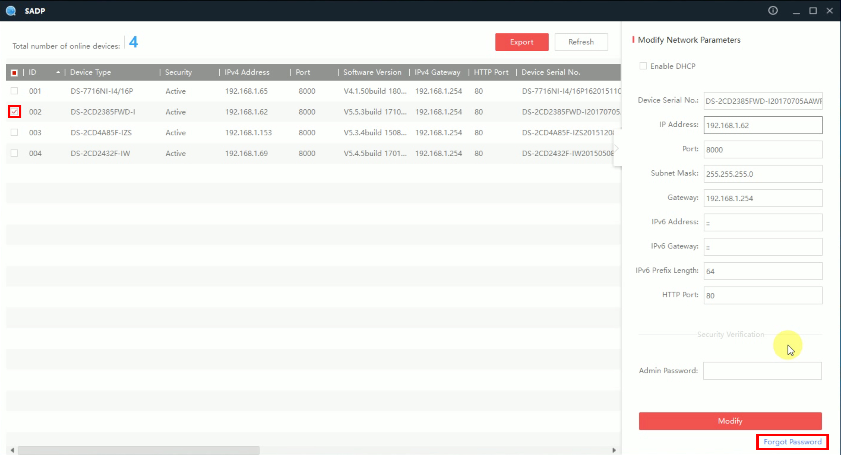

Step 1: Open SADP and select the camera/NVR you want to reset by ticking the box next to the device on the left side of the list and then click the Forgot Password link at the bottom of the pop-out tab on the right of the SADP window.

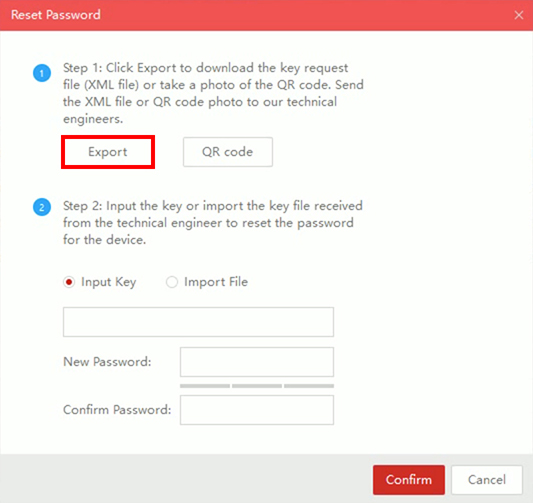

Step 2: Click the Export button on the pop-up to export the reset file and then select a folder to save the file to that is easy to find

(IMPORTANT: Once you have exported the reset file the camera/NVR you are resetting must remain powered ON until the reset is complete)

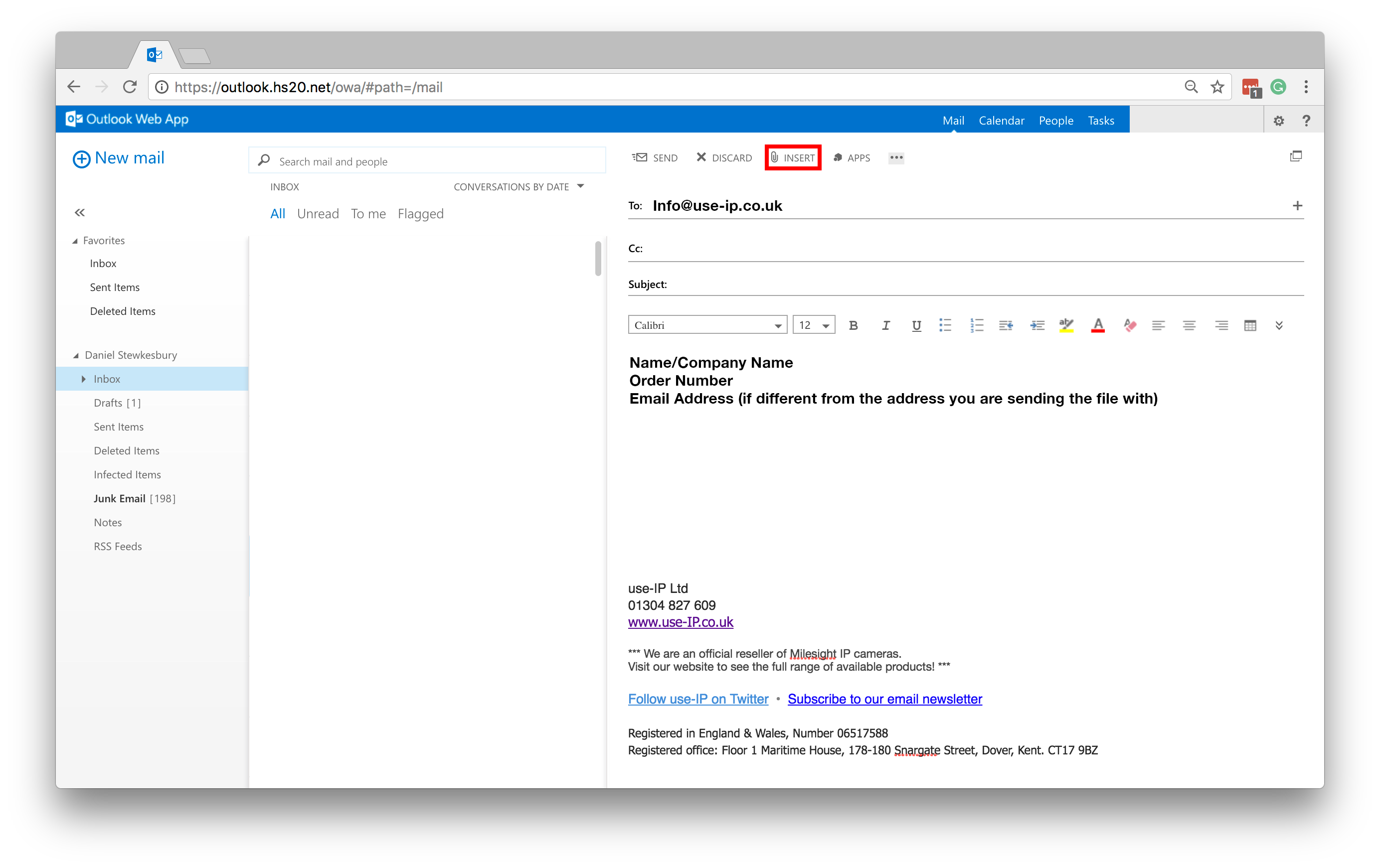

Step 3: Open your emails and attach the reset file to a new email, send this file along with the information listed below to info@use-ip.co.uk --- (We will only perform password resets for customers who bought the device they are resetting from us - use-IP Ltd - If you didn't buy from us you will have to send your reset file to the company you did buy from)
After sending the file to us we will confirm you have bought from us and then pass the file on to Hikvision tech support who will then send a reset file to change the password, which we will then email back to you. This series of communications with Hikvision can take up to 24 hours, but often Hikvision support respond much quicker than that

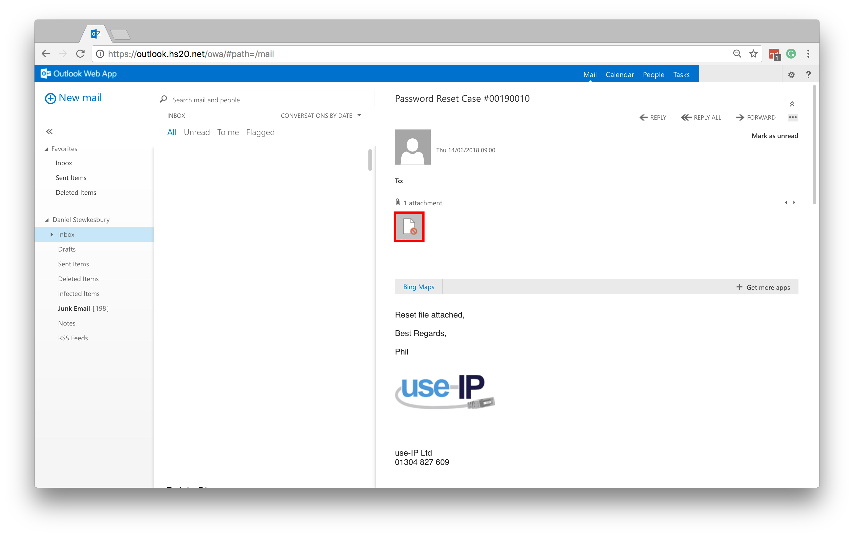

Step 4: Download & save
the new reset file from the email you received from us to an easy-to-find folder (we would recommend the same folder as the original exported file)

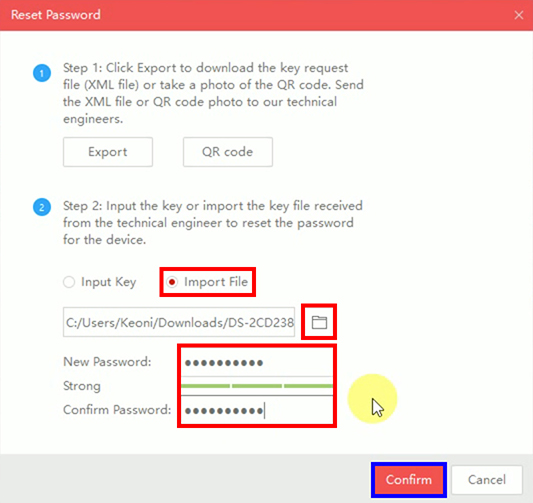

Step 5: Open SADP and return to the export pop-up from before, this time you will want to go to step 2 and tick the Import File box, then click the folder icon and find the reset file we just sent you, open it so file route appears in the box like below, finally enter the new password twice and then click Confirm

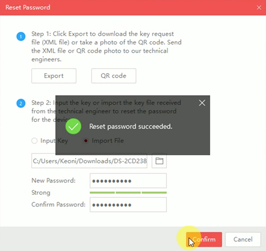

After clicking confirm a box should appear with a green tick and the words Reset Password Succeeded
