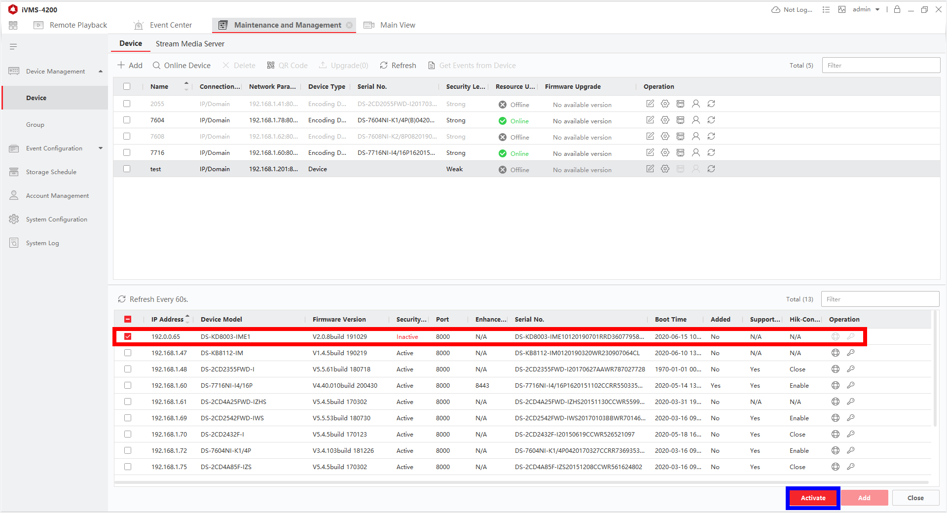

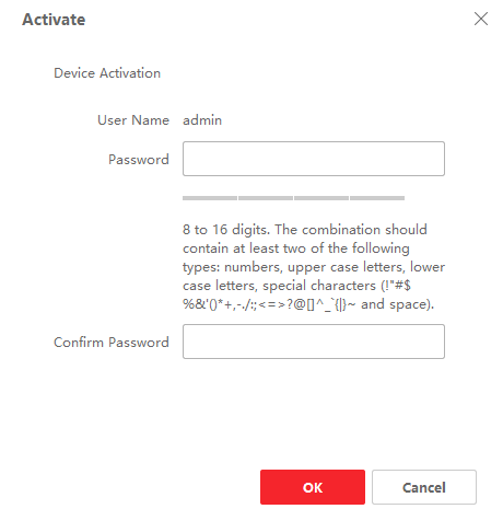

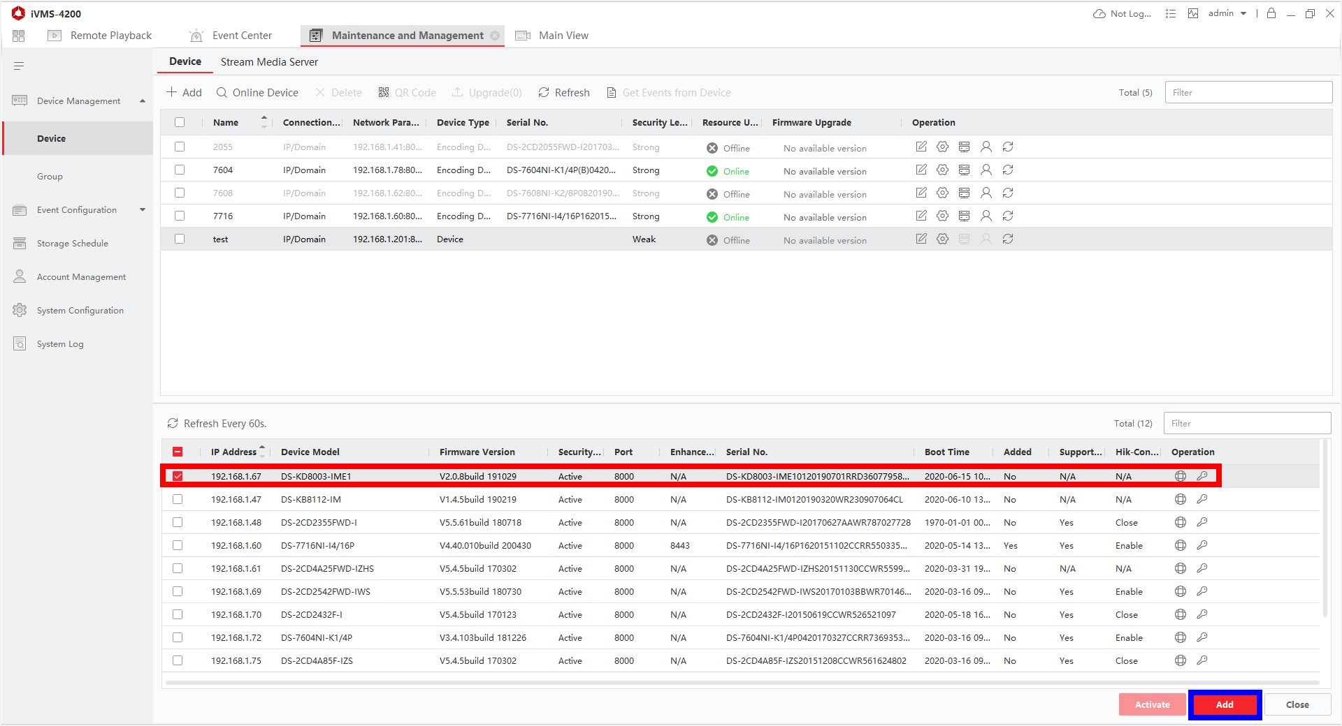

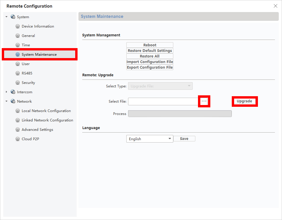

- Setting up the Video Intercom Module

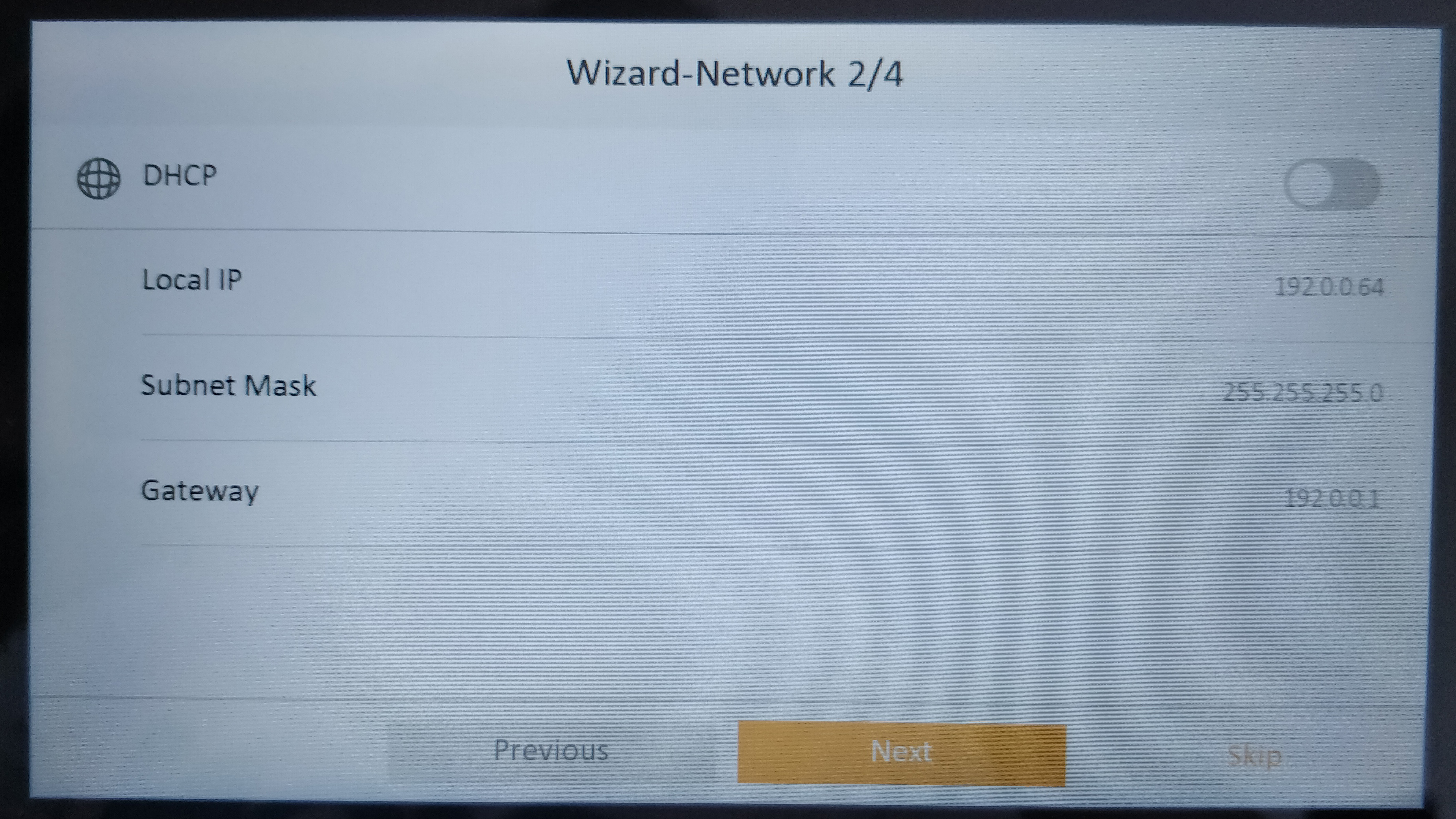

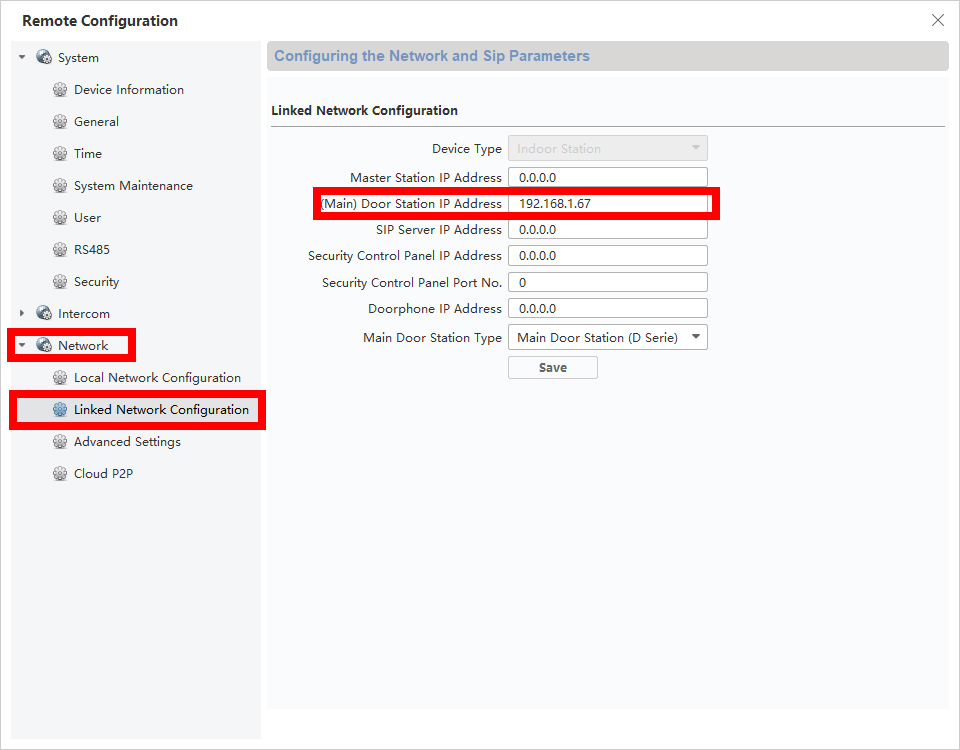

- Setting up the Indoor Station

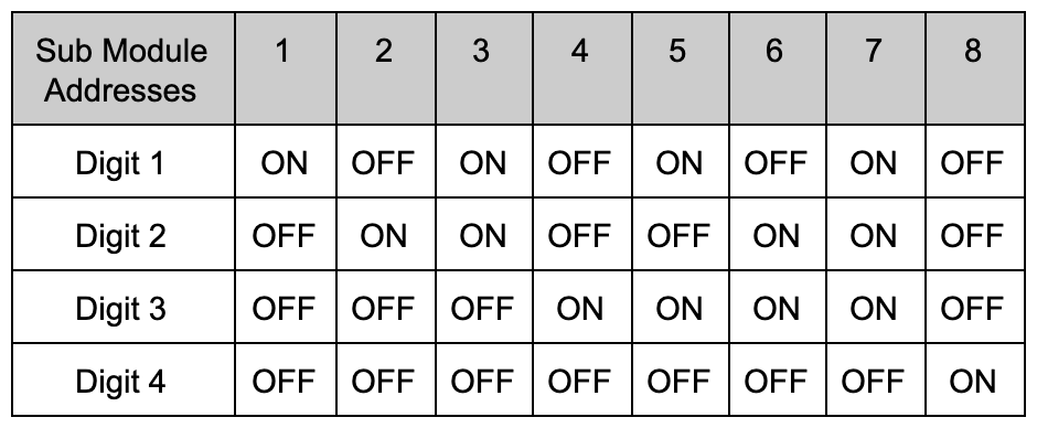

Three Module Setup (Video, Indicator, Keypad)
- Sub Modules & Dip Switches
- Setting Room Numbers & Unlock Codes
