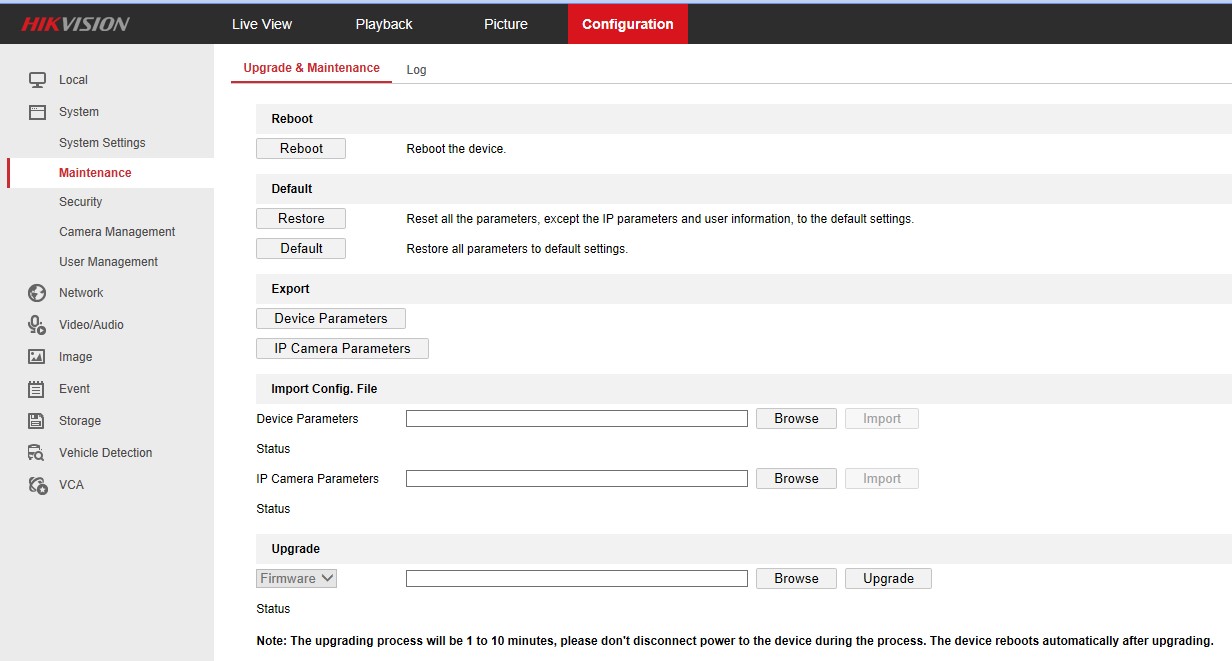

Step 5: Login and navigate to Config -> Maintenance (screenshot attached below)
Step 6: Scroll to the bottom of the screen you’ll see Upgrade Firmware.
Step 7: Click the Browse button at the right-hand side.
Step 8: Browse to and select the digicap.dav file in your C:// drive
Step 9: Click 'Upgrade'.

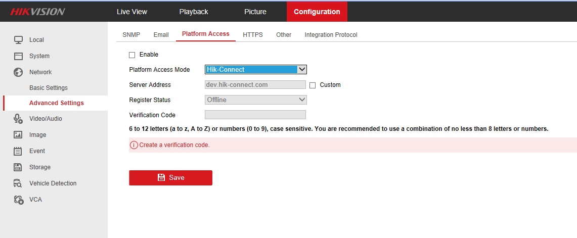

This is from a different model NVR, but you should see something like the below to enable Hik-Connect access:
