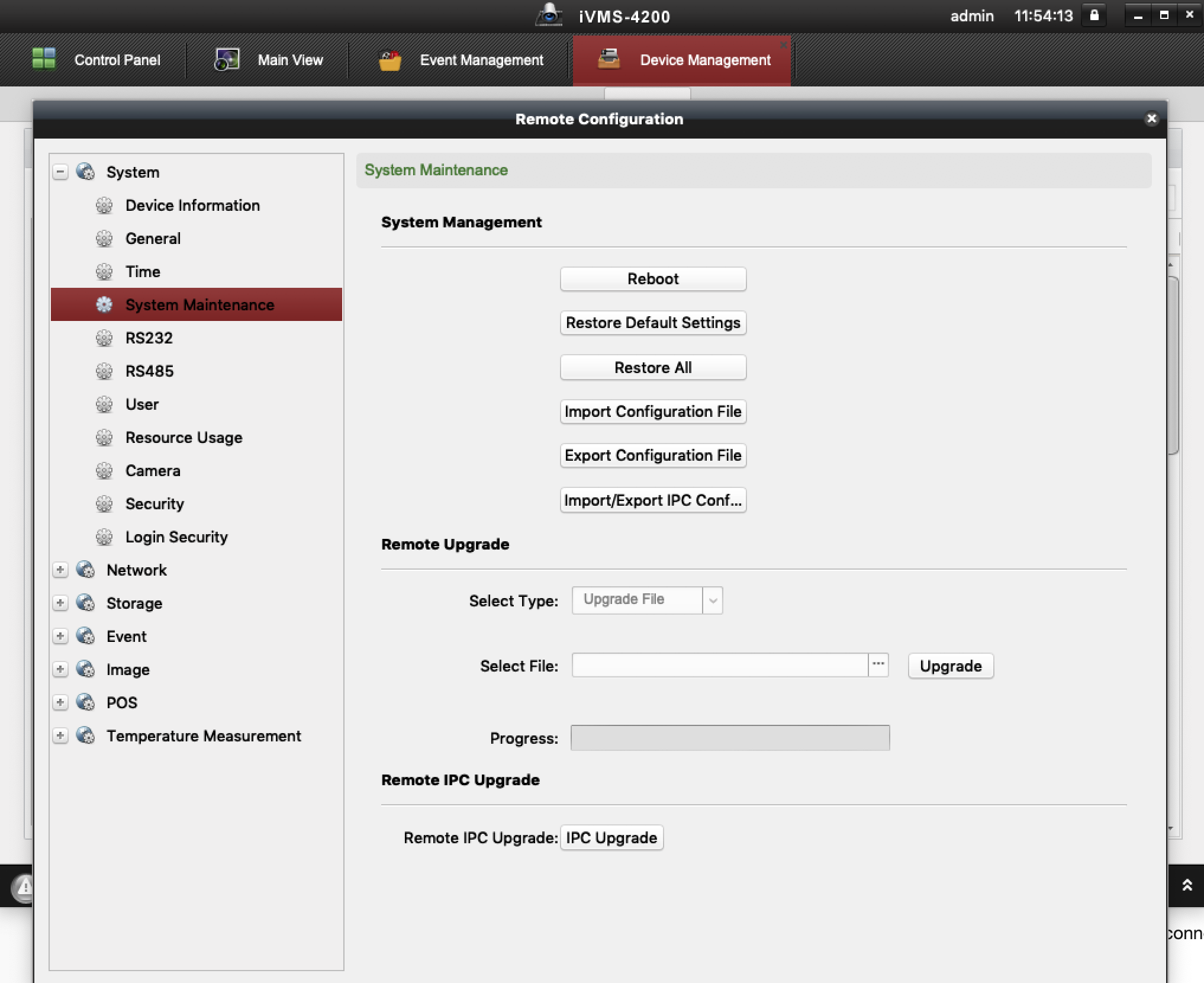

The K-series NVRs do not support the 'no plug-in' update that was given to the latest I-series NVRs and so with a Mac browser access is limited and you may have to install an older 3rd-party browser like SeaMonkey that still runs the old NPAPI plugin that the K-series NVRs use. You should still have full access via iVMS-4200 and a direct monitor, and as another option, you can update the firmware of the cameras using iVMS-4200. Go to Device Management > Group > Select a camera > Remote Configuration > System > System Maintenance > select a file and upgrade.
