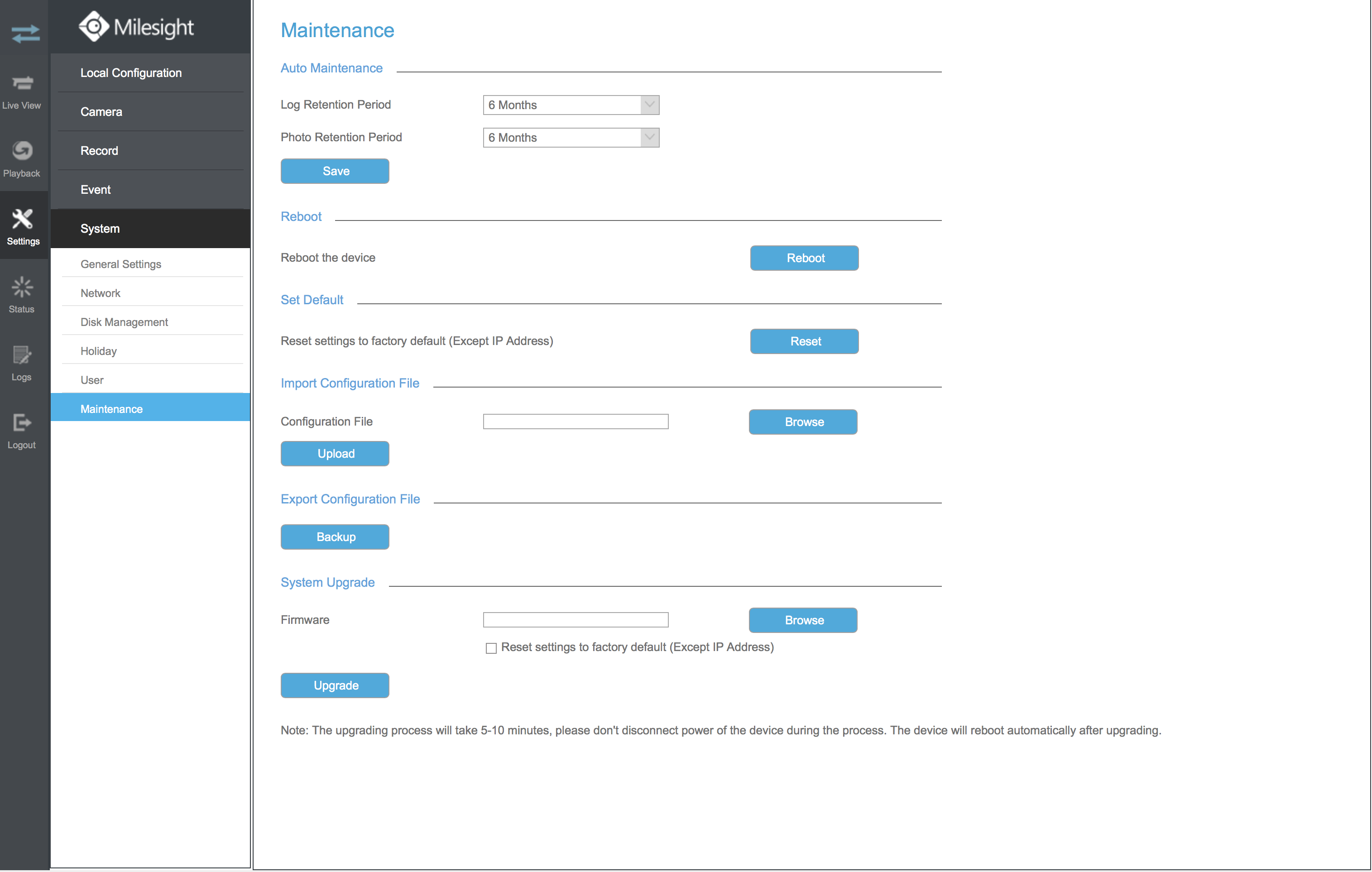

If you need to update the firmware of a Milesight NVR the steps are almost exactly the same, the only difference is Steps 5 & 6, with NVR when you log in you will want to click 'Settings' from the menu on the left of your browser window. A secondary menu will then appear and you will want to click the 'System' tab at the bottom of the list, a final menu will appear from which you will pick the 'Maintenance' tab which will bring you to a page very similar to the camera maintenance page, the only difference is that the "browse" button is at the bottom of the page, not the top.

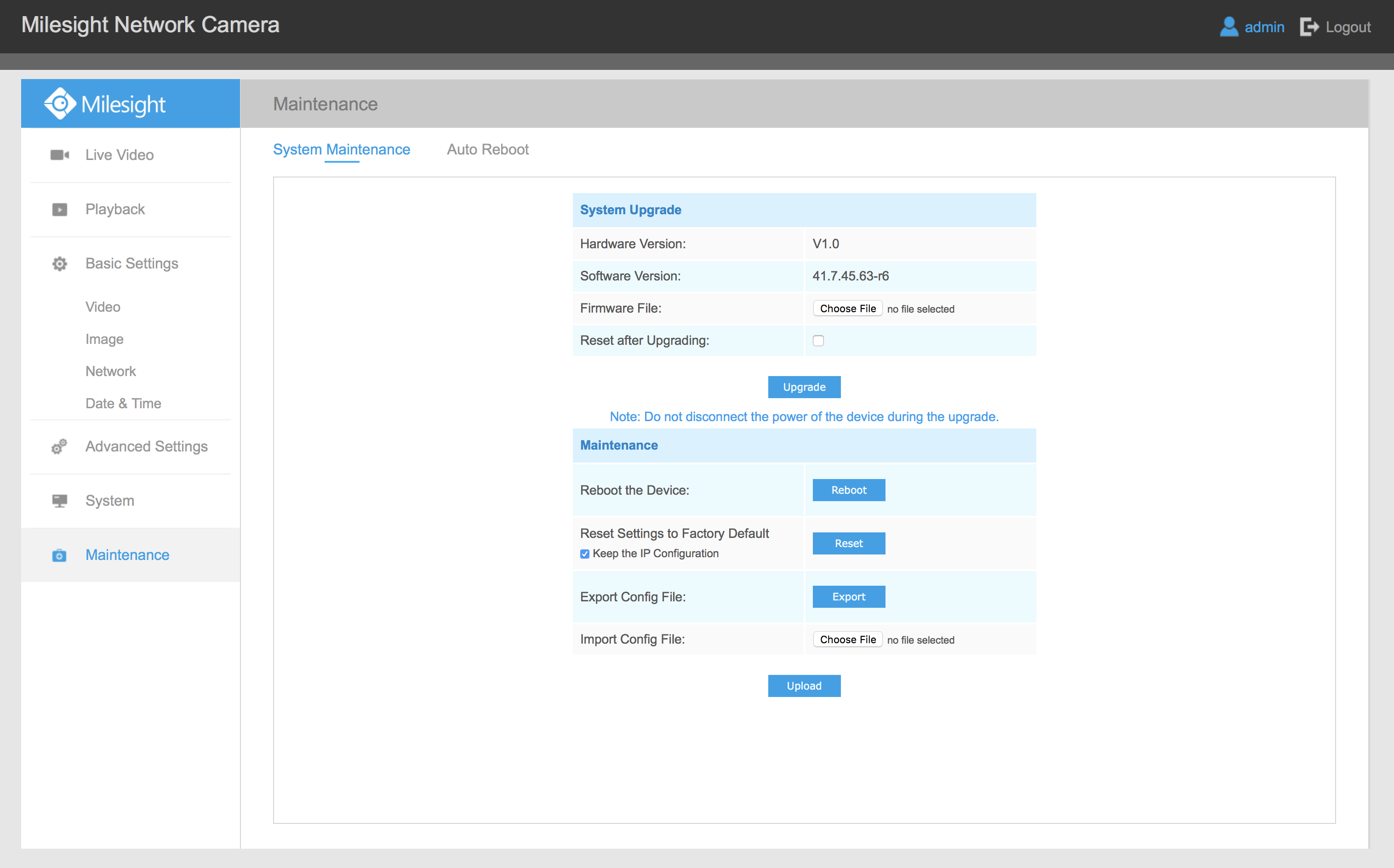

See below a screenshot of the System Upgrade page when you log in to a camera or NVR via browser:

Step 5: Click Configuration and then open the Maintenance tab
Step 6: Click the "choose file" button (3rd from the top under the 'System Upgrade' header) and navigate to the folder with the firmware file
Step 7: Select the firmware file and then click the Upgrade button (Do NOT tick the 'Reset after Upgrading' box unless you are happy with all your settings to be returned to default)
CAMERA
NVR
