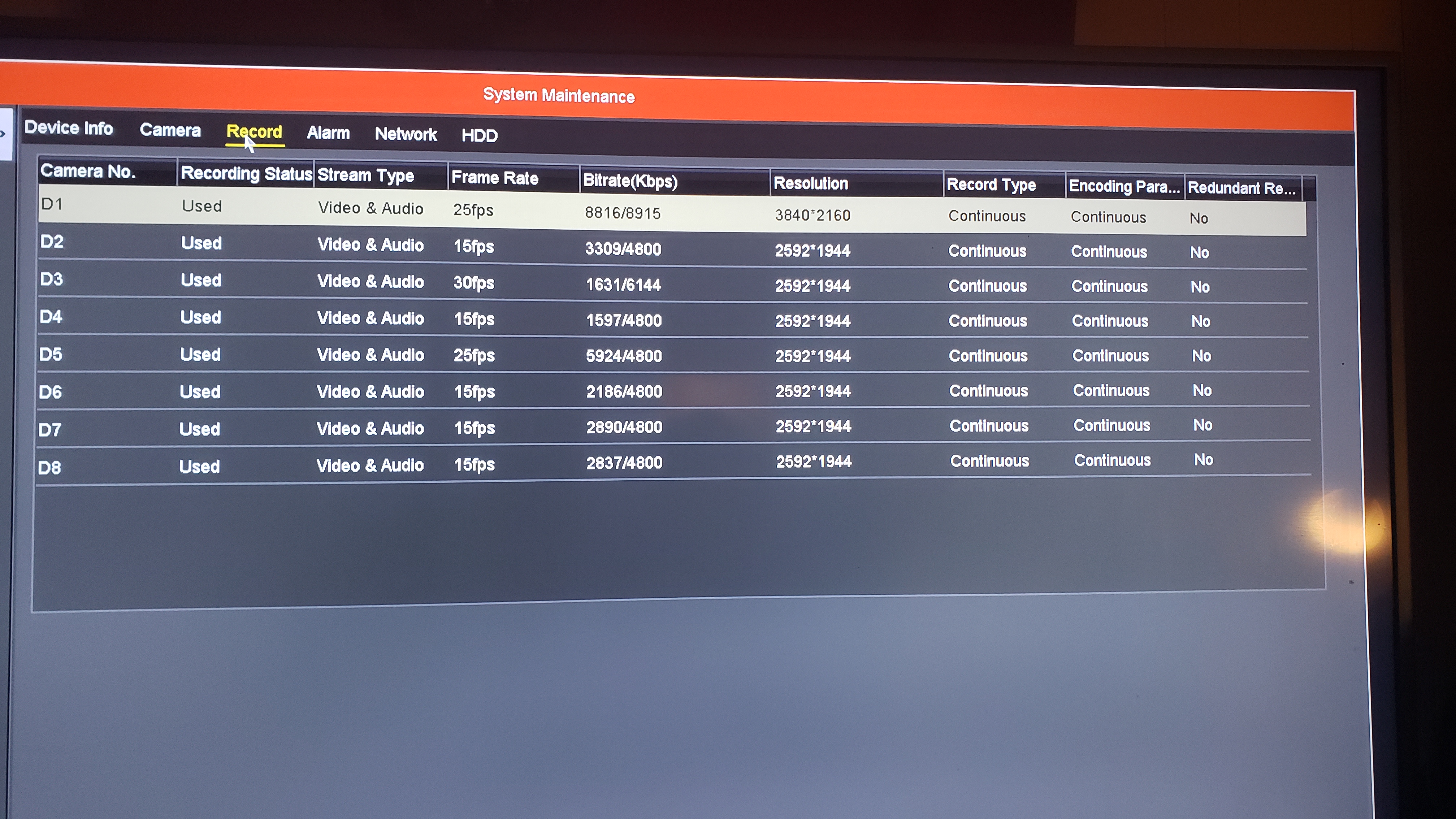

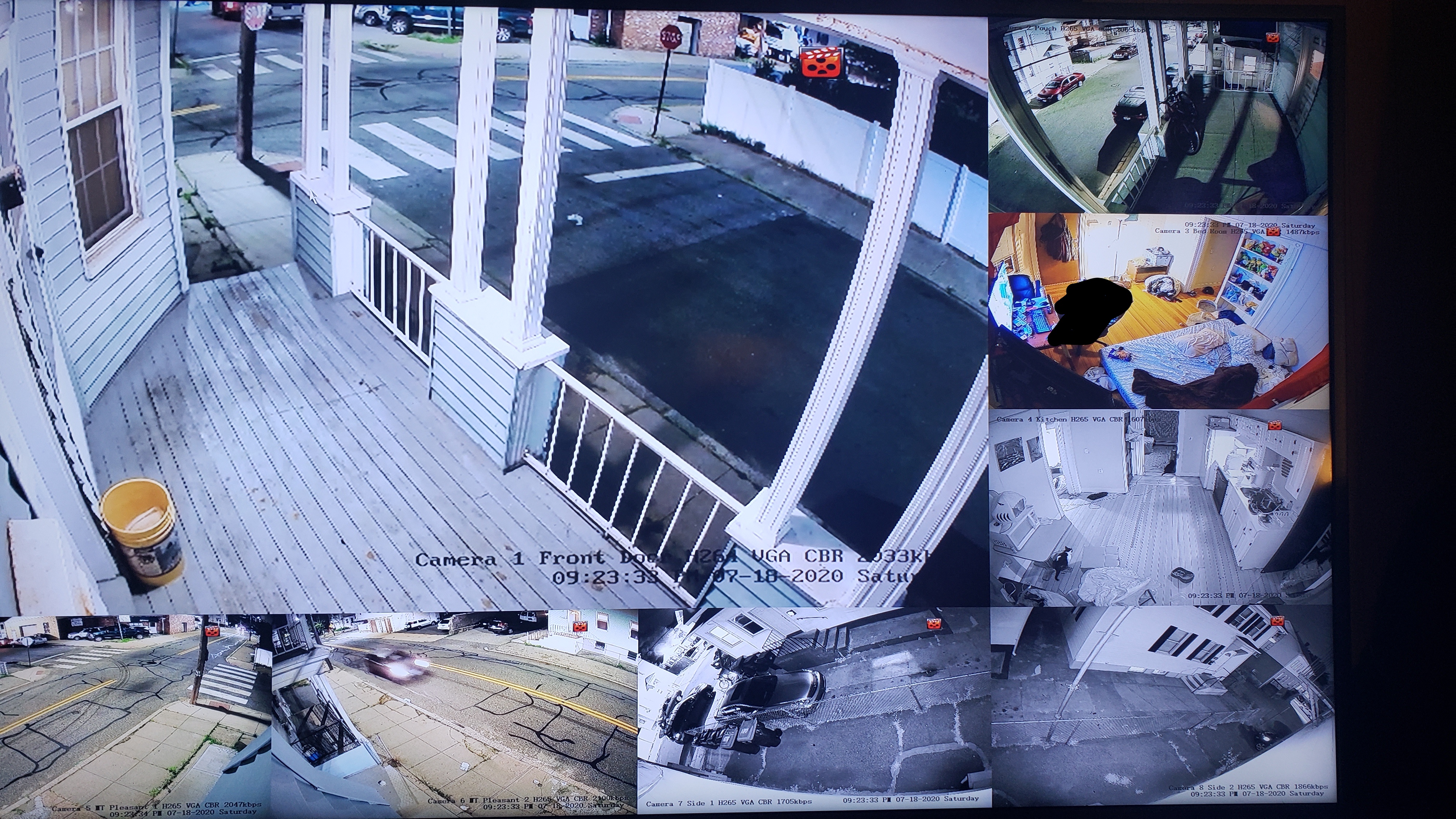

you guys are definitely using your systems wrong because i have 1 8mp and 7 5mp's connected and they all work just fine
the k1 can decode up to 1 at up to 8mp res. and up to 4 @ 1080p res for live view. i run the live view with all sub streams and single view full stream.
play back is pretty much single maybe 2 or 3 of the 5mp's cams. if you want to view more i use the ivms 4200 client. and playback is all at full main stream
sub stream should be auto your default for when you add and connect hikconnect as basic and hd are the only you get thats full stream and sub stream max setting on nvr is VGA pretty much like your main 7+1 view deal.
your sub streams are for remote viewing your main streams are for recording and every event. main stream max bit rate might be same or higher then event cant be higher as main its just still going to record the max of the main stream so cant do 4500/8000 but you can do 8000/4400
