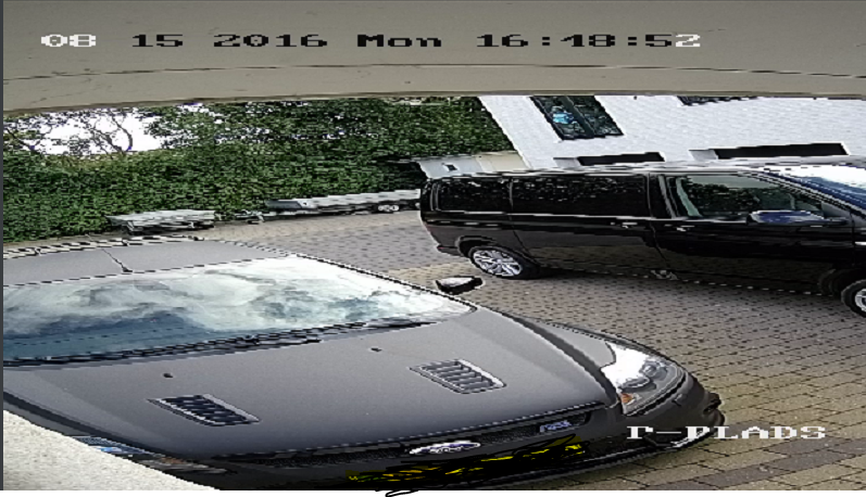

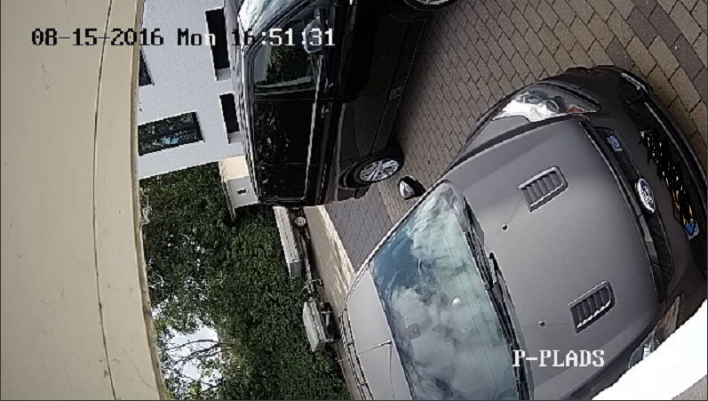

Hello. So i just bought those hikvision cameras.
Some of them has to be rotatet so that the picture looks right, and not sideways.
But when i turn this rotate button on the picture looks very bad...
I have attached some pictures, with and without rotate.
So does anyone know why this is happening and a solution?

Essentially, due to how the camera is currently mounted, digitally rotating the image will change the aspect ratio quite heavily. Based on your Synology comment, I imagine this is why you're experiencing the issue as Synology will try to squash the image to 1920 x 1080 despite the aspect ratio of the image, unless you click the fixed aspect ratio ben.
As an example, based on the resolution of those images I'd hazard a guess that you're using a Hikvision 3MP camera. This has a resolution of 2048 x 1536. When you rotate this resolution using the software (often called corridor view), you'll end up with a resolution of 1536 x 2048 which is causing your squashed image.
Your best option would be to physically rotate the camera lens as per our video on the DS-2CD2132F-I on youtube.
