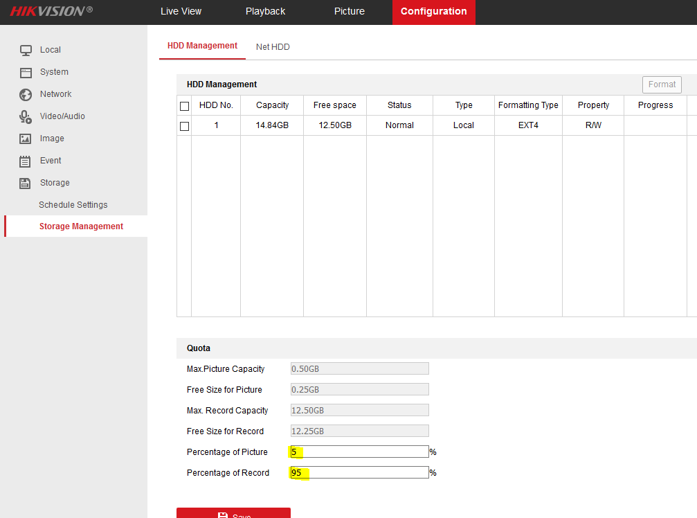

In Configuration>Storage>Storage Management, check the Percent of Picture is set correctly. By default it's set to 5% which might explain the limited picture capacity. If you are not recording video, up it to 95% and set Percentage of Record to 5%.

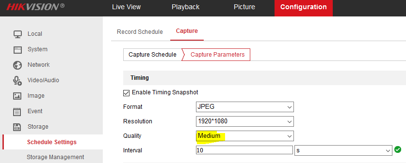

Just to clarify, is this how you set up the capture interval? If so, try setting the quality to medium or low and check if that helps.

Yes, those settings are ok. I have not yet tried medium/low quality, but...
