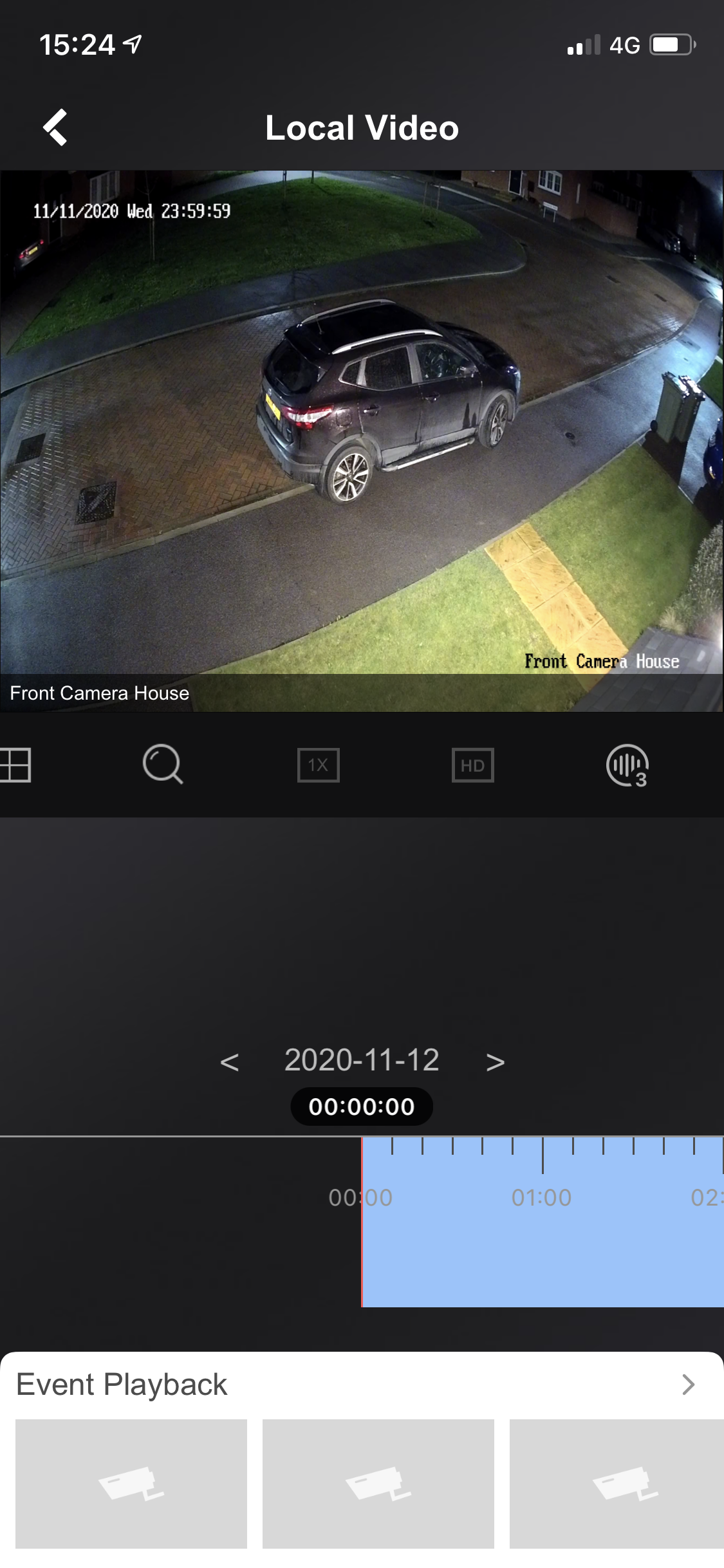

Thanks for the quick reply
my quality button is greyed out and stuck on HD. Is this a port forwarding issue maybe?

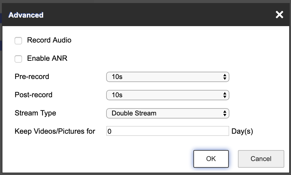

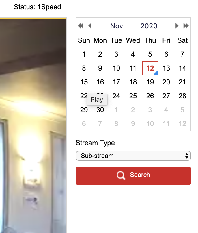

What we have found when looking at the recording schedule settings for our demo 7716NI-I4 NVR is that under the advanced settings you can select the stream type which the camera uses to record and this can either be Mainstream, Substream, or an option we were not aware of is Double Stream which when you set it can allow you to switch between mainstream and substream when viewing playback of that camera in the browser or Direct monitor.
But even after activating this setting in the NVR storage menu, the HD/Custom resolution icon was still greyed out in Hik-Connect, I think you may be right that this resolution adjust falls under the remote configuration settings and to use those settings you need to enable DDNS/Port forwarding.

Quick update - I successfully configured the DDNS section and Hik-connect app (and port forwarding) and it now gives me the option to change the image resolution in the playback timeline (clear or custom) - which is great! It also lets me have access to the remote configuration of the NVR (never been able to get to this).
Unfortunately no way to change the playback quality within the videos/ events listed under notifications part of the app (seems fixed to a HD quality).
