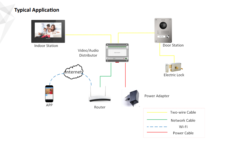

Thank you, but I don't the door is unlocked through the inside unit like you mention. See the attached picture from the document. As you can see, the outdoor unit is directly connected to the door lock.
Apologies for my error.
