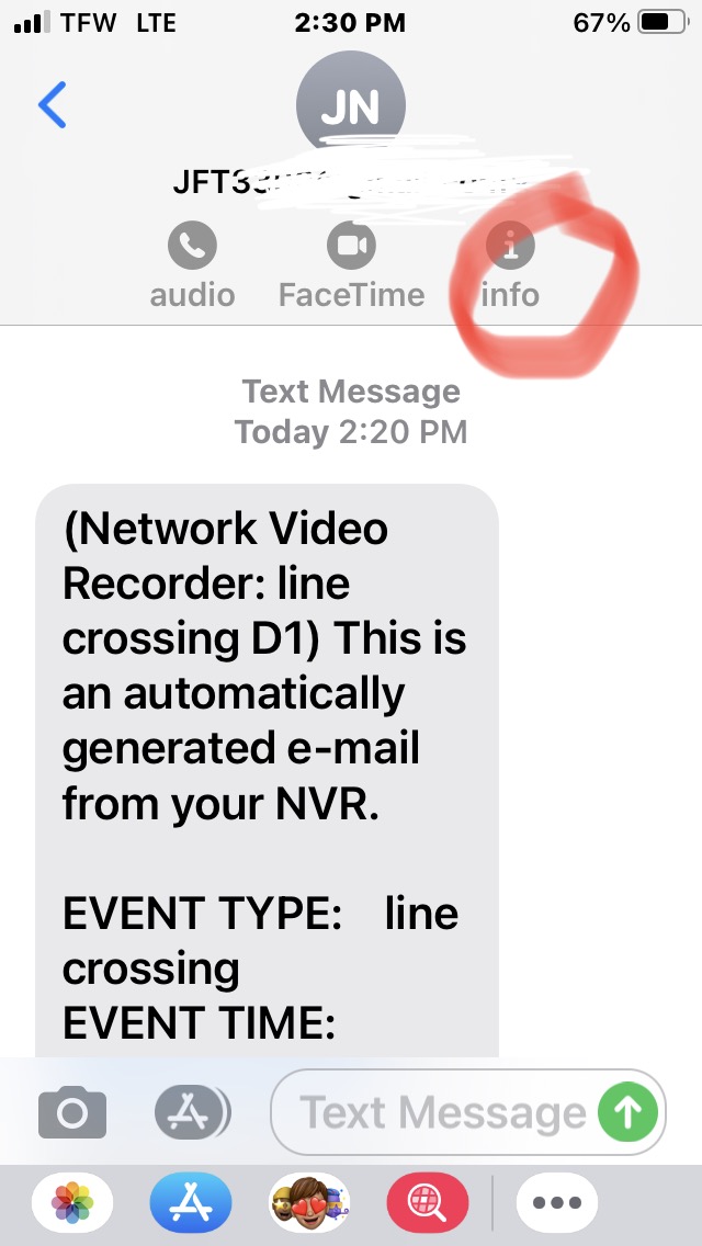

hello i have been experiancing the same issue with no banner, sound on notification. Running latest ios software on apple phone and latest version of hi- connect. have you resolved your issue?

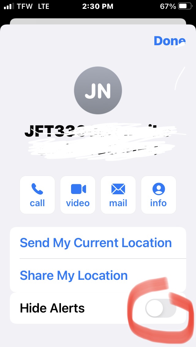

I found my issue when you go into your text message from notification of hike connect app. There is a hide flag. I had it set off. Turned it on and now I receive my banner notices along with sound. I will attach some files
