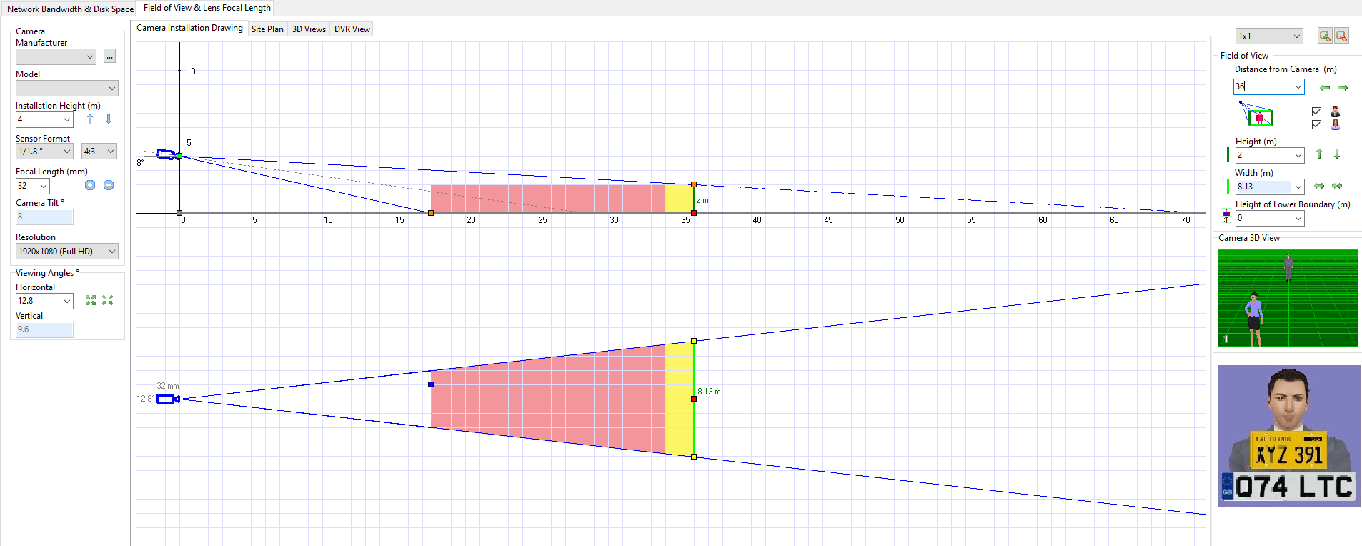

Hi Phil, that's great and thank you.Hikvision's 7A26 ANPR camera with its 32mm focal length option should be OK.
Hikvision DS-2CD7A26G0\/P-IZS 2MP ANPR Varifocal Bullet Network Camera
The 8m scene width at a distance of 36m is a bit wider than ideal, but the cameras function so well that I'm confident it'll be OK.
