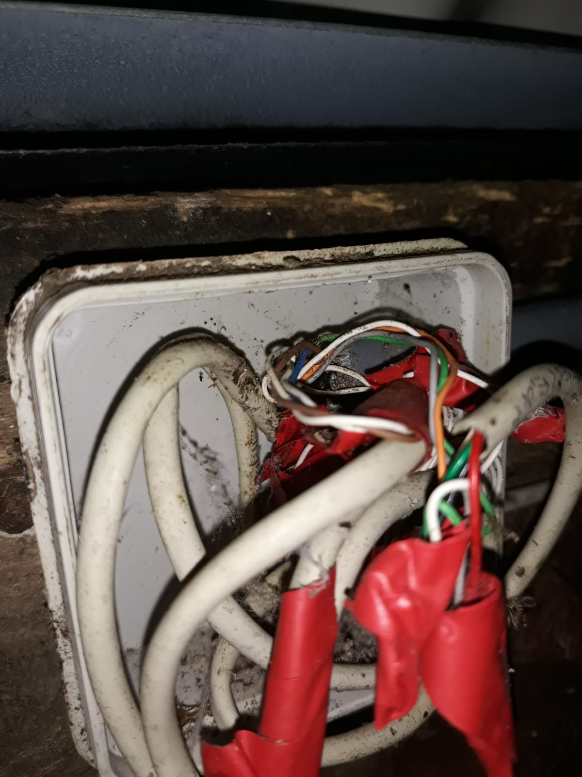

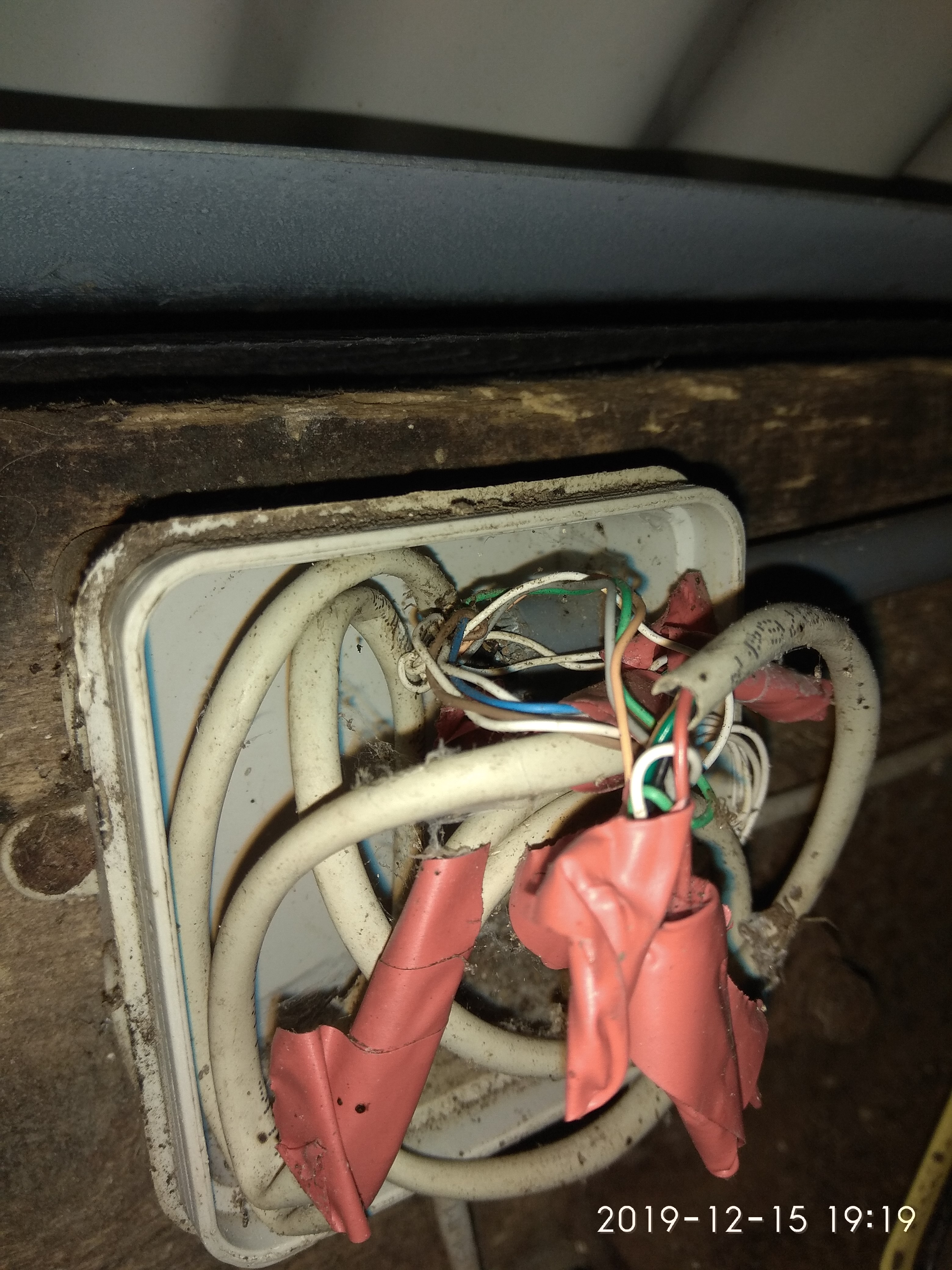

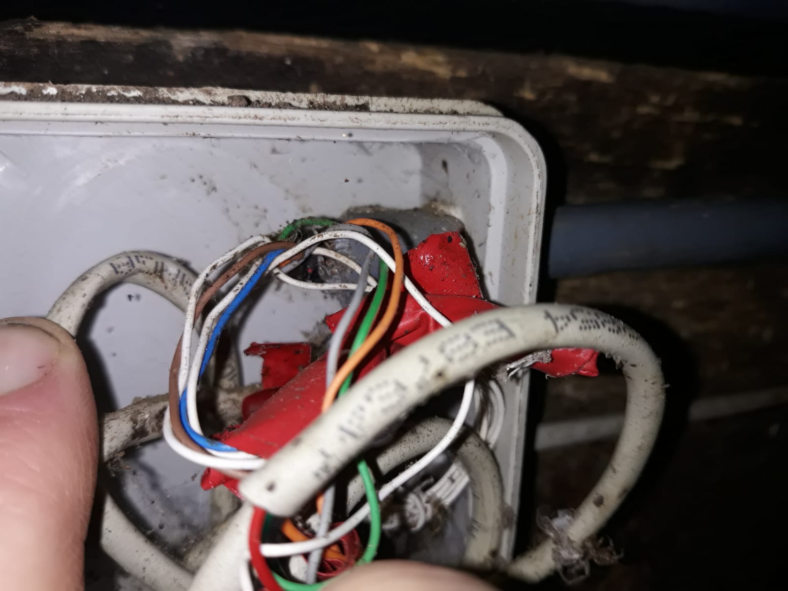

The first question is will the cabling be sufficient for this task? How do I test that it is? See photos attached of the cabling - sorry for the quality, I was up a ladder with animals nearby, albeit there was someone guarding the ladder. Does this look like a usable connection?
IMG-20191215-WA0001[1].jpg IMG-20191215-WA0004[1].jpg IMG_20191215_191907[1].jpg

1) From those pictures, I can't identify if that is standard network cable, most Cat5e or Cat6 cable has pairs of cables (e.g. blue/blue & white striped, orange/orange & white striped, etc...) and I can't see any striped cables in your cable. All we can recommend is that you try terminating the cable and test the connection.

I've had another look at the cable, it was put in about 15 years ago for an old analog cctv system that is no longer in use.
I now believe that the cable between the shed and house is an armoured telephone cable. So, I think this would have 5 pairs. I'm not sure if they are twisted or how tightly are twisted.
Would this cable be good enough or how would you suggest I test it?

If it is not actually network cable, constructed using twisted-pairs of cables, then it’s quite unlikely it’ll work.
Of course, you can try using a cable tester that you will see in the forum post that I linked to in my first reply, you can also try terminating the cable with RJ45 connectors and try connecting something to the cable.
