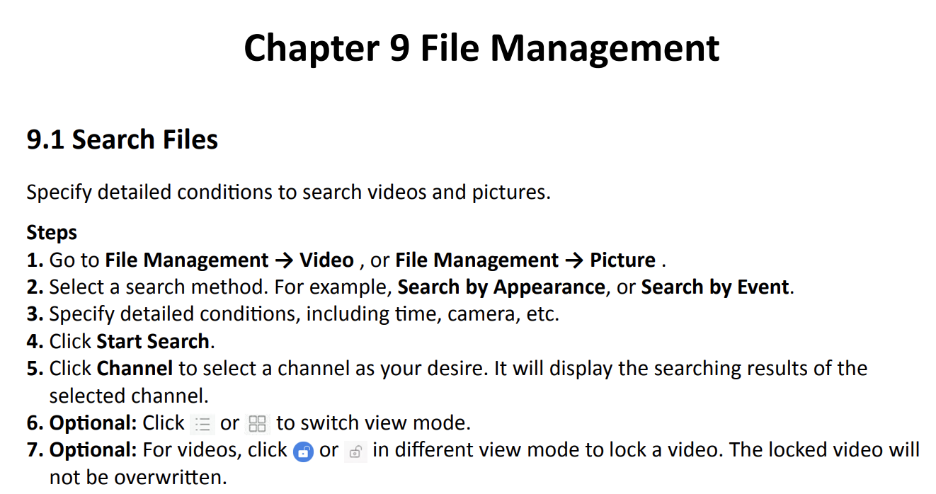

When accessing the NVR with a direct monitor you can go to the File Management menu (folder icon), search for the time frame when your event activity happened (or search by event if you had a smart event set) and then a list of files will be displayed in a table. Find the files that cover the time of your event and click the padlock icon on the far right of the table to lock each file so they won't be overwritten. This is explained below in a bit more detail:

I tried following the instructions and although I put the time parameters to only a 10 second clip, the NVR returned a file at over 50 minutes long with the clip I wanted to lock buried about 15 minutes inside this.
Does anyone know if that is correct as I'm just looking to purely save my video clips that are all under a minute long?

Yes, this is correct because you probably have your storage packet time set to 50 minutes.

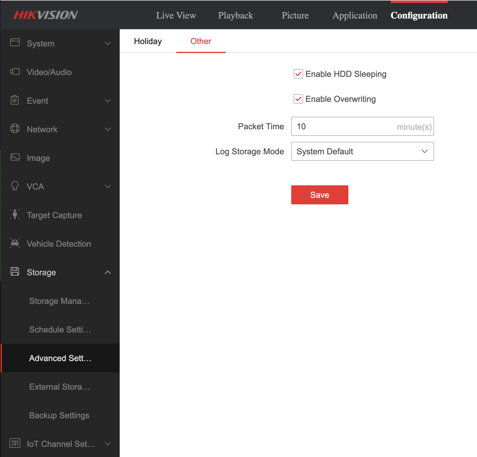

The Hikvision NVRs segment the continuously recorded footage into packets of a set duration, this is so that the HDDs and the NVR software can better manage the footage.
You can adjust the packet time, but as far as I can see (from scanning the direct monitor menus) this setting is only available when logged into the NVR using a browser. (see below)
Also, this setting will only apply to footage recorded after you change it. The packet that your event is inside is locked at that 50-minute duration so you will have to lock that whole 50-minute file if you want to stop that event from being overwritten.

Ive just checked mine and the packet time is empty.
I take it if you set it to a smaller packet time, it won't utilise the full capacity of the hard drive.
I'll maybe have to look at just downloading those clips I want to keep

If the box was empty it will likely have defaulted to 50-60 minute packets.
Packet time does not change how much of the storage capacity is used, it simply changes how the footage is divided. So as you currently have it set 1hr of footage will be packeted into one 50-60minute file, but if you set the packet time to 10 minutes that hour of footage will now be split across 6 files. This means that when you next come to search for a few seconds/minutes of footage you will be presented with 1 or 2 10 minutes files rather than one 50-60minute file.

Thanks @Dan that makes perfect sense.
If lowering it to 10 minutes doesn't cause any issues I'll just do his for the future.
