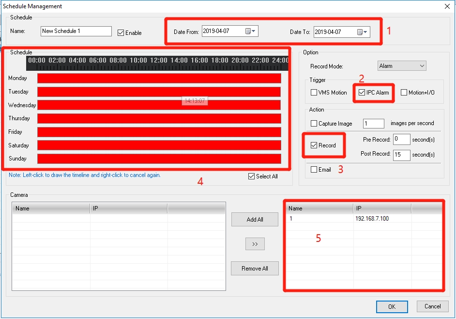

  • Does customer forget to set the schedule date on vms side? plz ask him check again, as below pic shows, there are 5 things should be correctly set.

NO I did not forget to set the schedule on the VMS side - without that I could not set the IPC alarm setting. The schedule is set for always, with all cameras added in 5 in the image above. The only difference is I also capture an image as well.
I do actually notice an issue with your image above - it is only for 1 day (yesterday).
