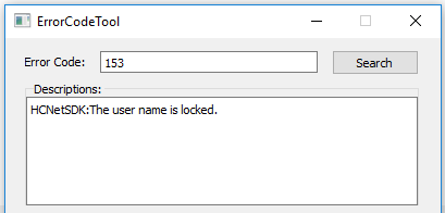

When I use the iVMS client it sees the DRV in Device Management at the bottom. When I try to add I get the following error in a black window on the bottom right corner saying: DVR Logins Failed:Error Code HCNetSDK.dll[153] (The User is Locked). I'm using a VM of Windows XP and iVMS is v2.7.1.4 Build20180403 and DVR is v3.1.10 Build 151211. Login on the DRV is correct as I've logged in many times with the proper PW. Not sure what I'm doing incorrectly. Any help would be appreciated.

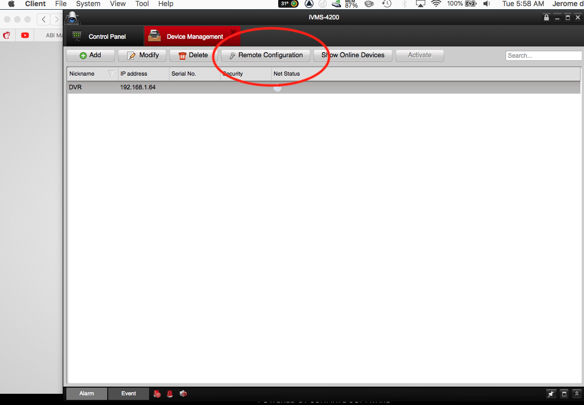

Still the same result. I can see the DVR in iVMS client and SADP Tool on the list, but when I try to do remote configuration I get the DVR Login Failed error.
Jd
As per screen shot. I can change things with SADP Tool, but when I use the iVMS and "Remote Configuration" I get that error. I need the iVMS to see the DVR and associated cameras to view and retrieve video files.
