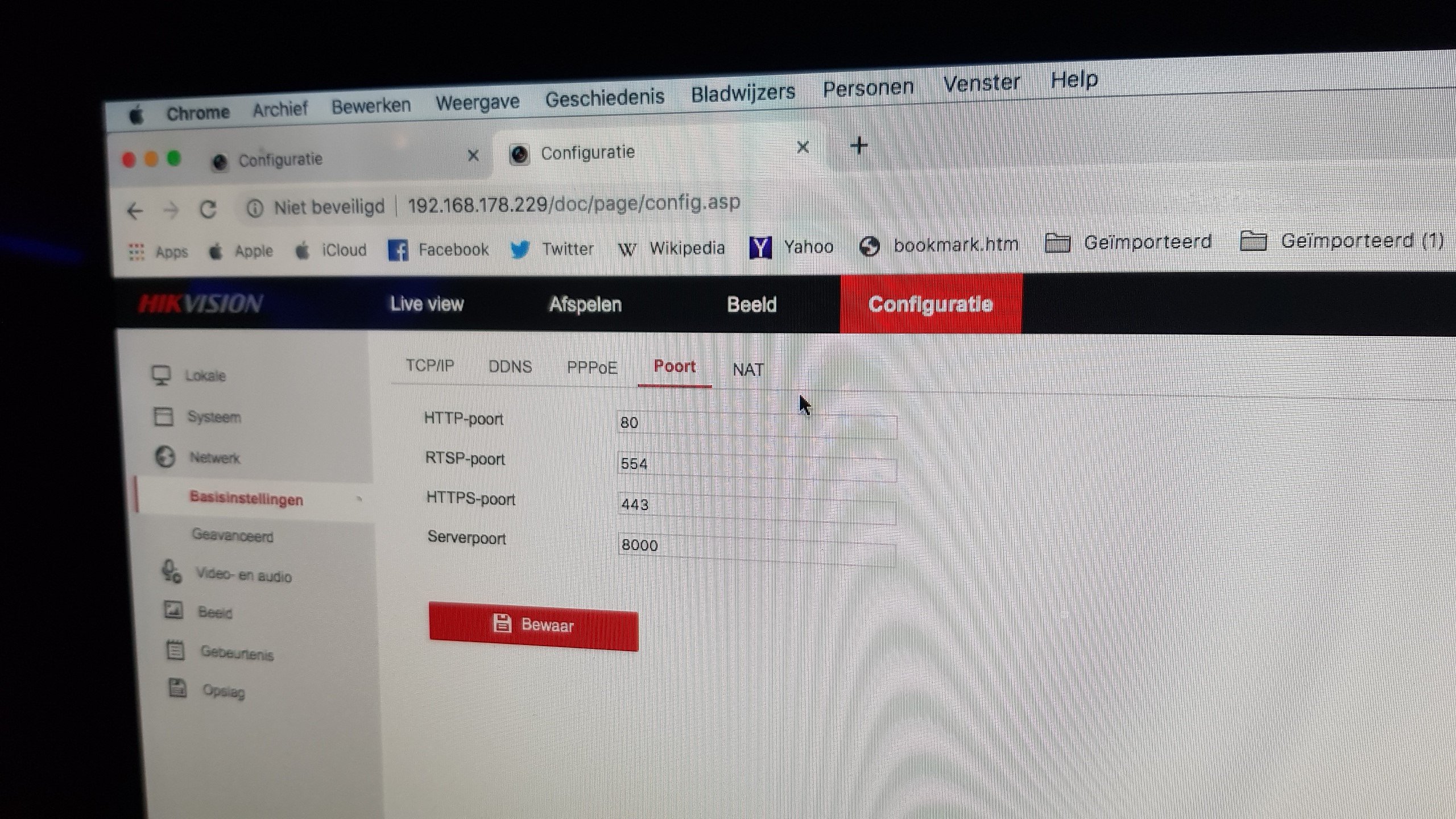

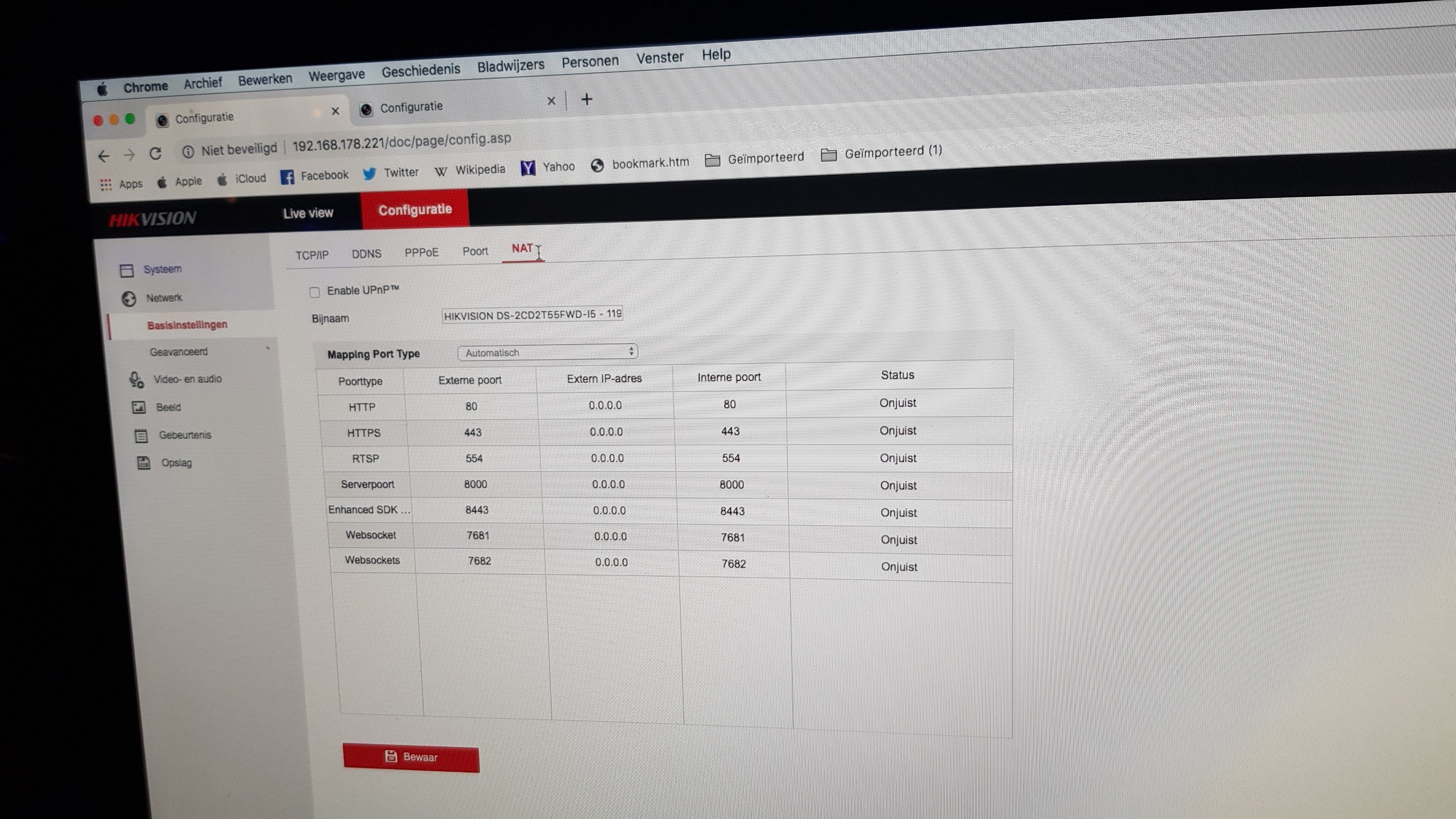

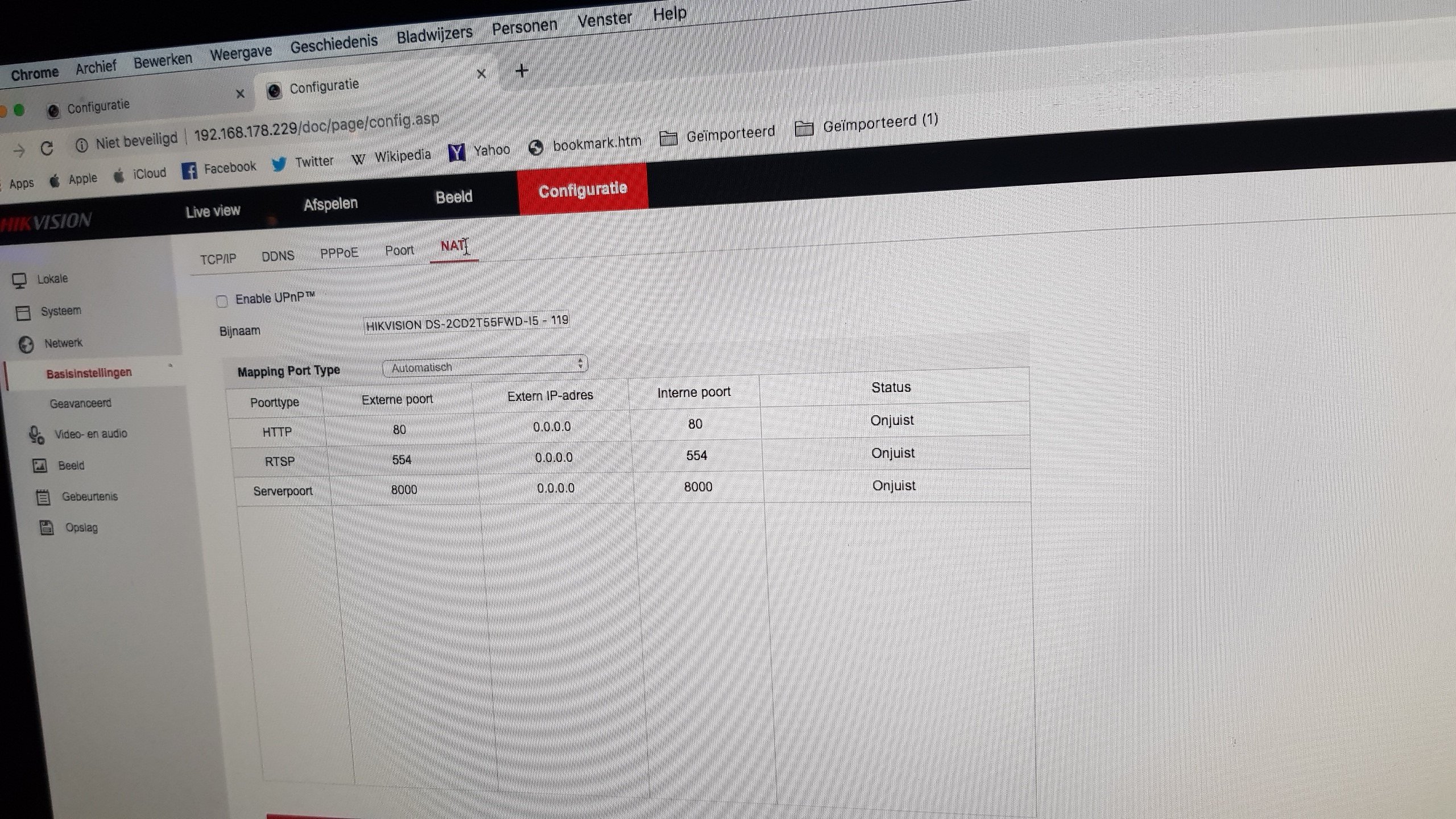

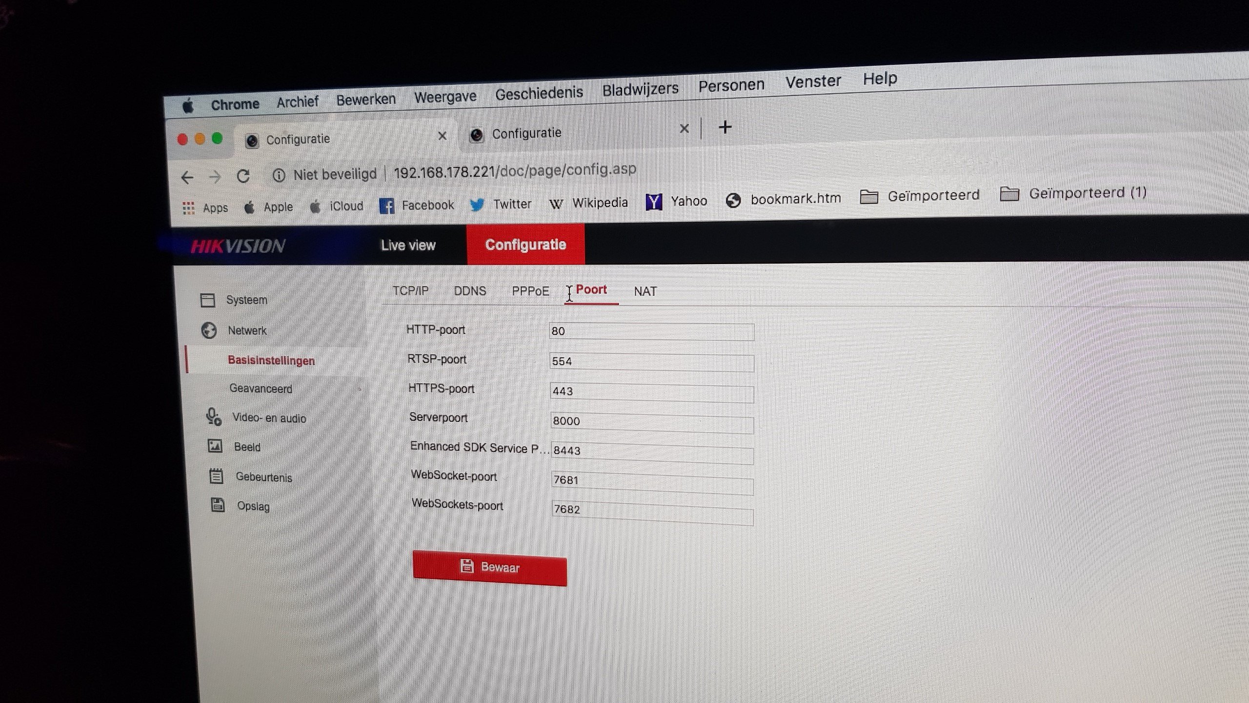

i have the same problem with firmware v5 5.82 build 181211 and v5.5.83 build 190221.
when downgrading the camera (DS-2CD2T55FWD-I5) to firmware version _V5.5.51_Build180314 the error is gone and the camera is working fine again. i see that they added a sdk port and some other changes in the firmware.
with new firmware i have live image in the webbrowser on my mac, on the old firmware no live image.
so it looks like they change some stuff, but i cant point the finger at the problem.
if you look at in the device manager the security status is blank, and netstatus grayed.
camera works on the recorder, hik-connect and webrowser but no on ivms for mac after upgrading firmware to latest version.

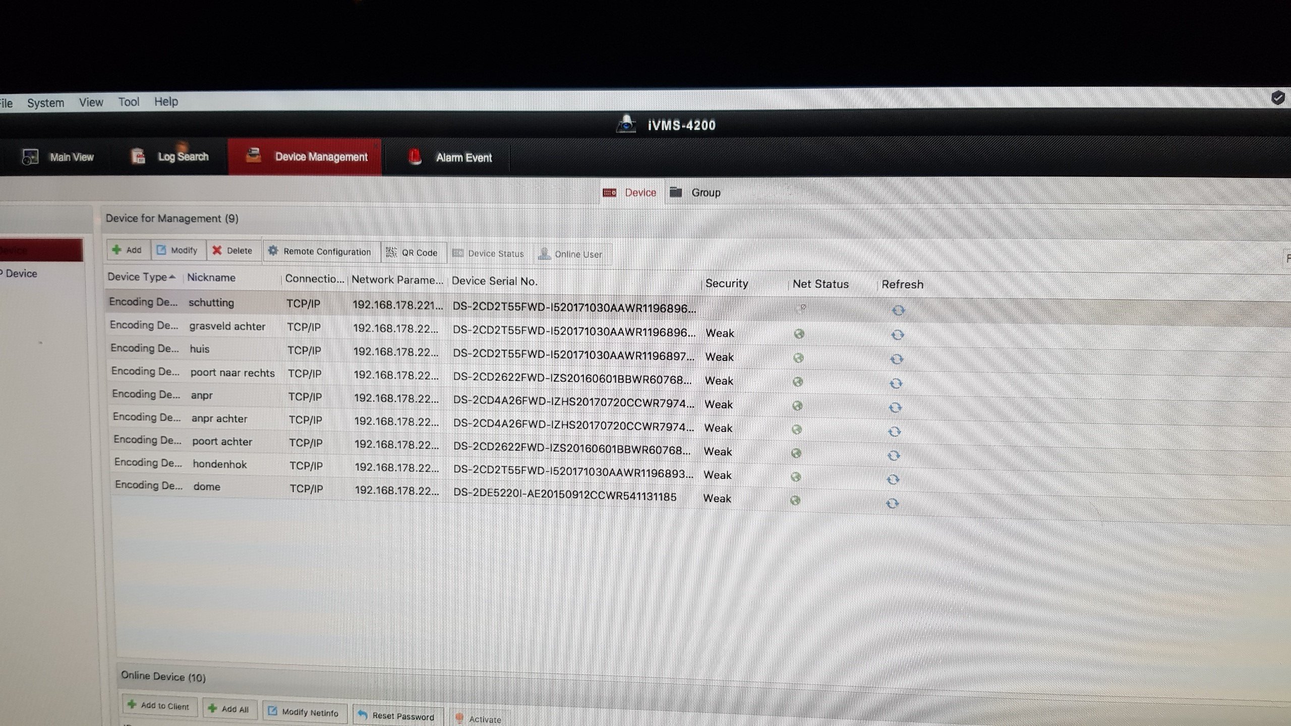

I have a same problem. But starter problem with disconnect every 20sec, I was thing upgrade to latest firmware, but problem not solved. Even one more problem added libHCNetSDK.dylib11.
Hikvision DS-2CD1323G0-I with base firmware 5.5.4, updated V5.5.92 build 190227 and have problem Code error libHCNetSDK.dylib11
my problem was solved to to a factory reset after the firmware upgrade.
the connection to the nvr and ivms4200 works ok now on firmware 5.6.0.
cam model DS-2CD2T55FWD-I5
