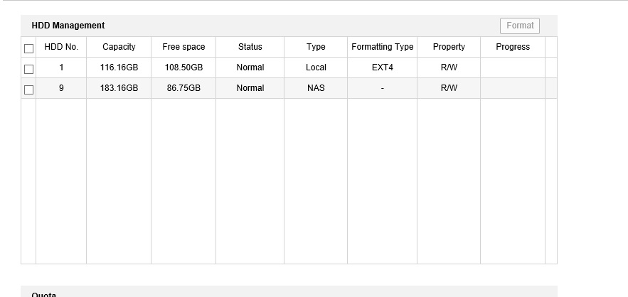

Hello! Use HiLookVision Hikvision App Store Today I updated my G1 camera model DS-2CD2055FWD-I I found that ivms 4500 no longer works with the new firmware version even via wireless in the local network I installed HiLookVision and it works perfectly with remote vpn over the mobile network. For G1 latest firmware version V5.6.6 build 210625 ivms 4500 no longer works and the micro sd card is now ext4 they fixed something in this version my camera on the NAS server via samba does not register on the whole partition it leaves me 88gb free now it works perfectly. your camera is the G1 platform and the latest version for the DS-2CD2355FWD-I is V5.6.6 210625 - 2021-07-20 DOWNLOAD EU PORTAL after updating to this version you need to reset the camera to factory settings to work properly
