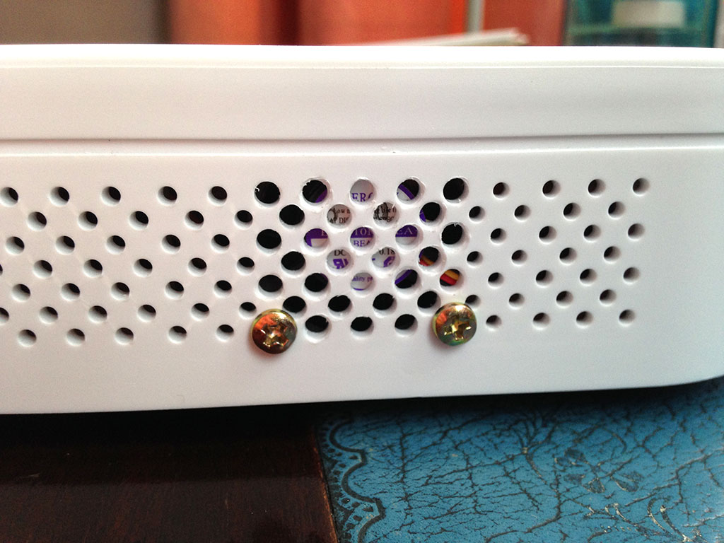

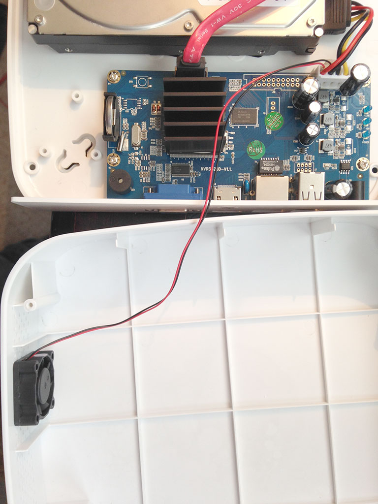

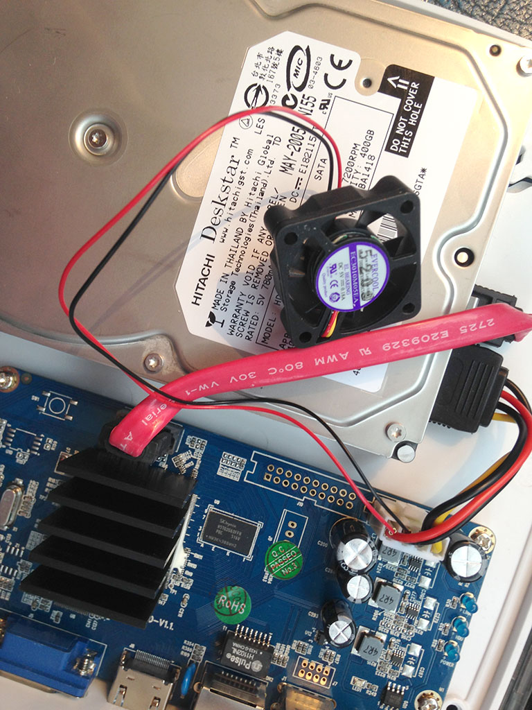

I also have an ZXtech NVR I bought from Domar, I'm happy with it, I use a generic ONVIF camera with it, had it running for over year now, only complaint I have is the fact it gets hot as there is no fan, so I added a small 5v 30x30mm fan myself ;)
did you hard wire it into the NVR board m8, or is the power source external....
I bought a 5v fan and used the SATA power connector, red wire is 5v, yellow 12v, in the last photo you can see where I drilled the holes to make them bigger for more air flow.
nice one m8, so is the fan extracting the hot air within the nvr, or is it bringing in cool air
