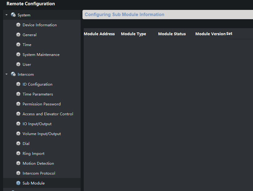

I have to say I watched this video back and forth maybe 3 times already. The problem is that the keypad is not showing up in the iVMS-4200 software. So I also wonder how I can do a firmware update on the keypad ? Maybe I should try a firmware update on the door station ?
The DIP switch is set correctly. When the door station is starting the keypad makes a software-clicking sound when I press the keys, but once the keypad is fully started this stops...
To be clear this is my problem (configuration on door station):

here is an screenshot of mine, make sure ds8003 is uptodate with firmware, but also ivms , mine screenshot looks different :

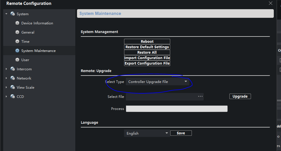

I tried to apply the Security v2 firmware but it doesn't seem to work. Version remains on v2.0.8.
The Upgrade button is greyed-out, trying through use:
not sure what to select for type...

Isn't it grayed out because you didn't select the firmware file? You extracted the zip file , right?
jschelfh
6

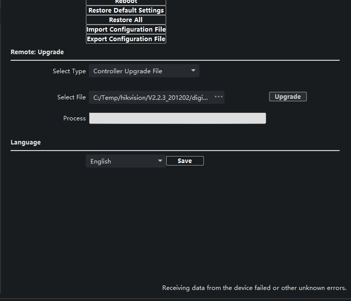

I'm sorry for the confusion, I meant the upgrade-button on the main window is greyed-out. I have unzipped it and selected the "digicap.dav" file. I selected "Controller Upgrade File". Strangely I can upgrade the indoor stations just fine, but for the door station I keep getting:
starting to believe this door station is somehow broken...
