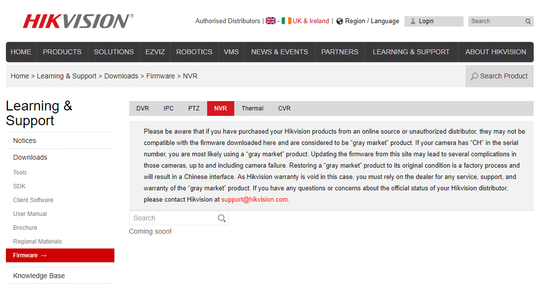

Currently, the Hikvision UK website simply returns a "Coming Soon!" message via this route:

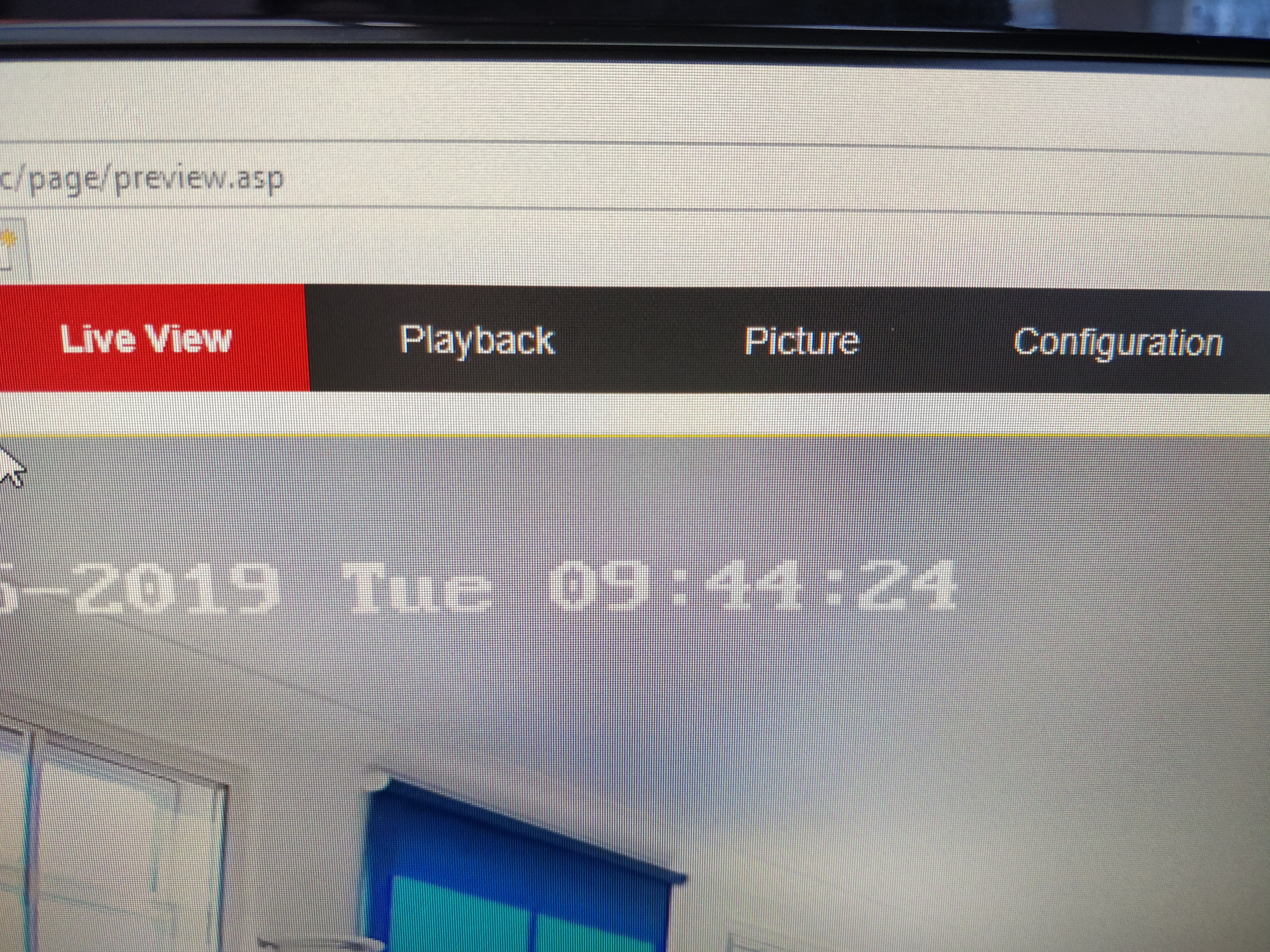

The playback & picture menus should appear whether it is a camera or NVR (see photo below of one of our office cameras when accessed using Internet Explorer), if you are not recording directly to the camera using a MicroSD card then not having this menu isn't a big deal as you should still be able to access your recordings from the other device you are recording to. If you are recording to the camera then the only way you will be able to access your recordings is to use Internet Explorer or setup iVMS-4200 and manage your camera through that software.
The fact that the camera doesn't default to main-stream as it does in Internet Explorer is part of this partial 'no plugin' fix that Hikvision have implemented with the latest firmware, you can now stream your camera via chrome but in getting this to work Hikvision have had to compromise other features of browser access like the playback/picture menus and the ability to default to main-stream. (this is probably because their current 'no plugin solution struggles with the high resolution of the main-stream and so defaults to the sub-stream - we tested an 8MP camera here in the office using Chrome and we couldn't access it's main-stream so it would appear to only work with 5/6MP cameras and below)
