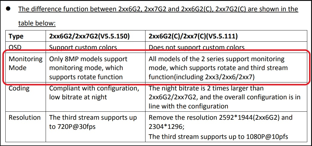

One small piece of information from Hikvision that comparing the functionality and performance of G3 vs G5 cams is shown in the table below.
I can't remember where i found this information. I think it was in one of the firmware release notes.
On paper it looks like the G5 performs better than the equivalent G3. I'm not entirely sure what is meant by "The night bitrate is 2 times larger......"?
Really - I think they explained it very clearly "the overall configuration is in line with the configuration" :confused::D
Hikvisions explanations rarely make make sense. I had several e mails from them the other week following queries/comments I made after a webinar. The responses received didn't answer my questions and I finally just gave up.
I was sure I'd read a comment some months ago on IP Cam Talk regarding these new ColorVu models where the user had indicated that they felt night time picture quality was not as good with more visible noise. I'll reserve judgement until I've tried one - it's the LSU/SL model I'm waiting for with 2 way audio.

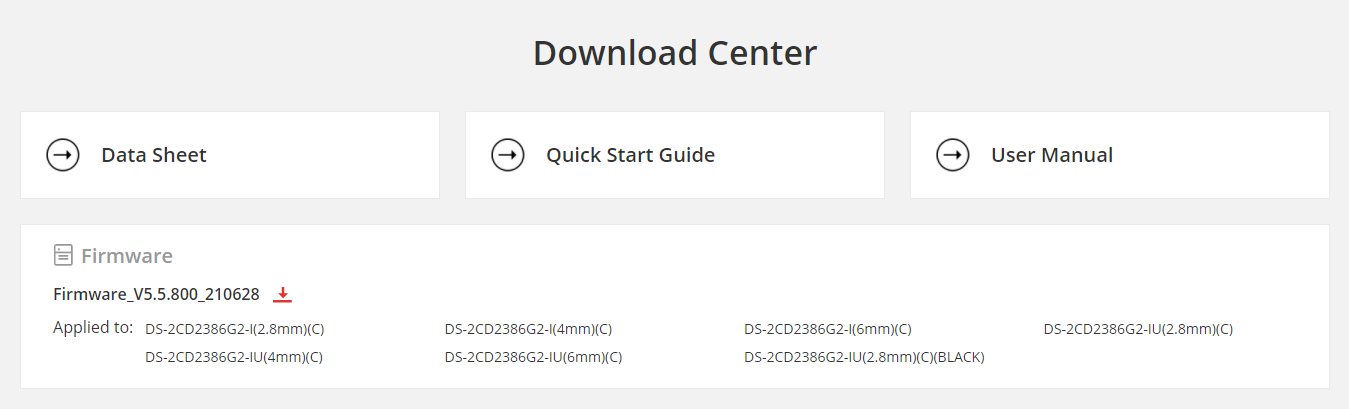

Hikvision has just released a new firmware V5.5.800 dated 28 June 2021 for the 2cd2386G2(C) and other variants based on the G5 platform only.
The new firmware release jumps toV5.5.800 which I assume was done to prevent confusion between the G3 and G5 firmware releases since the G5 platform releases had a lessor numeric designator.
You cannot apply this firmware to the G3 platform cameras since we now know there are significant hardware changes between the G3 and G5 platforms.

We were aware of this firmware listed on the Hikvision website, but strangely this firmware is not available on the download portal and it is rare that new firmware appears on the main website before the portal.
I have asked Hikvision support for release notes and more information about this latest version, I think you are probably right that they have made this big jump in versions just to try and avoid the version numbers of the G3 & G5 firmware getting mixed up.
