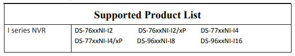

The latest HikVision firmware for their -I series NVRs (V4.1.50) was made available today 26th March 2018, and is available for download at their European Portal:
DOWNLOAD PORTAL
The Release Notes are attached below.
Quite a few changes & updates.
Please see our guide on how to update your HikVision firmware.
NB - V4 is quite different to earlier V3 versions of firmware, please check this thread before upgrading:
New version 4 Firmware for HikVision NVRs
There is no upgrade path for remaining with the V3 user interface.
We would recommend that you use the ML-STD version of the firmware (which includes English; ML = Multi-Language).
It's unclear what the NEU version provides:
HikVision V5.5.2 Firmware - NEU or STD?
At this time there is no update to the -K range NVRs (since 17th October 2017)
