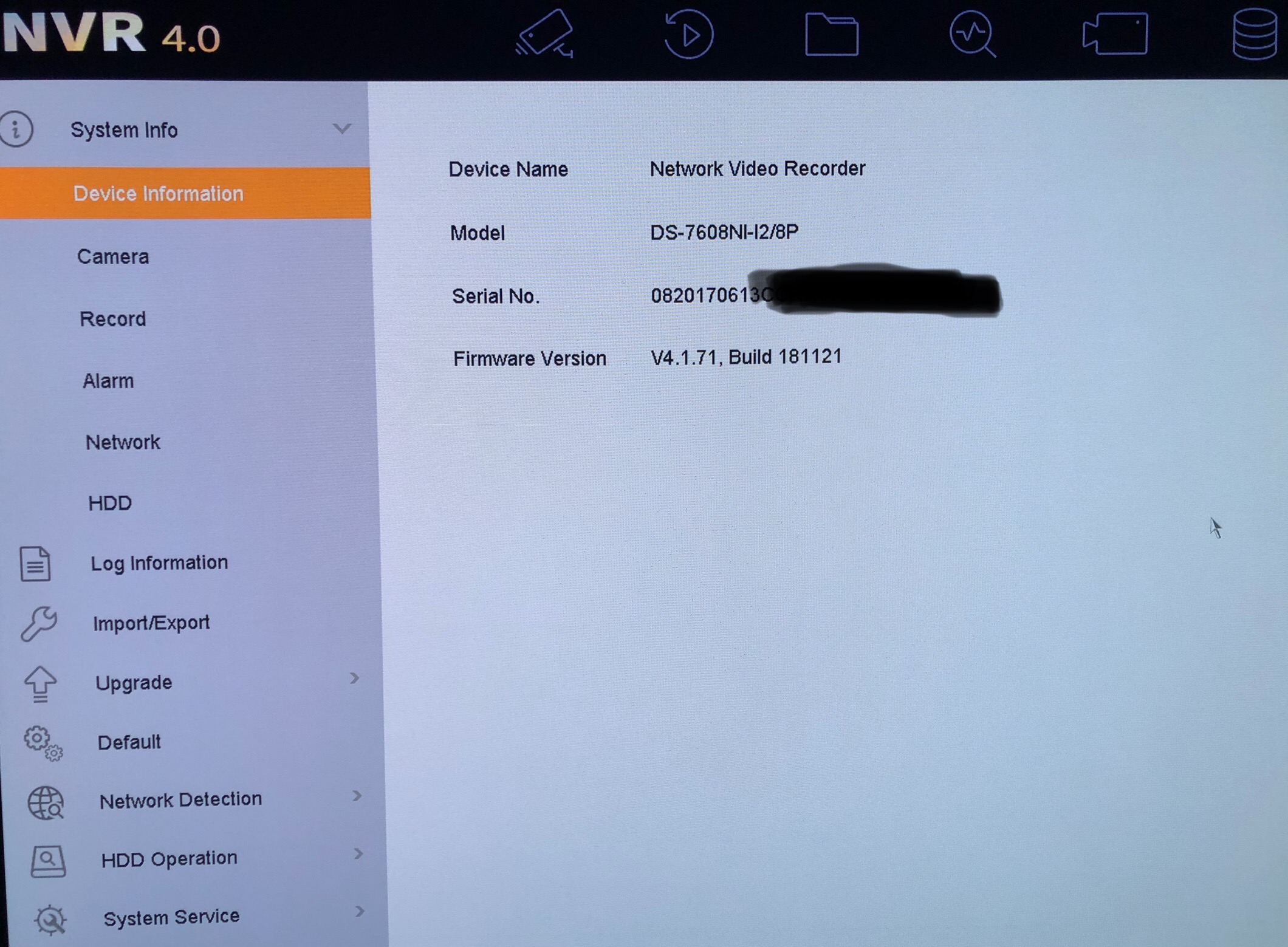

I upgraded this evening to V4.1.71 Build 181121 from the link you posted on the 7th January.

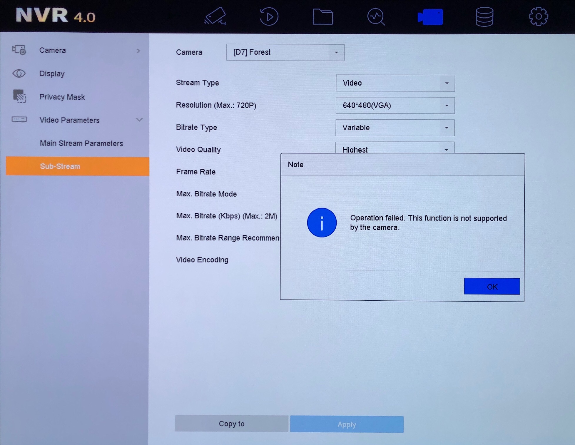

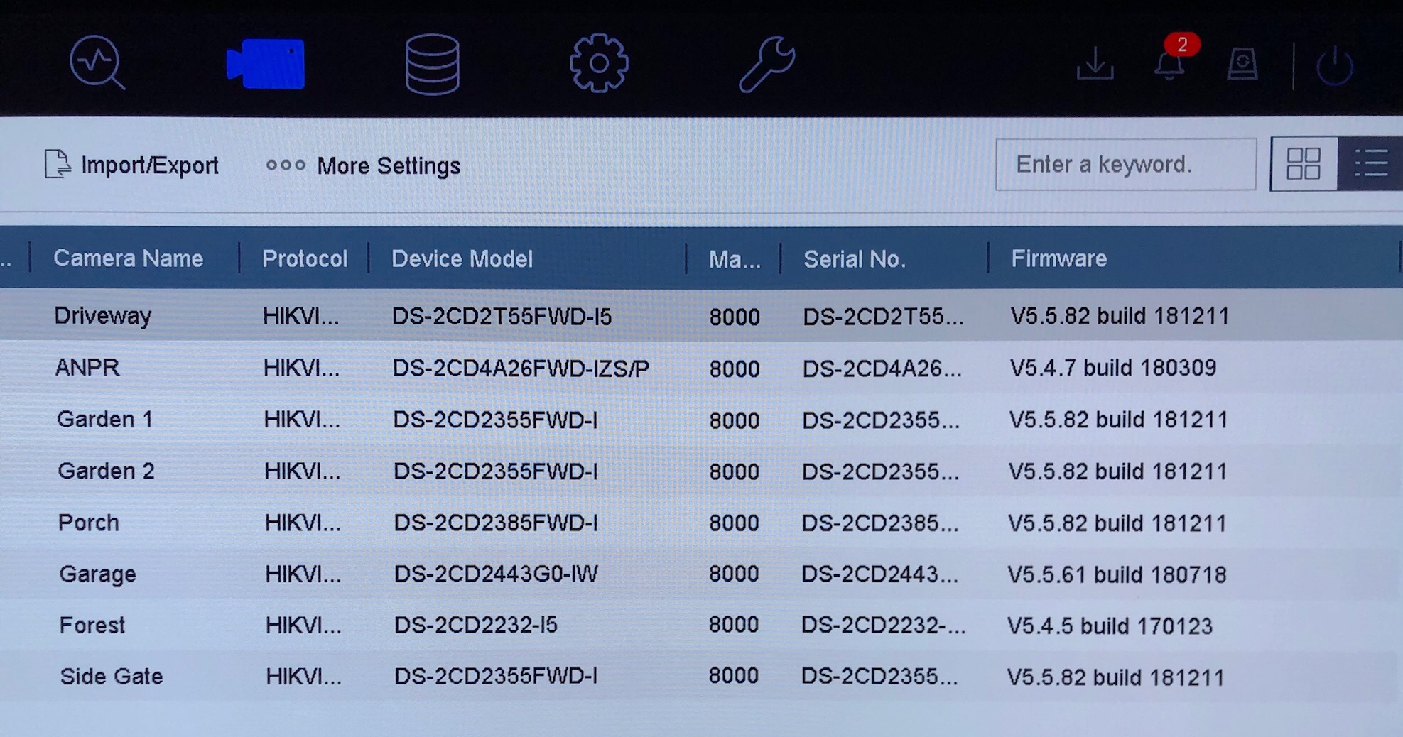

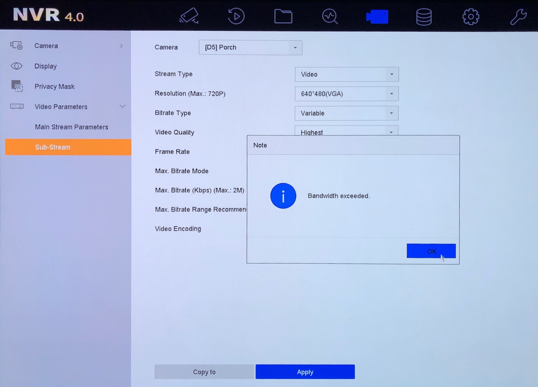

Feedback after a weeks use of V4.1.71 build 181121
1..Smart search is now working again
2.. IPC DS-2CD2385FWD-I substream will not go any higher than 1280 and any attempt to increase is met with a pop up message “Bandwidth Exceeded” (worked ok before update) so have a weeks worth of footage that is unwatchable.
3..IPC DS-2CD2232-I5 mainstream feed only... Substream settings unavailable and pop up message “Operation failed. This function is not supported by the camera” (worked ok before update) if I log into directly to IPC using browser I can select main/sub stream but on iOS device or NVR option fails.
Other than that noticed that the motion sensitivity settings on all G1 cameras has massively increased and dropped down accordingly.
My options are doing a factory reset on IPC cameras that are affected to see if this restores functionality or rollback to the previous firmware on the NVR and loose the “smart search” capabilities?
What do you think?

Substream error update on IPC DS-2CD2232-I5
Have carried out full factory reset on IPC via web browser and restarted NVR and problem still there.
Substream bandwidth error on IPC DS-2CD2385FWD-I
So must conclude that the NVR is the problem? So rolling back NVR Firmware to last known working version..

Have rolled back my DS-7608NI-I2 / 8P to V4.1.63 build190111and substream now working on IPC DS-2CD2232-I5 :)
But still getting "Bandwidth error" on DS-2CD2385FWD-I next step is double check firmware on this camera although it successfully updated my other G1 IPC cameras without any issues using V5.5.82 build 181211?

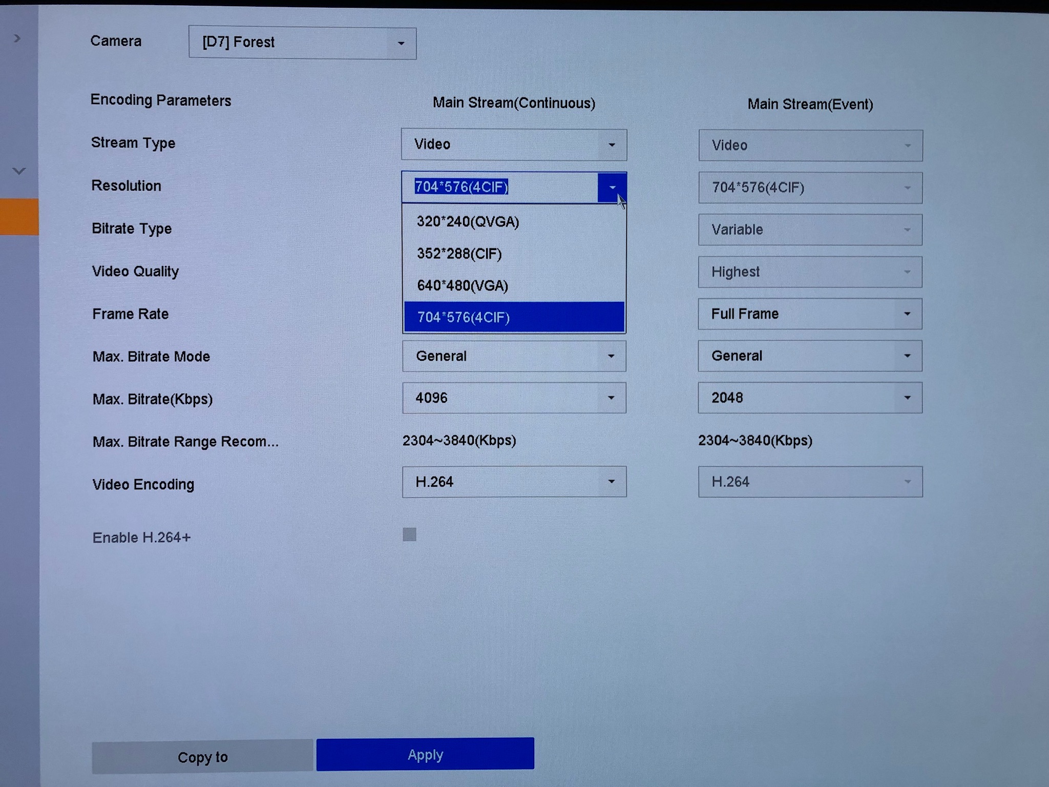

Further update: :(
Managed to get the G1 DS-2CD2385FWD bandwidth error fixed with V4.1.63 build190111 but now the older DS-2CD2232-I5 is now not letting me set the "mainstream channel to anything larger than 704*576 (4cif) on the V4 GUI.
I can select the higher resolutions on the web browser but the NVR can only see the substream on the main video settings.
So after reading through these threads it seems that V4.1.65 is a stable release so I have upgraded to this and still have the issue with the mainstream error on the older 3MP EXIR IPC.
Ps... also tried to setup email notifications and every time I selected test the NVR rebooted :(
I have grown to like the V4 interface but I never had anywhere near the problems or bugs with V3...
So what are my options?
1.. do a complete factory format of the nvr and install the last version of V3
2.. the same as above but with V4.1.65
3.. Revert back to V3 without factory reset
