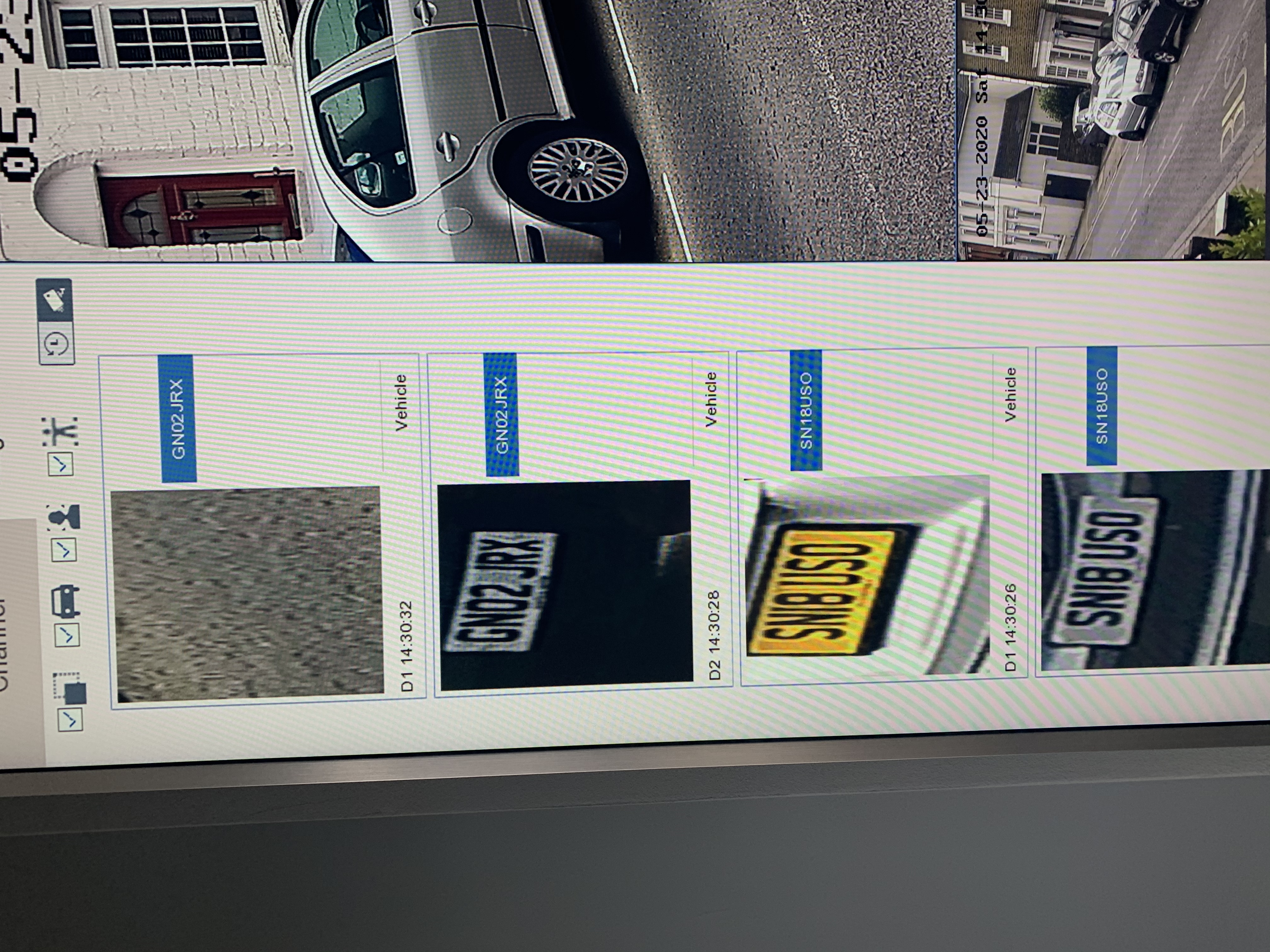

I've wrote some of this elsewhere, it does make your 4 line ANPR camera results a little unstable, ie showing the floor in the preview rather then the plate but it does note the plate number???
And when you use the NVR relays to control things if you have any set to closed/operated as do, (so it alerts me if the power goes off), when you use the new silence feature in HikConnect it opens up the relays and then when you unsilence it does not put them back to the state they were.

And the number plates in the preview are much larger and squished up, as per the photo showing both the new look and clips of the floor or sides of cars. I never had any issues on the previous version of software. Search still works perfectly though.

Thanks fin, I'll wait until they fix the ANPR issue before hitting the upgrade button.
