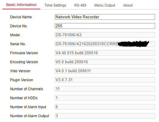

I've just installed it 48 hrs ago directly onto my new second DS-7616NI-K2/P1 - and it's working great. No crashes etc. As it is a new unit, I did a factory reset and camera import after upg.
For me, even though I only use it via the web interface, I immediately see 2 advantages
1) I can use Edge(v2) or Chrome browsers directly - and the playback is liquid smooth with no CPU overhead, even on main stream live view of 11 cams
2) Cameras which are occasionally disconnected remain in the list on the live preview. - This prevents the "Live View Shuffle" as it inserts blank video squares rather than moving later camera views into them. (I have some remote solar powered wifi cams which can go offline)

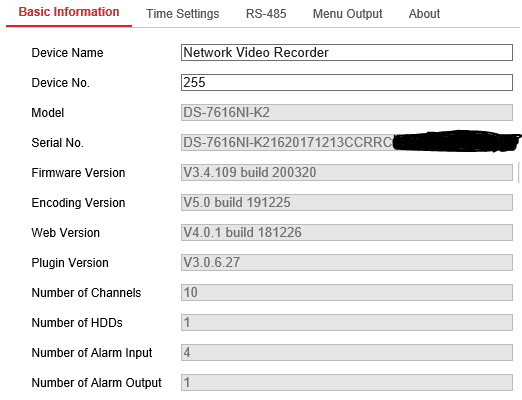

For those interested in the details of the build differences, here are the info pages from both - one running V4.40.015 and the other V3.4.109
I'll be running split firmware versions for the next month, to assess v4.40's long term stability on the DS-7616NI-K2/P1, and then upg the other one after that.

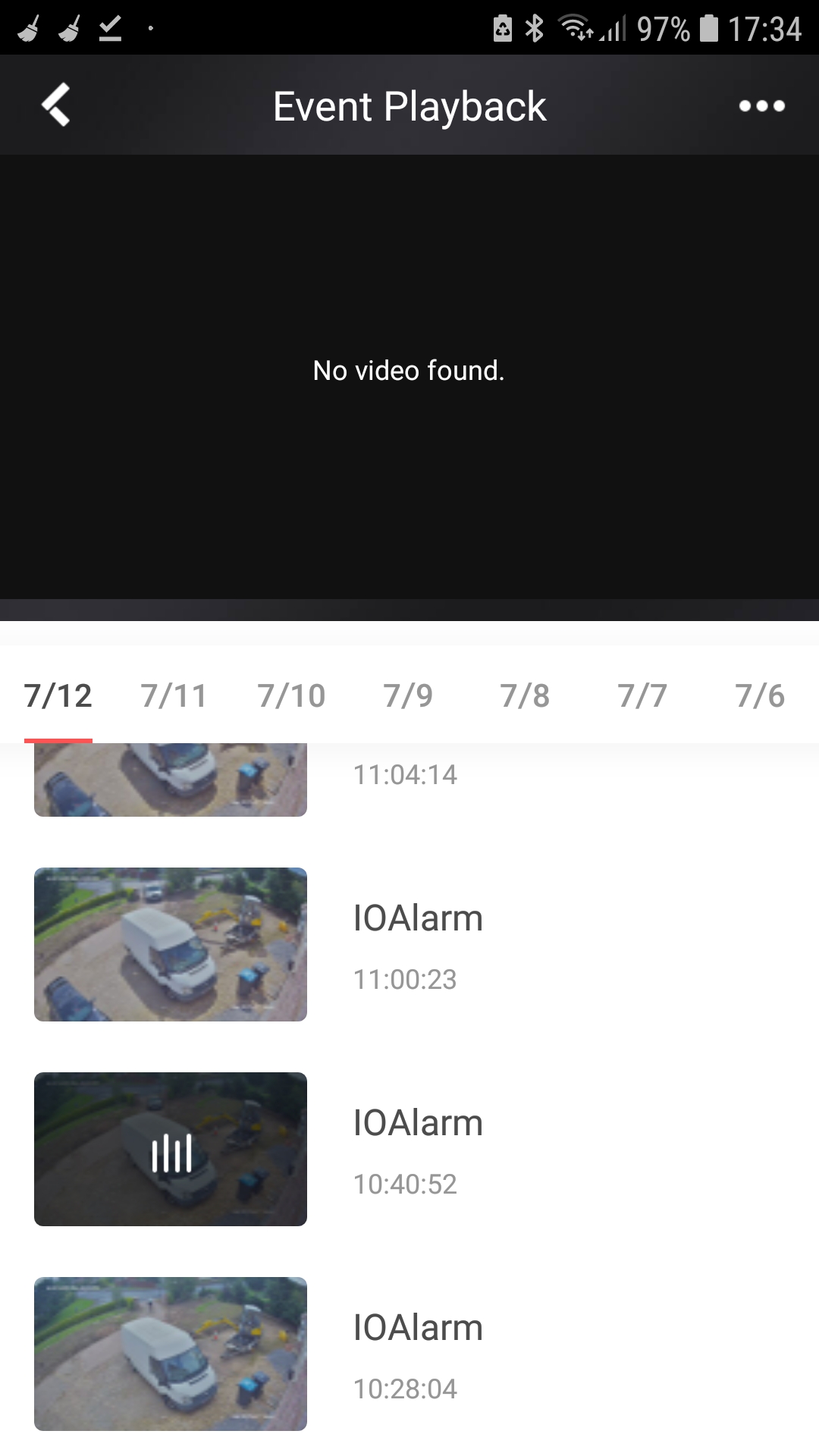

With this version & using hik connect app for Android, I'm still unable to playback alarm notifications from the playback button in the notification window.
Also when playing back from the time line using hik connect app the the recorded alarm events are not shown and skipped, even though they are in the middle of a motion event..
It's like nothing was recorded during the alarm input event.
Luckily video is reorded but I'm only able to view via locally connected monitor...
This is a major problem for me, but I'm guessing not so many people use the alarm input triggers on the NVR?
Works fine for me. Do you have the latest hikconnect app?
In playback it doesnt show itself on the timeline bar. But under it you can view events, it will sort events date wise for that camera.

Yes using latest version of hik connect app v4.5.0.0609
Under the timeline I can view the IO events & thumbnails, but they won't play, it just says no video found.

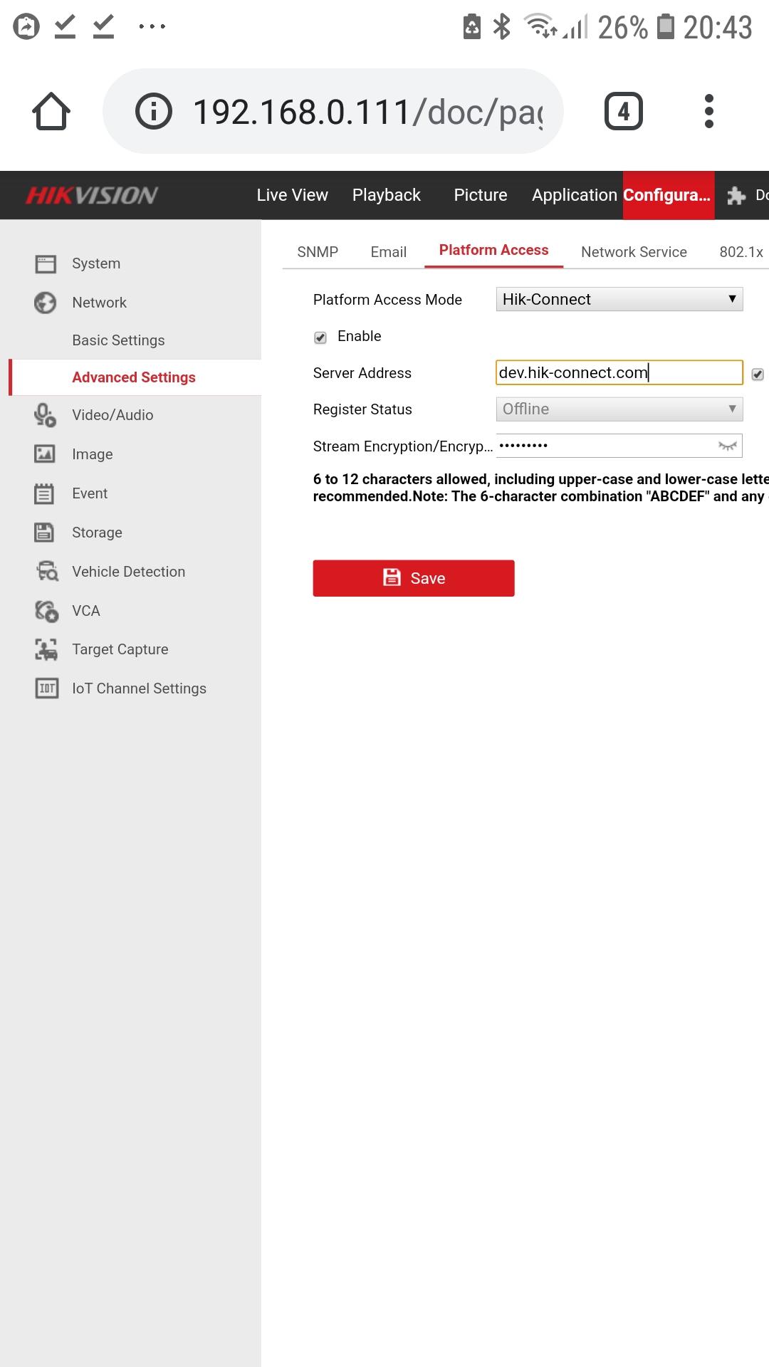

I think I can see where the problem is
If I login to
https://www.hik-connect.com/ via browser, my IP address is not being updated my my NVR.
If I login to my NVR configuration using a browser, under Network>advanced settings>platform access Register Status it shows "Offline"
I think the server address has changed during the last firmware update.
under Platform access Server Address I have
"dev.hik-connect.com"
it did have something else which I can't remember now which also didn't work
What is everyone else using for server address?
View attachment 4024 View attachment 4025

litedev.sgp.hik-connect.com
Thanks, I tried "litedev.sgp.hik-connect.com"
But my NVR changed it to "litedev.eu.hik-connect.com"...
Anyway it works and my IP address updates within the hik connect cloud now.
Unfortunately the alarm input notifications are still not playable from the hik connect app.
