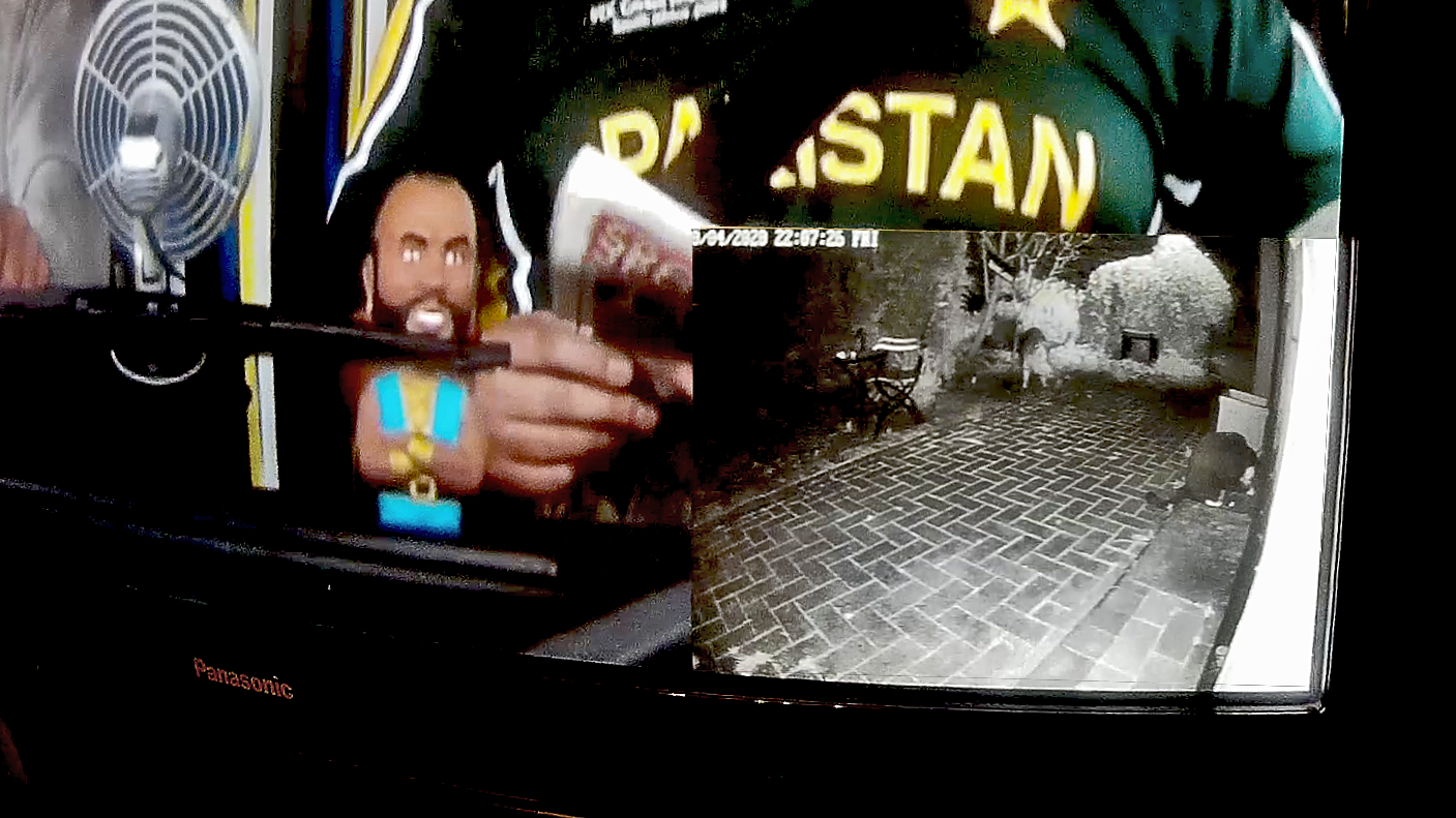

If you're watching regular TV channels and don't want to keep switching channel or AV input in order to see your CCTV feed, a TV which supports PIP [Picture-in-Picture] will let you keep an eye on your CCTV feed in a corner of the screen, which can be useful when you're expecting a visitor or need to know when the cat is waiting to be let in. You still need a source - I split the HDMI feed from my Nvidia TV box while leaving my VMS software client running on it and because my old TV has scart inputs, I use an HDMI->Scart adapter to deliver my PIP. (It's also possible to use PIP while watching channels from your set-top TV box, according to this Youtube video.)
