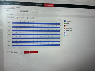

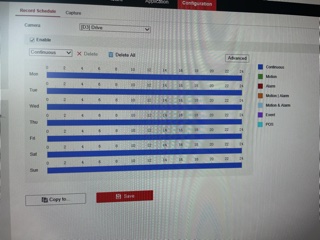

Are all the cameras set to record continuously? (please share a screenshot of your record schedule settings)

All the cameras are set to record 24/7
