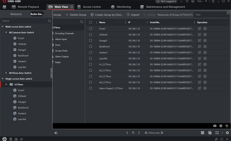

I've been running with iVMS-4200 for some years without issues. I recently fired up the app and no images appeared in either Main View or Remote Playback.
I spent some hours trying to find what had changed, but I could not resolve it. I decided to uninstall all and reinstalled the latest version 3.1.1.6_E.
To my dismay and after setting everything up (old saved config files don't work with this version), I have the same result.
I am running Win 10 64 bit and am up to date with all MS updates.
I can see a current still image from the cameras in Maintenance and Management (Camera edit) and bytes are being sent and received. I have configured for Sub Stream.
I can download the mp4 files from the Remote Playback section, even though I can't watch them in the app.
The screen seems slow to refresh and sometimes I can see web pages through the app or the previous screen of the app in the Main View section.
(See image)
Anyone any ideas?

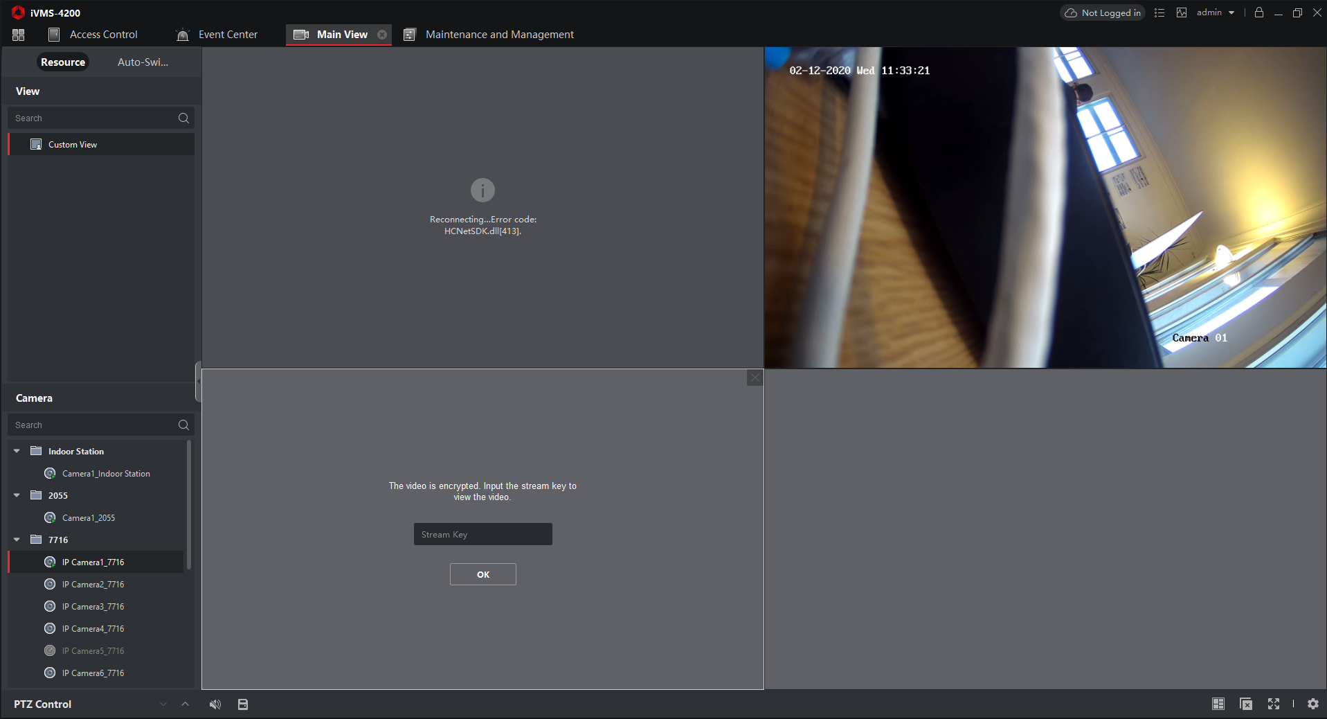

Our initial thought was that this would be an encryption issue with the camera, but the version of iVMS-4200 that you have installed should give a prompt for a stream key if this was the case like below:
This isn't an issue that we've seen before on the program, we're running the same version of the software as you and haven't seen any of these issues. Sorry I can't be of more help, hopefully someone else here might have experienced something similar before. If not you might need to enquire with whoever it was you purchased the equipment with.
