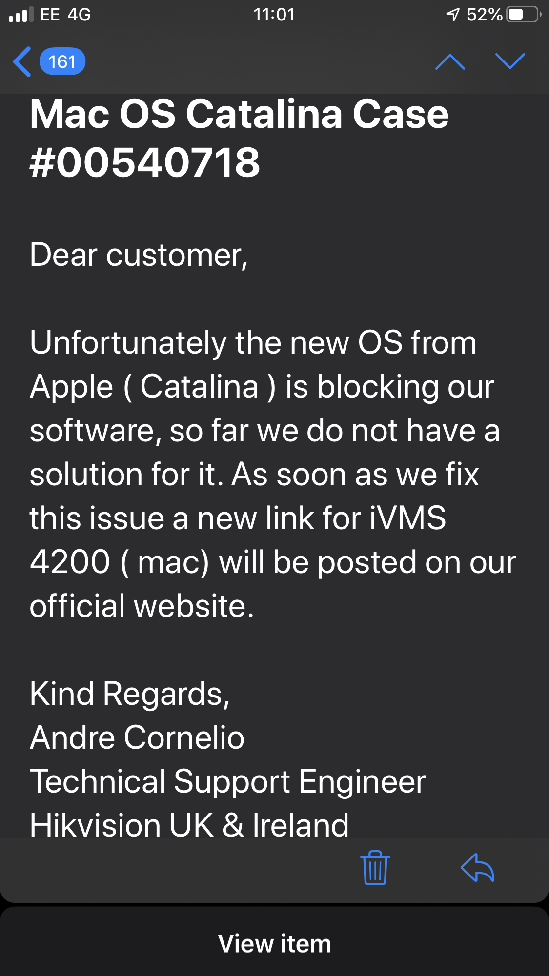

I got this yesterday, 16/1/20 from Hikvision UK&I tech support:
Dear customer,
Please note that iVMS 4200 does not work on Mac Catalina OS, since they updated to this OS, our software does not work properly anymore, also Safari or any other browser do not support the plugins needed to run the system via browser. The only accepted browser is Internet Explorer 11.
If you are the end user we suggest you to get in touch with your seller/installer for any further information.
What he thinks a seller / installer may be able to do when the system manufacturer can't help is crazy!
My system still records but having to buy a PC in order to use IE11 to monitor the feeds on the network is a joke.

Thanks for the reply.

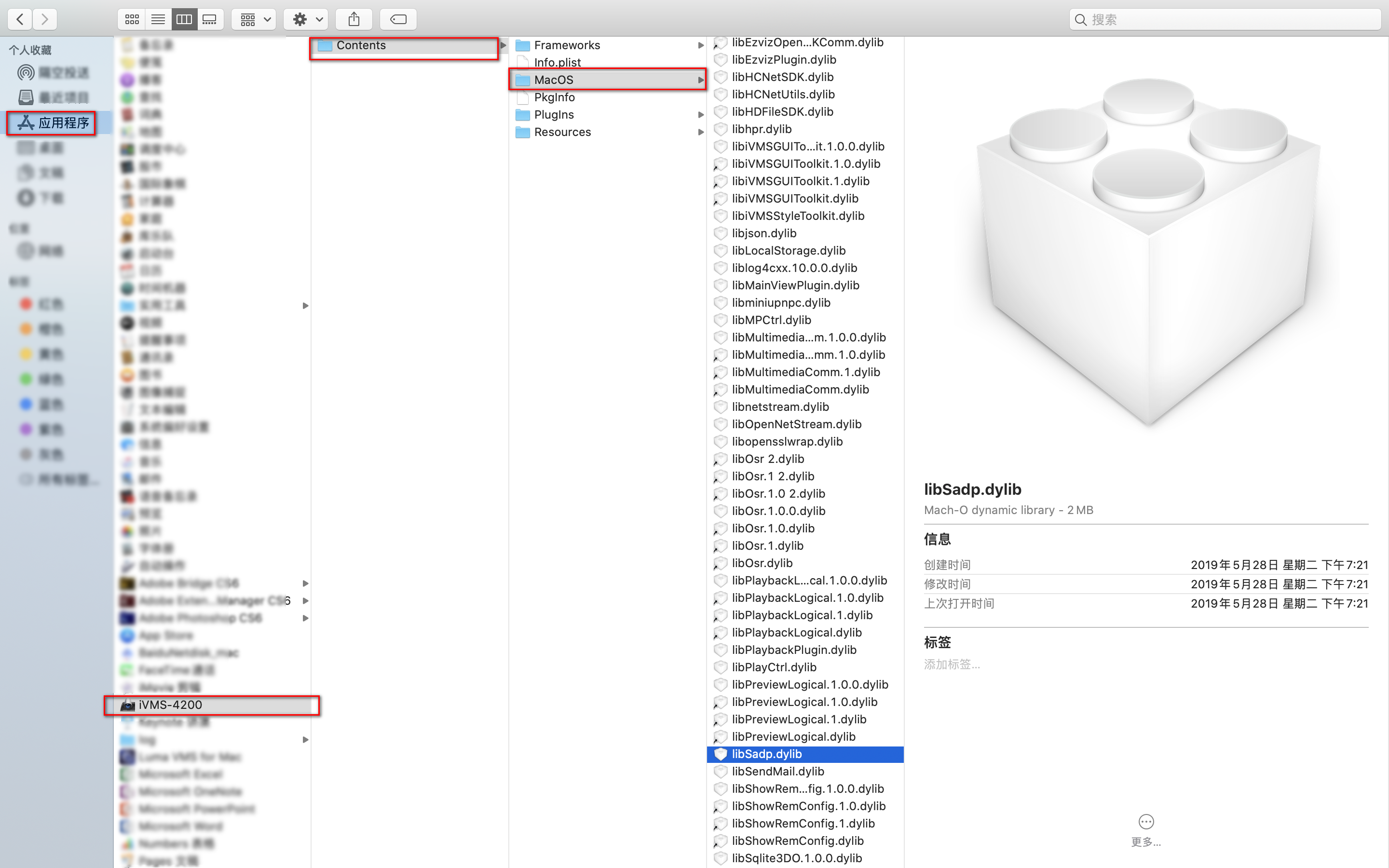

I've since seen a fix on another forum but was reluctant to download anything unknown. I contacted Hikvision HQ direct and they sent me this fix with instructions.
Their UK&I support still hasn't mentioned it. They are still blaming Apple and telling me there is nothing they can do.
The fix they sent me is attached with instructions:
Dear customer,
Sorry for the inconvenience.
Please try to do as following steps:
1. Please decompress the file attached, which named "libSadp.dylib".
2. Put the extracted file in the 4200 installation root directory(as picture attached), and replace the original file.
3.Running 4200 again.
I've tried it and now the iVMS4200 is working fine for me.
Hopefully it helps others.
If anyone is wary of downloading from here, mail support@hikvision.com and ask "Your customer service centre has directed me to email you at this address for a file that will allow IVMS-4200 to work on MacOS 10.15."

Hi Dan.
Thanks for your info and advice.
As a precaution I don't delete the old file, rather rename it before putting in the replacement. That way there is always a 'rollback' option if needed.
I've run the iVMS now all morning and it seems to work just fine. All the functions I've tried work OK.
I'll update if there are problems but for now we're good to go.
Hopefully Hikvision get their act into gear and get Chrome/Firefox/Safari working too.
